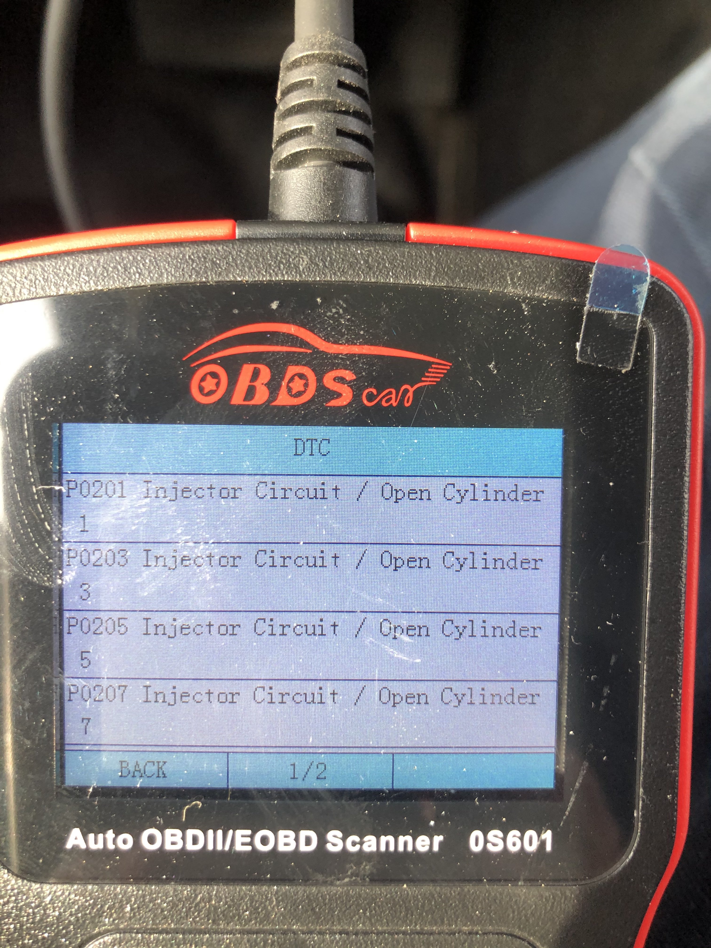

Ok update, dealership says it’s two injectors and the engine needs to be torn down to fix.
No evap code. Like Empire came up with.
No problem with the catalytic converter.
But Chevy won’t touch it with after market parts, so no it’s a rough run Wednesday to Empire at 8 am for a quick pull of clutch and other parts, they’re gonna put a stock belt so I can drive it back and hopefully get it worked on.
Then once it's all fixed back to empire to reinstall parts.
2.5 hours times two! Probably $300-$500 for the Empire I would guess.
But the engine problems are under drivetrain warranty!
Wow. And I thought my service managers were dicks! When Chevy 2015 shit the bed in 2017, the dealership I finally found (thanks to Chris Adkins!), actually said they would work on it with every thing installed, as long as I disabled the Pro. (battery cables off, clutch disconnected). Ended up with them replacing the computer, underhood fuse box. They got it back to running, and the code came back on after 2 days. Turned out the problems damaged the cats, which are in the Y pipe. They replaced that, all was good. (Plugs and wires were on me because they were so cooked). They also did some Pro hose rerouting. Grand total was $429 for the plugs and wires. I'll bet they had $7-10,000 in warranty work, which GM covered. Oh, and after they refilled cooling system, they tested the radiator, and blew it out. They replaced that under warranty because they broke it in the shop.

Dropped it off here 12/30
Hes had it three weeks without even quoting me a price on anything.
And he tore the engine up and it's fine.
The number one injector was getting 12 volts way to hot.
Over a week ago. Was supposed to get a harness in Thursday and let me know if it was fixed.
My 570 has been a work horse but with 14 inch of lift under load the engine is starting to bog a little.
I'm going in tomorrow and seeing financially were I stand and if I'm towing it to empire and leaving it to be repoed I'm done with this shit.
I owe 2 more.years to the bank.
And its.cost $750 to have it sit at the place getting fixed.
I can provably make one van work for awhile if my 570 doesn't take a shit too.
I'm just super pissed and dont see a happy ending with this shit.
