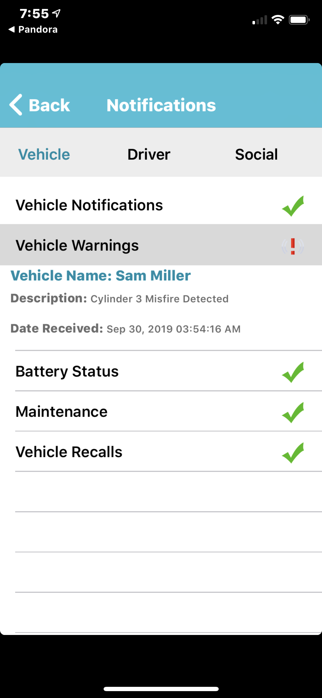

Originally it was cylinder #5 misfire now it’s #3 misfire
That’s the code my Vyncs gps device came up with
