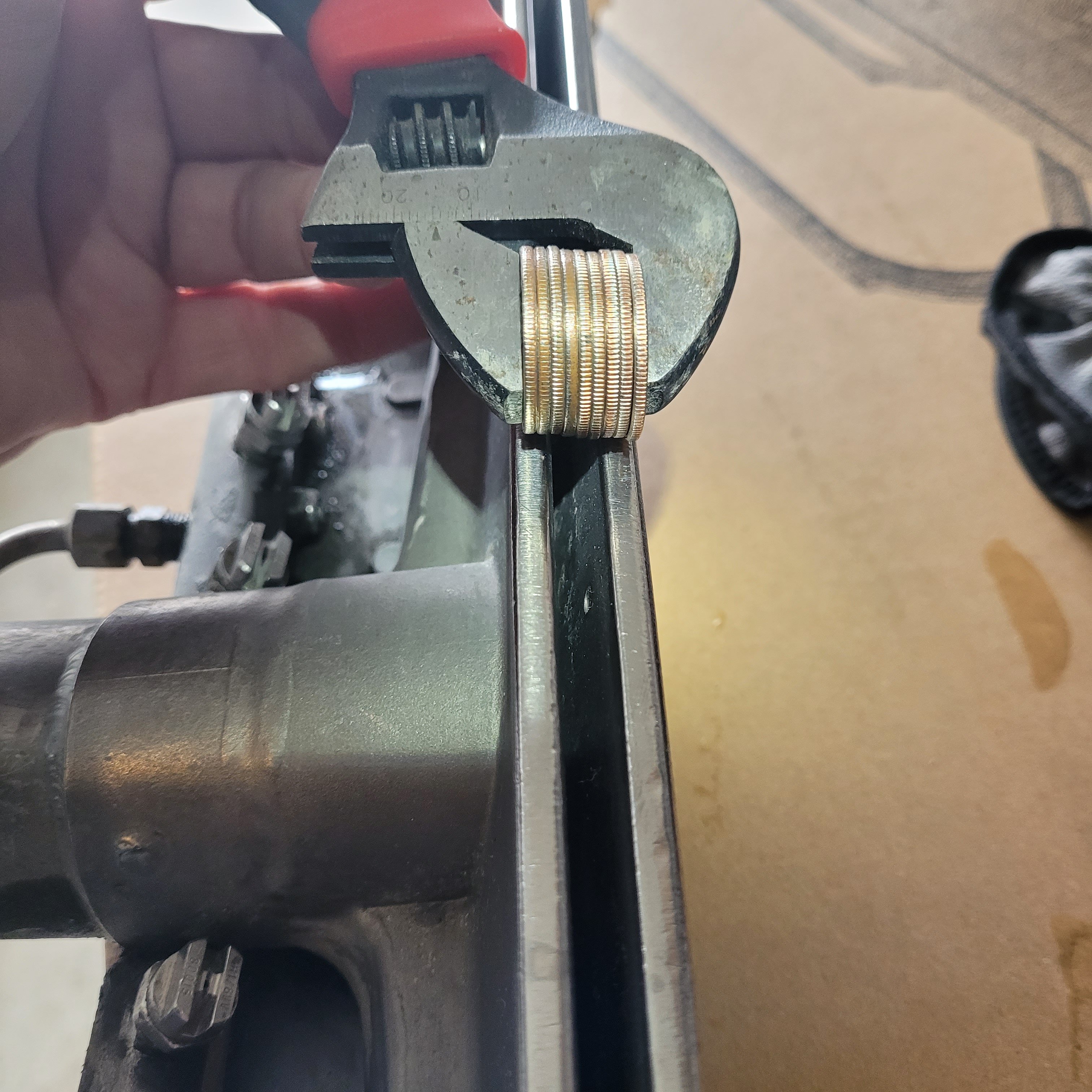

Most likely, it was a worn out round Glide.
To my knowledge, there has never been a flat option for the PCTI

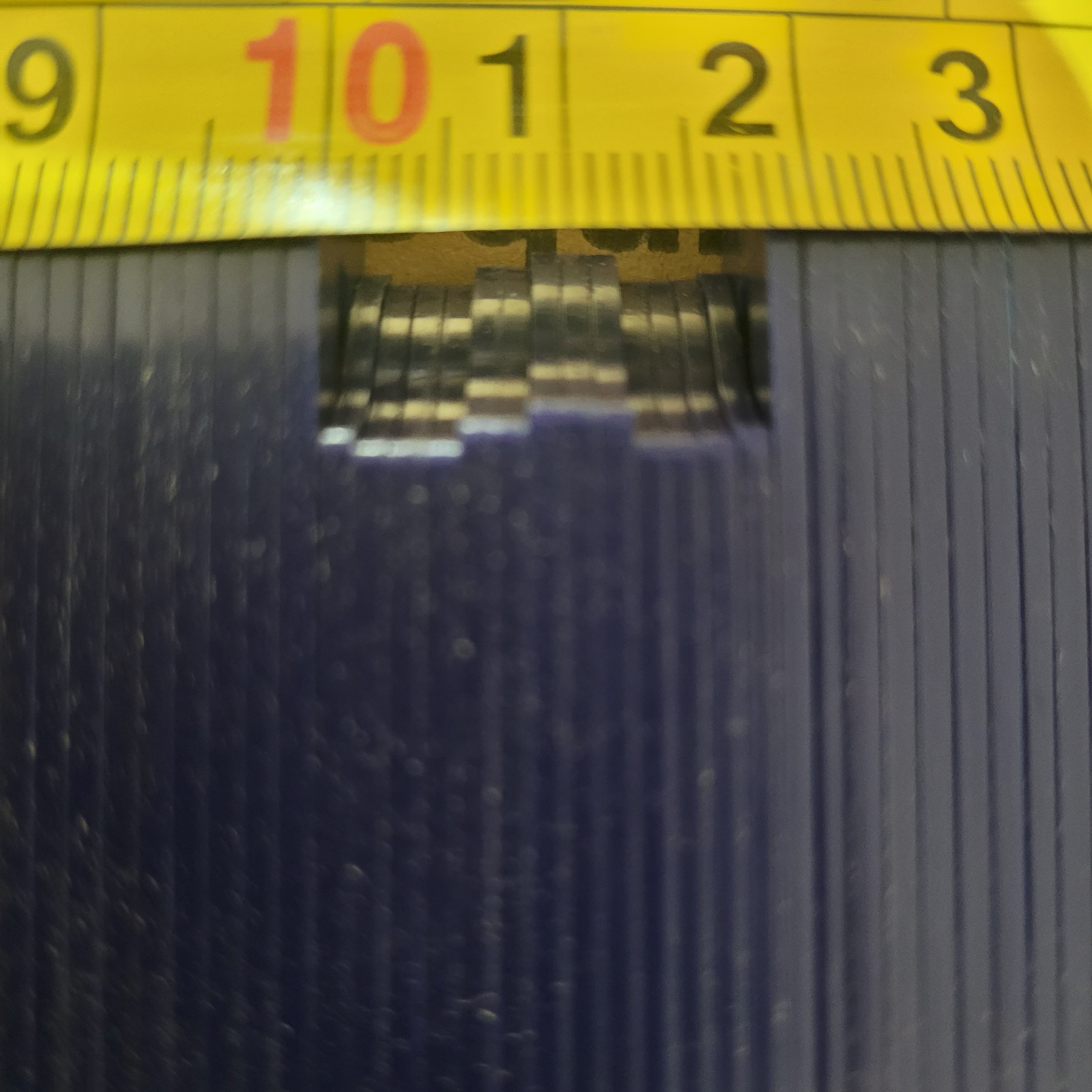

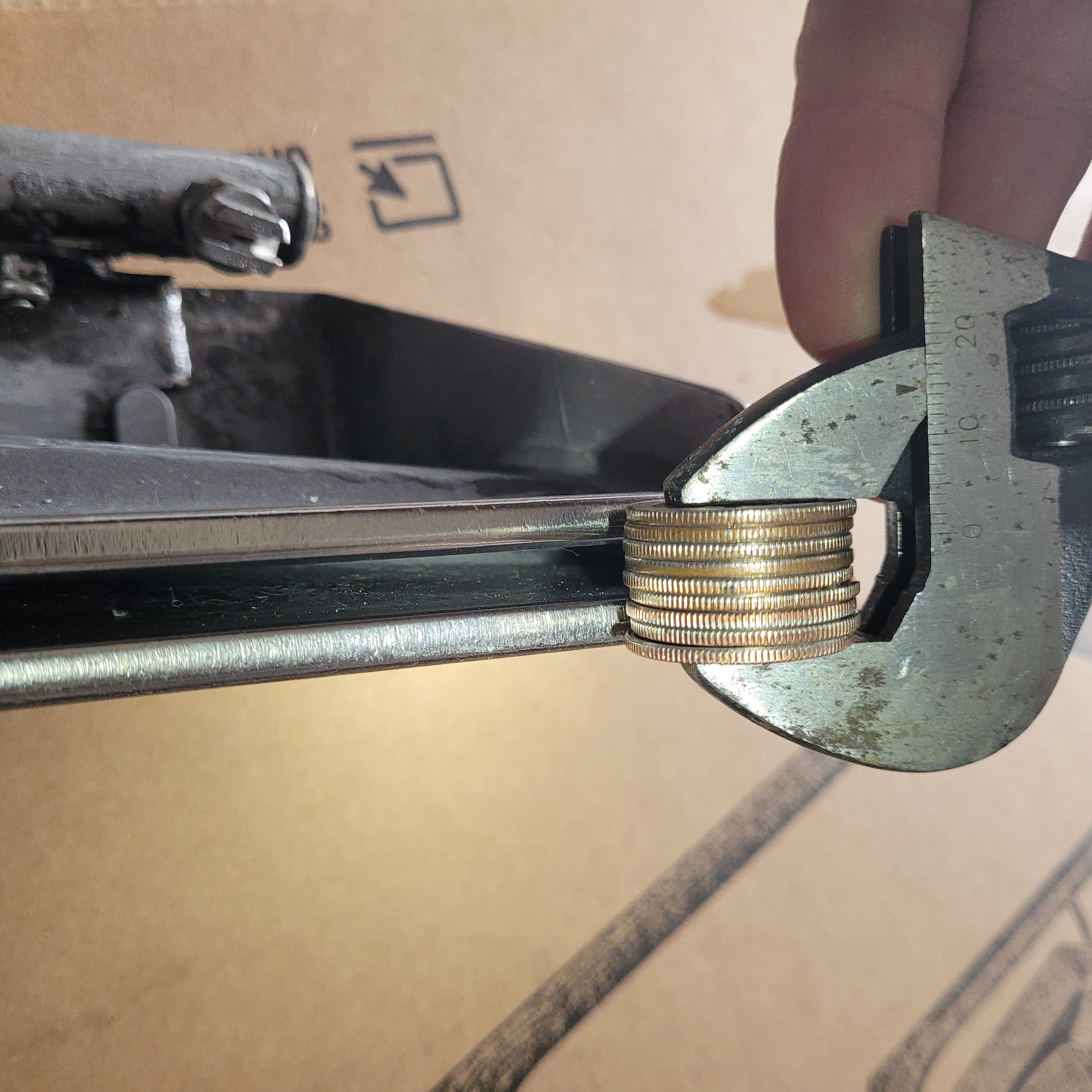

I've saved this relic( the glide); I'll dig it out and snap a pick. I went on the Green glides website and checked your videos.
I figured that nine quarters measure precisely 15 mm. My slot( outside to outside ) measures 17.5 mm, except in the center, where the mouth is slightly wider, 17.7 mm.
I'm ready to order one regardless of the outcome.
Should I return to the website and order one for a 13.5-inch wand? Mine is a six-jet.
Thanks

So, glide has arrived; it's well built, more so on the heavy side, but it seems indestructible. I've checked the competitor's glides; I couldn't find any similarly built glides to make a comparison. Green Glide is a keeper. Installation was simple; I opted for a heat gun use, which was the right decision; after just a few minutes of warming it, I could gently push the glide onto the vacuum slot of the wand. I didn't have the luxury to seal it, but I used it anyway. The air leak was apparent but minor, with no whistling noise. The carpet was barely damp when I was done( only two rooms) and was dry to the touch in less than an hour while I was cleaning the upholstery. I must seal it tomorrow to give it 24 hours of cure time. Fit is snug but with millimeters of wiggle room between the lips and the inside of the glide. Nothing major to be worried about. I gave a detailed description of the whole process for a
" stupid" TI wand, and I'd have to order glide for a 12-inch wand with a 1.5" tube with a titanium head and pistol grip. I'll snap a picture of the wand, and maybe someone will be able to identify it.
Also need to order Sharpshooter ( 13 inches) and glide for it; I believe there are different versions of the glides that fit this particular wand.
I have Aramsco, Jon-Don, and Magic Wand nearby, but with the ongoing crisis in the supply stream, they are thin on inventory. Maybe someone can give me advice on where to get Sharpshooter now. Your help is greatly appreciated.
P.S. I got the slotted version, but those openings will not be enough to grab debris from the restaurant's CGD.

If it actually wiggles you need the undersized option.
Because its a sand casted head the shaped of the lips vary tremendously, hence the slight gaps.
Sealing it will worsen your dry times, lets it leak, it aides in lift.
Sharpshooter Glide - https://greenglides.com/product/sharpshooter-13-glide/
