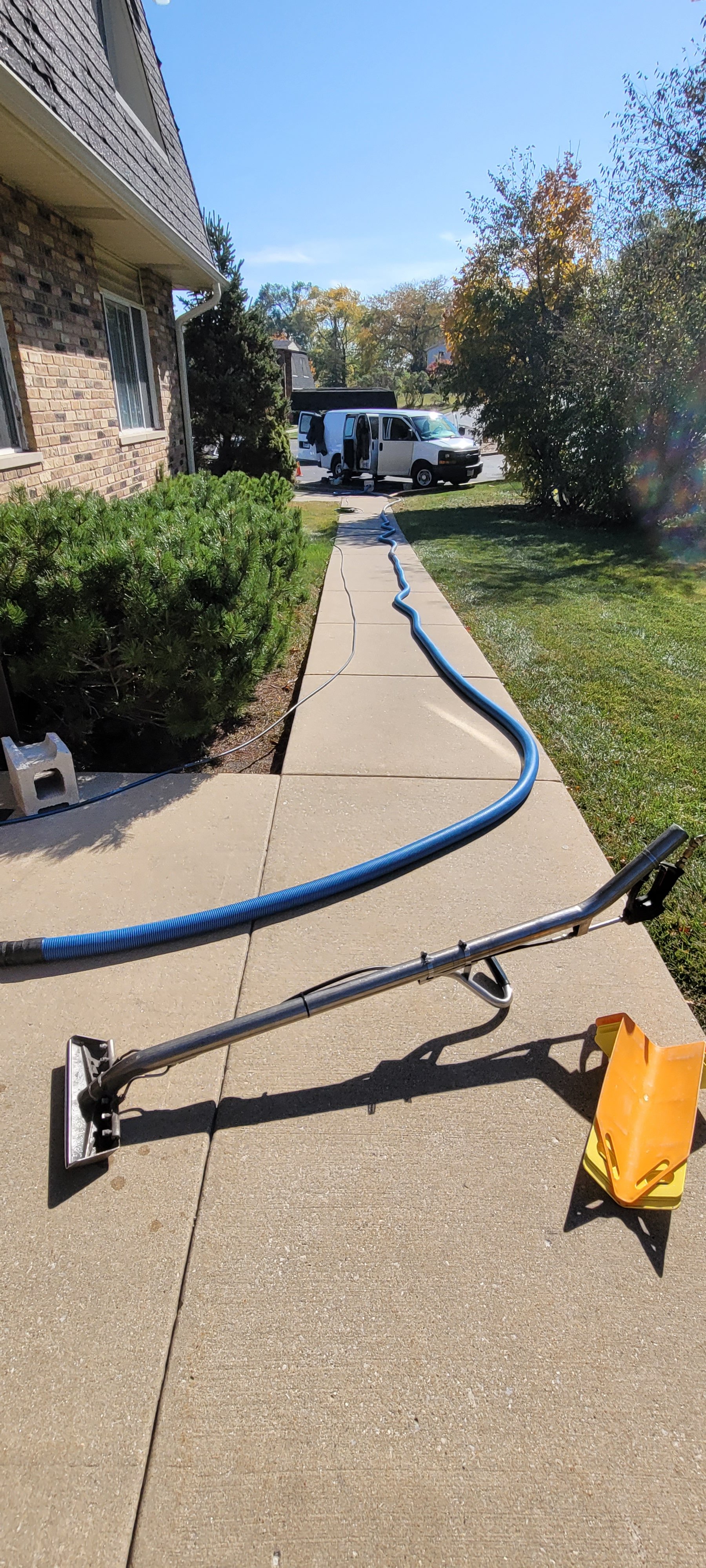

There’s also something to be said about these ergo handles, but nobody has made them right yet. Much easier to push a wand when your wrist position
The side handle on Prochem Ti, in my opinion, offers the operator the most allowable comfortable swing. One thing is to have our body aligned with a wand, but the wrist on the side handle means freedom of movement compared to positioning your hand in front of the body when the handle is on the tube of the wand. Maybe is the matter of habit, but I like to use my ' big boy'. I have wands with two different lengths; 62 inches and 65 inches. Both feel right.
