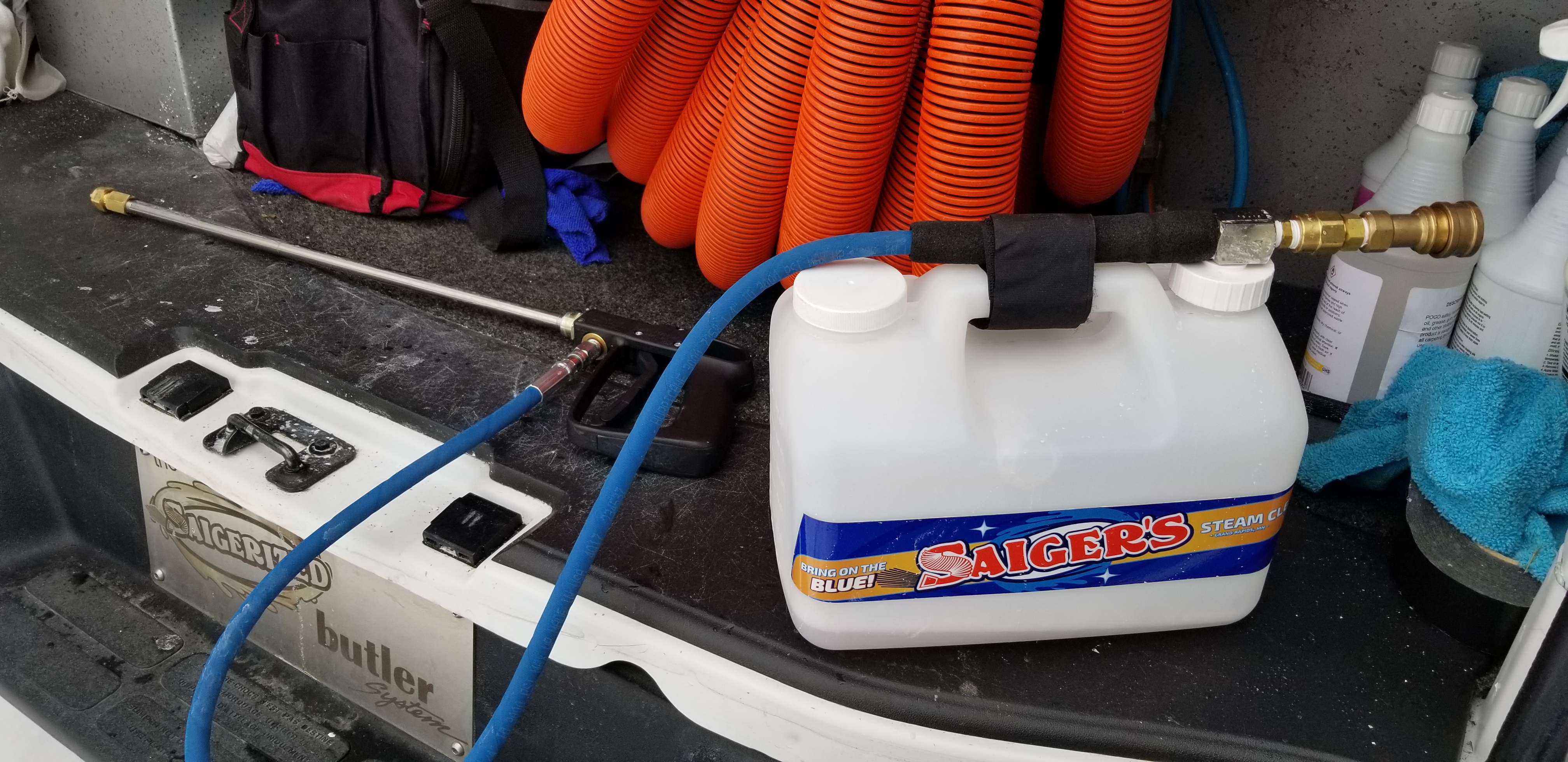

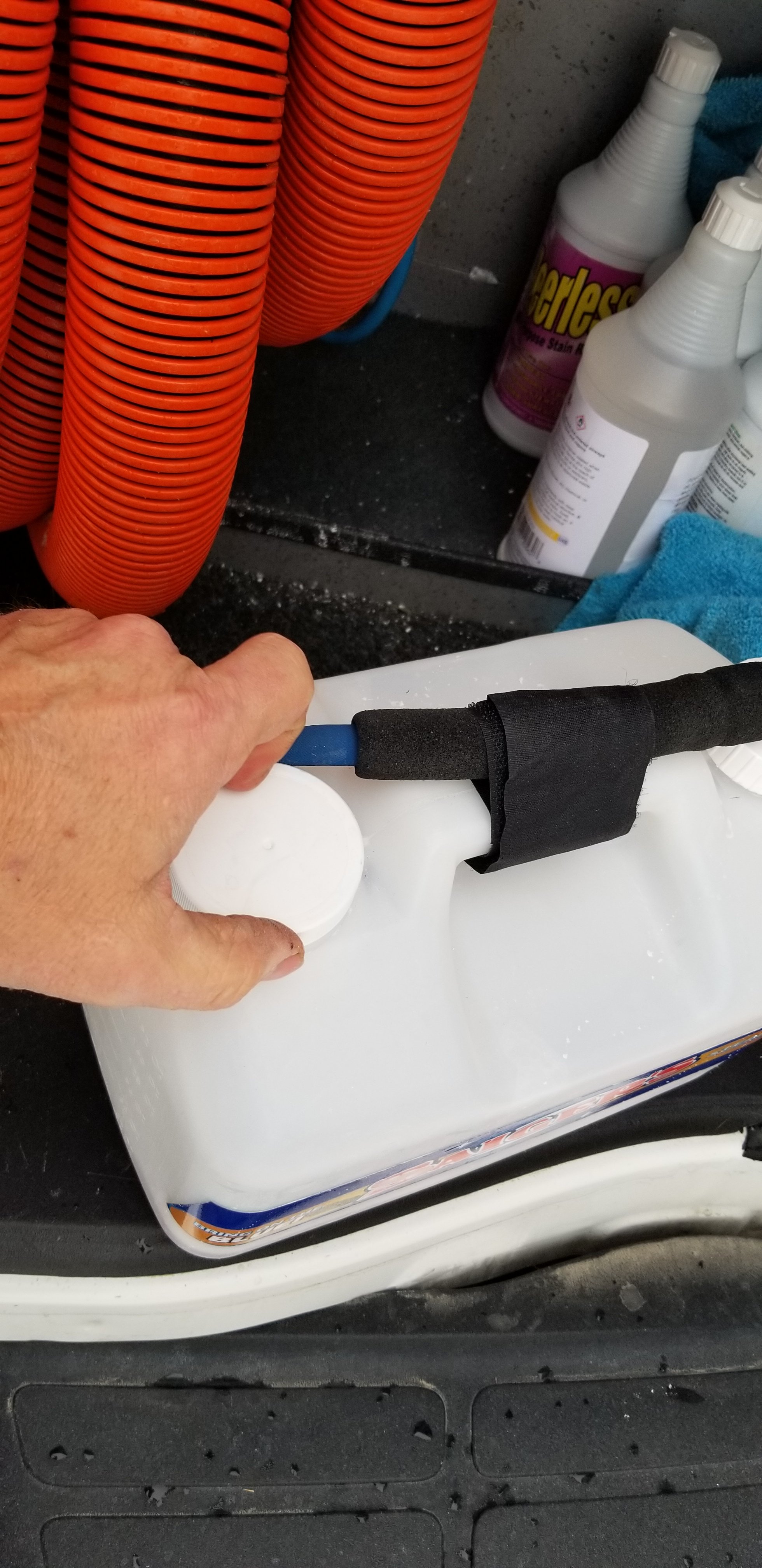

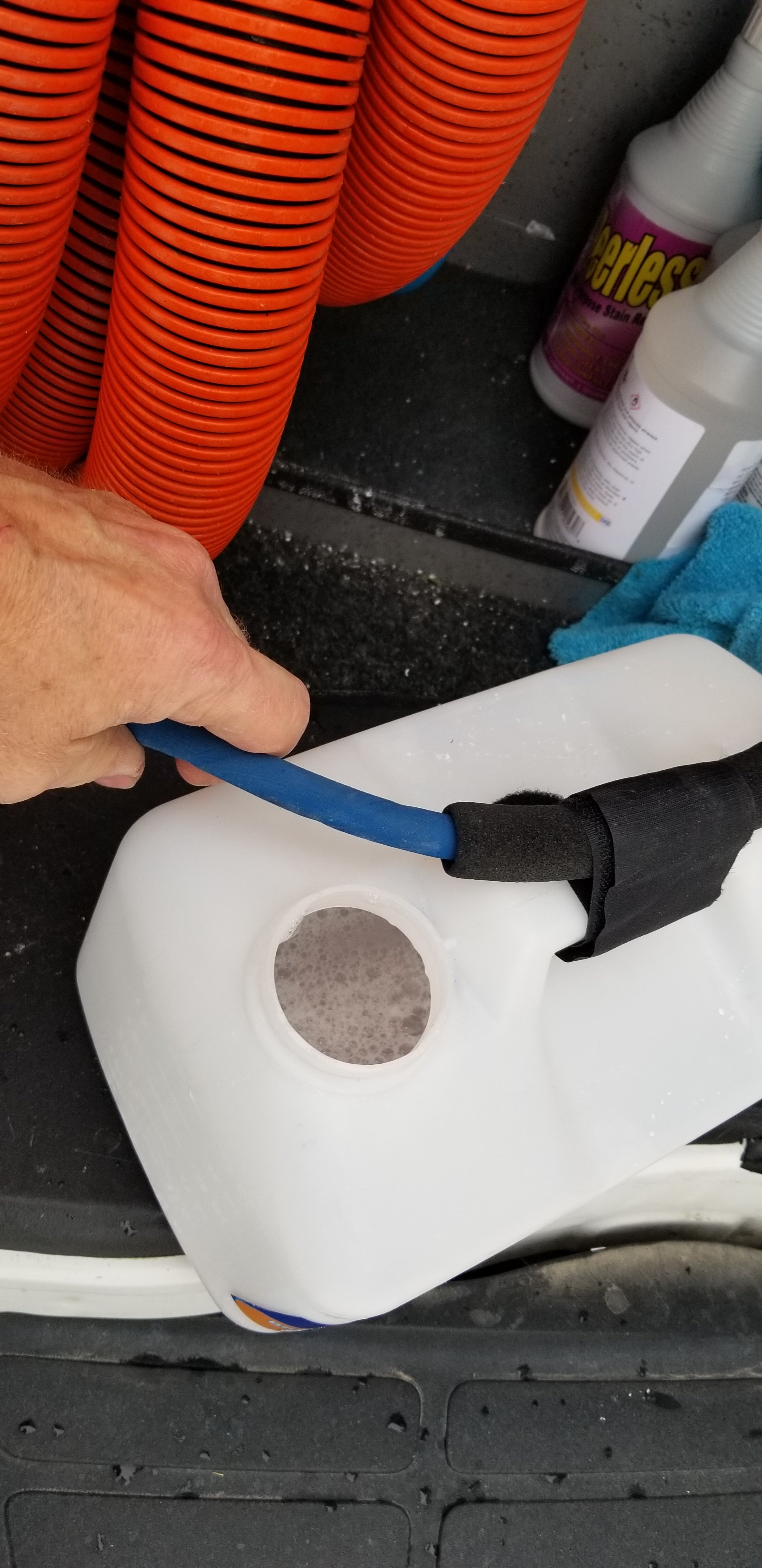

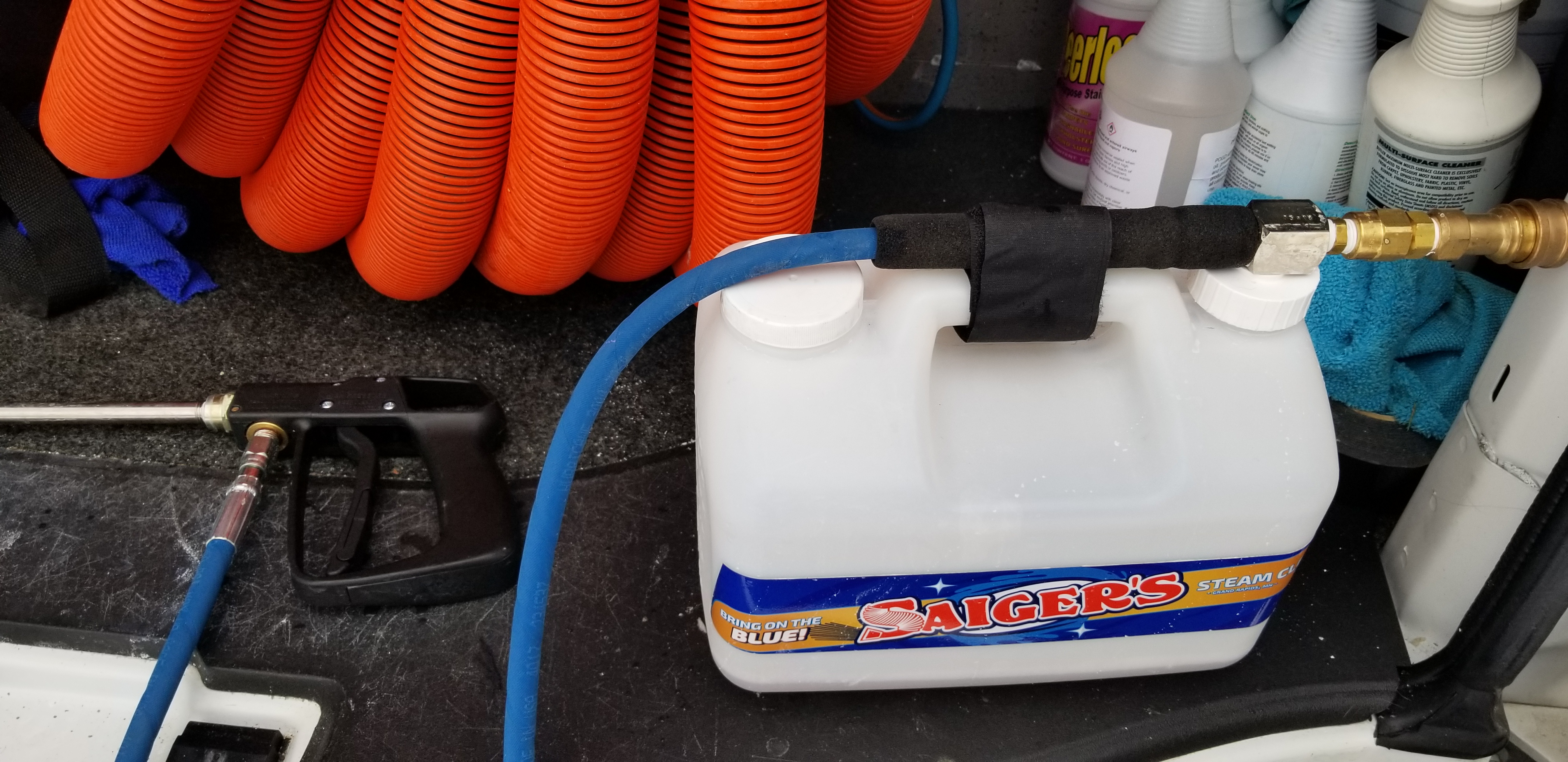

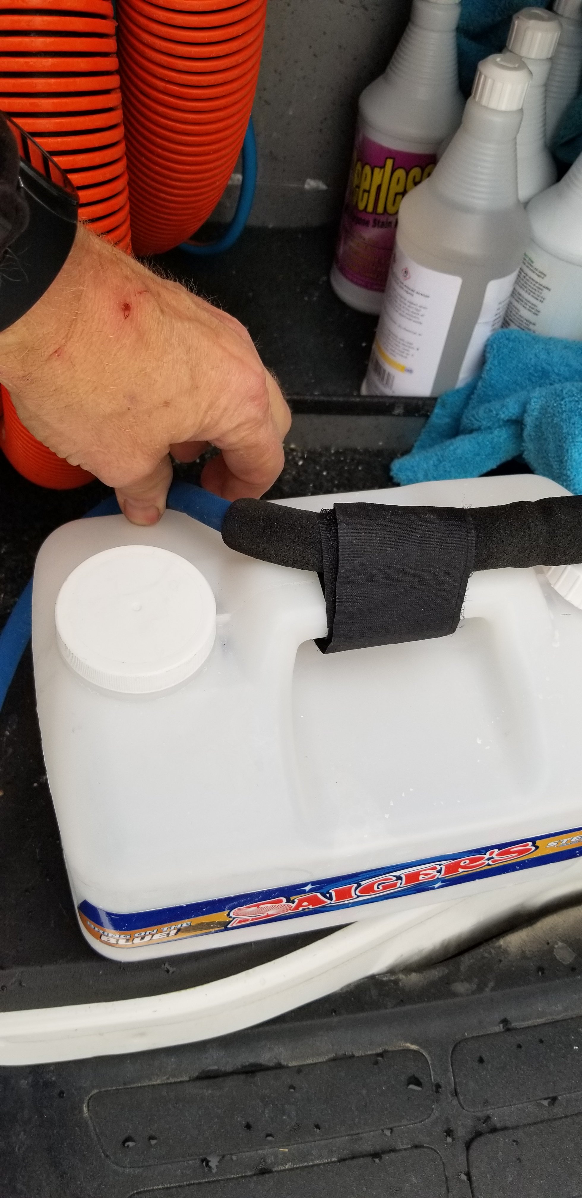

Mark Saiger
Taking out the hard inline brass tube??? Are you referring to the tube on the handle or some tube inside the dema valve?
Yes...that's what then did on the six quart units. If look in pics, easy to get to the large opening now because the rubber hose will move off to the side.
