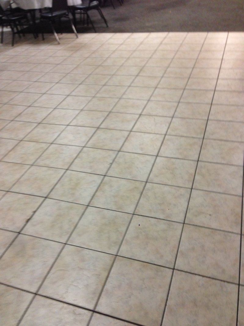

looking at my first tile floor cleaning, I have a small portable and no real tile tools. I know I need a brush and was looking for somthing to clean some very dirty grout lines. I have a small steam cleaner but still need the juice.
So far I'm leaning on the cobbs ???

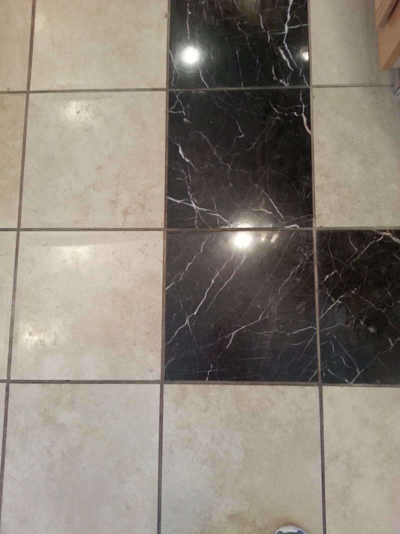

Hey Mikey would you use regular tile cleaner and a spinner on this marble tile?
50,041
Procyon, Power Max, Flex w/citrus, whatever is mixed up already.
Don't stress over it.

Thanks, I have Procyon, I will use that and take an after pic and post it here so you guys can see how it cleaned up!!
