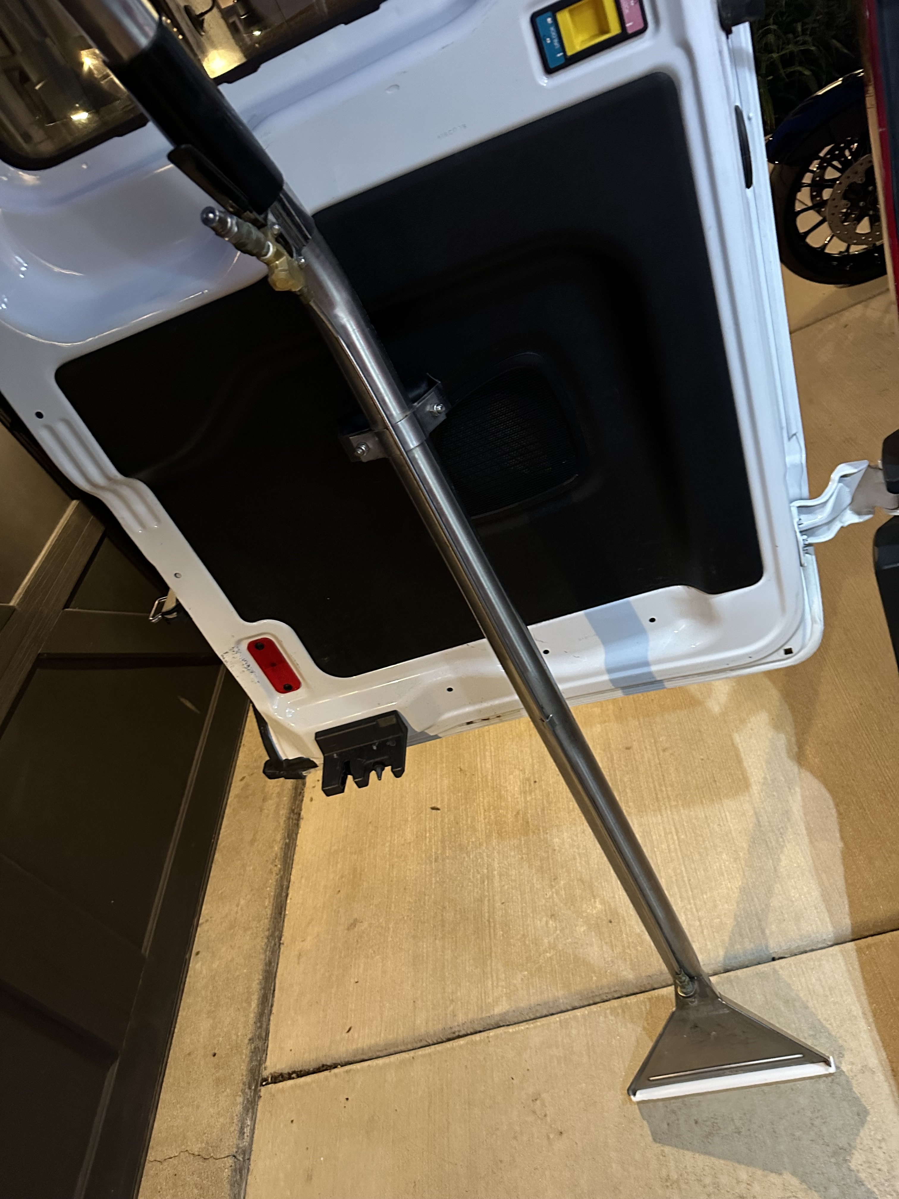

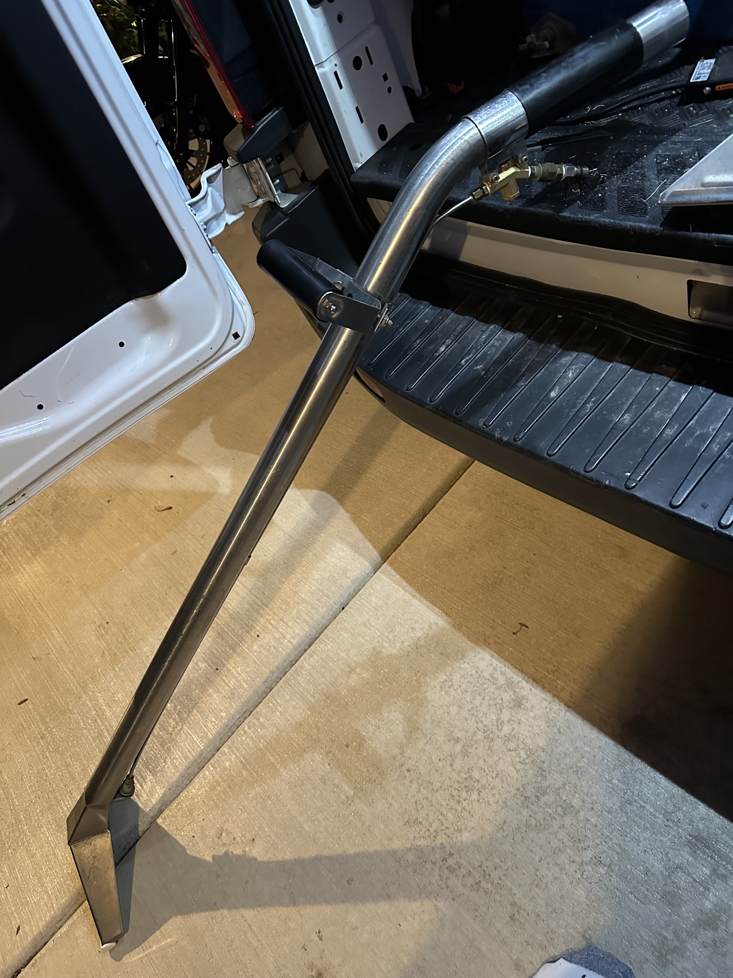

A full 2" Hoe?
Pics please
Greenie ordered it for me back in the day. I also have a 10 inch Prochem wand (I believe) that I bought from Brevick that is awesome for cleaning area rugs, no glide needed.

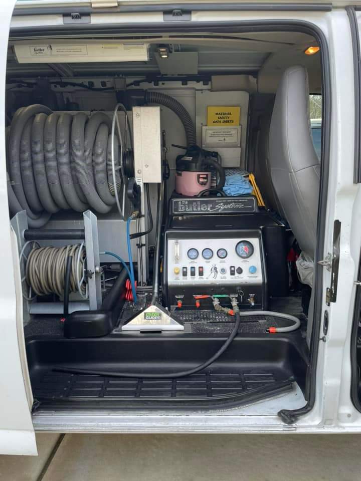

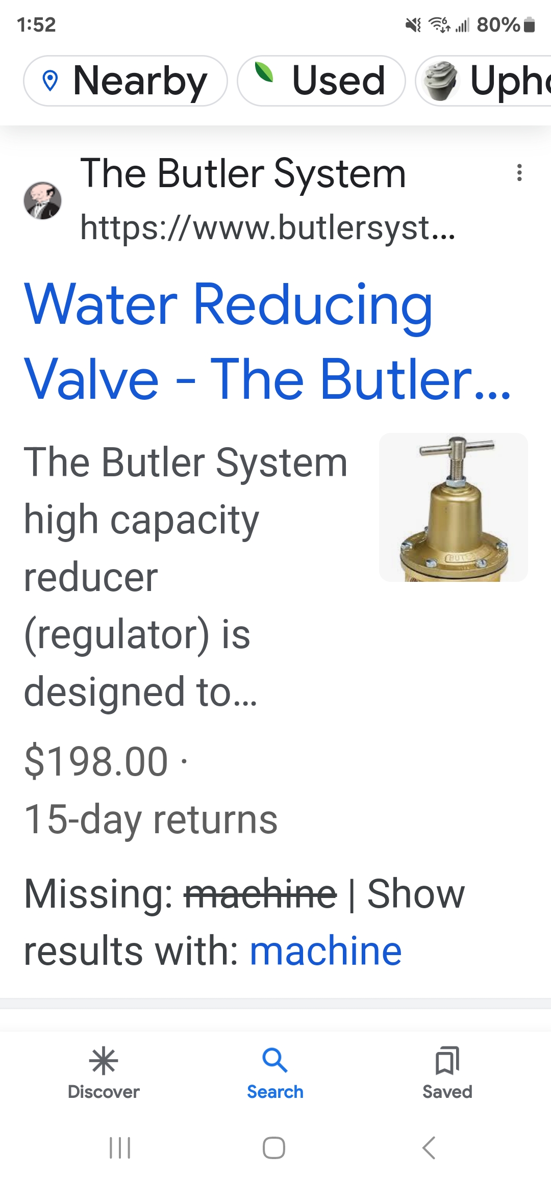

I didn't like the flow restrictor on the butler for a long time but did learn to adjust it for the job. It's like using the shut off valve to adjust flow without changing pressure. Yes I've don't that too. It makes jet size less of an issue.
Everything is adjustable you just have to experiment. And yes too much water reduces flow in the vac hose. You can hear the airflow change at the wand lips.
they live
Apr 22, 2024
1,033
Michigan
Steve
My WM didn't. That's when I learned to turn my shutoff valve on my solution line down to reduce velocity and change the spray pattern. Same pressure less water.

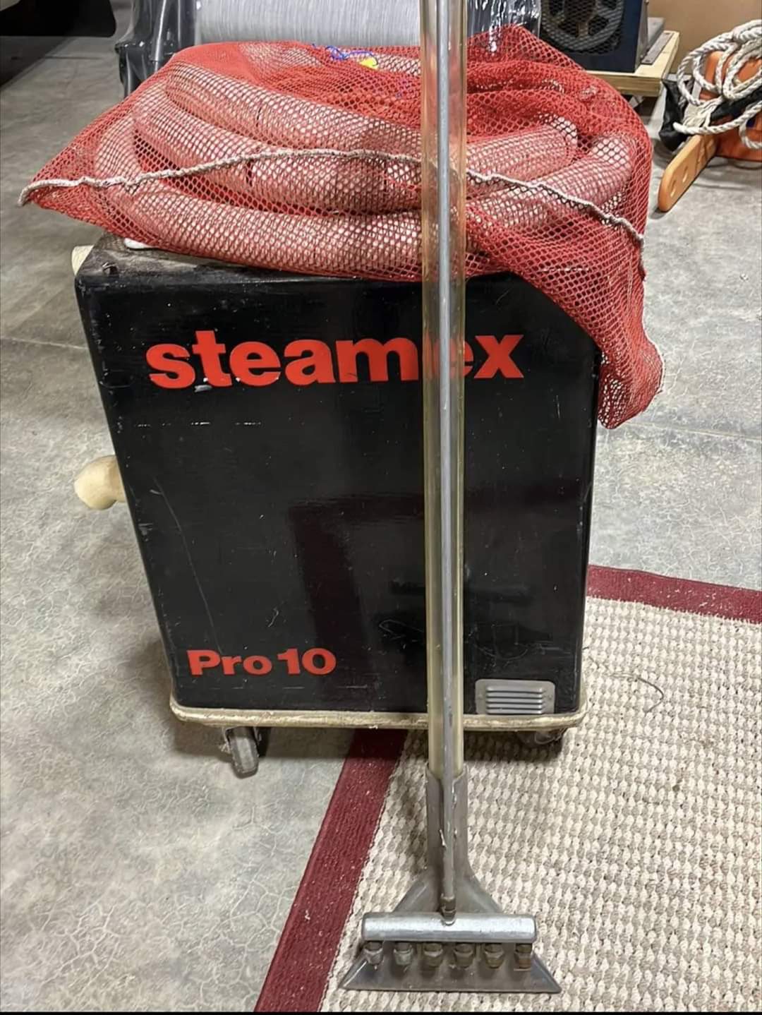

If you match the flow with the vacs or blower then over wetting not a problem. The steemex in the picture is the same as the one that came with the purchase in 81 with a propane tank that leaked. Junked both of them . Purchased a Hoover 20 gallon extracter. then a ninja. Finally White Magic. But that was then just sliding along now 43 yrs later everything is for sale in sunny Florida YEA time to RETIRE. jz
