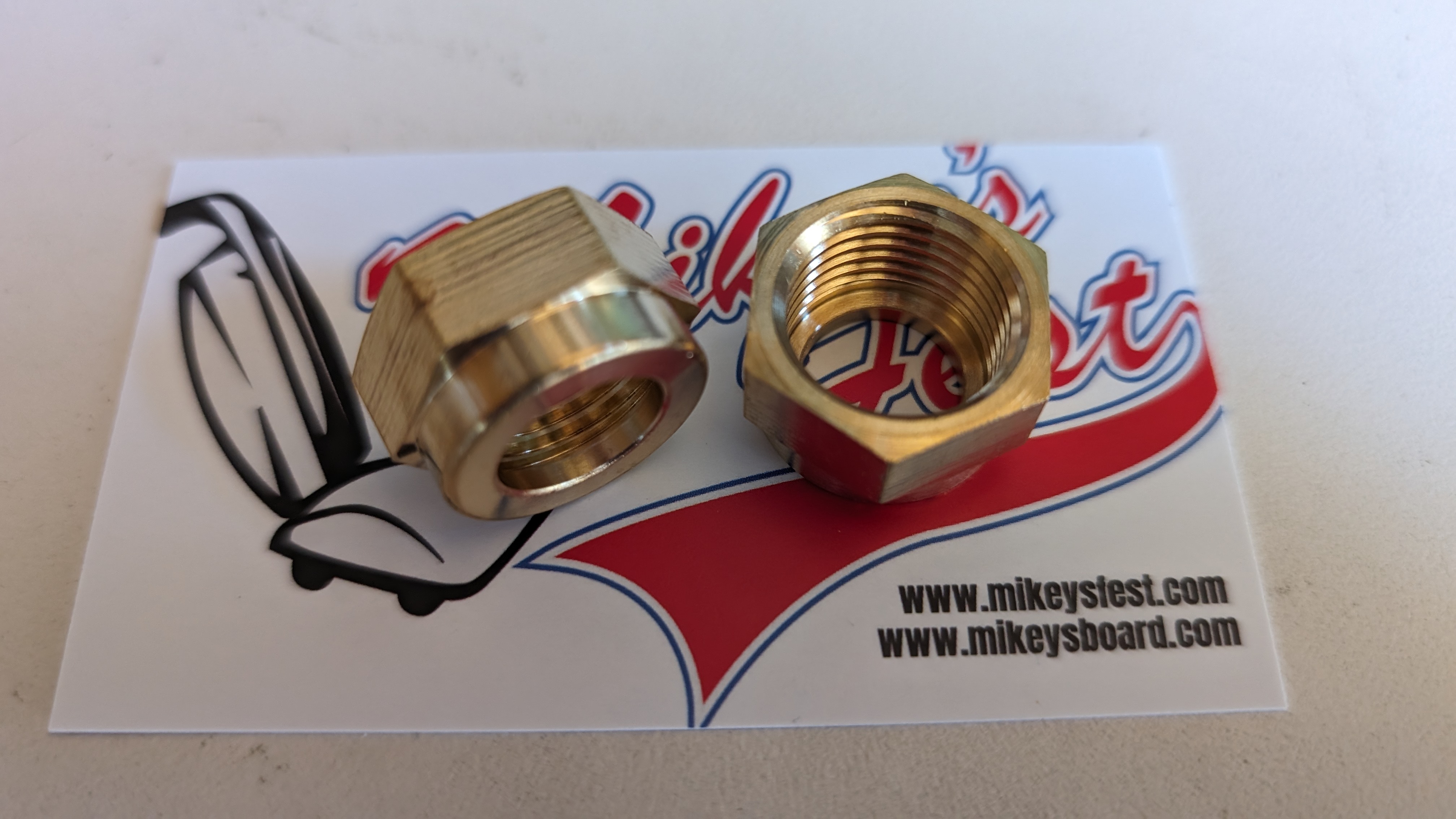

Makes me wonder if your four flow hard surface wand isn't putting out twice of what it should, I'll send you some '01s to see if that doesn't fix your problem
Thanks Mike I appreciate the help. I got my portable running so now I can get back to figuring out hard surface rinsing. A two flow might allow my portable vacs to keep up with it better, flow rate has to be in proportion to suction?
