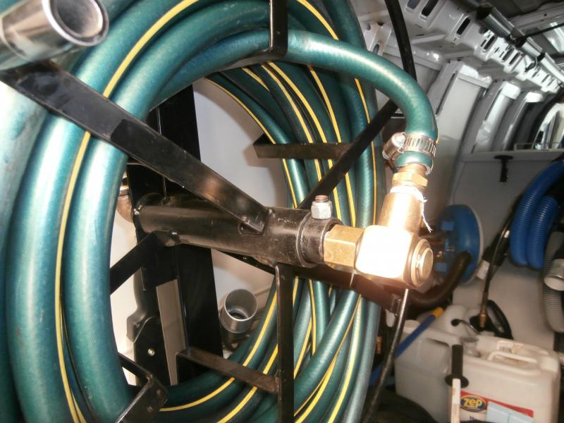

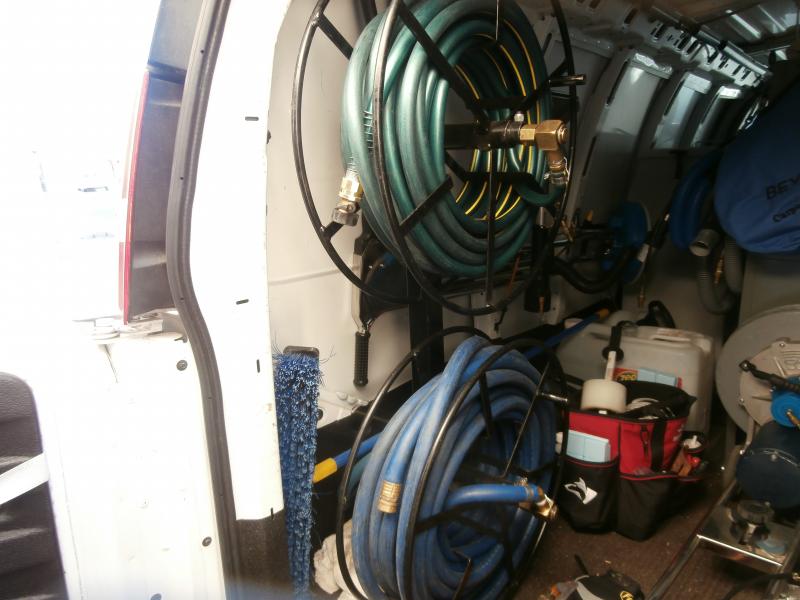

J
JS41035
the top two pics are from Jim Martins setup. He posted the Wintrax part numbers also.
My APO is plumbed into the top reel and fresh water is on the bottom because I evidently enjoy getting wastewater on myself when I wrap up.
Put a cap on the end.. That way it does not get all over you or your truck....

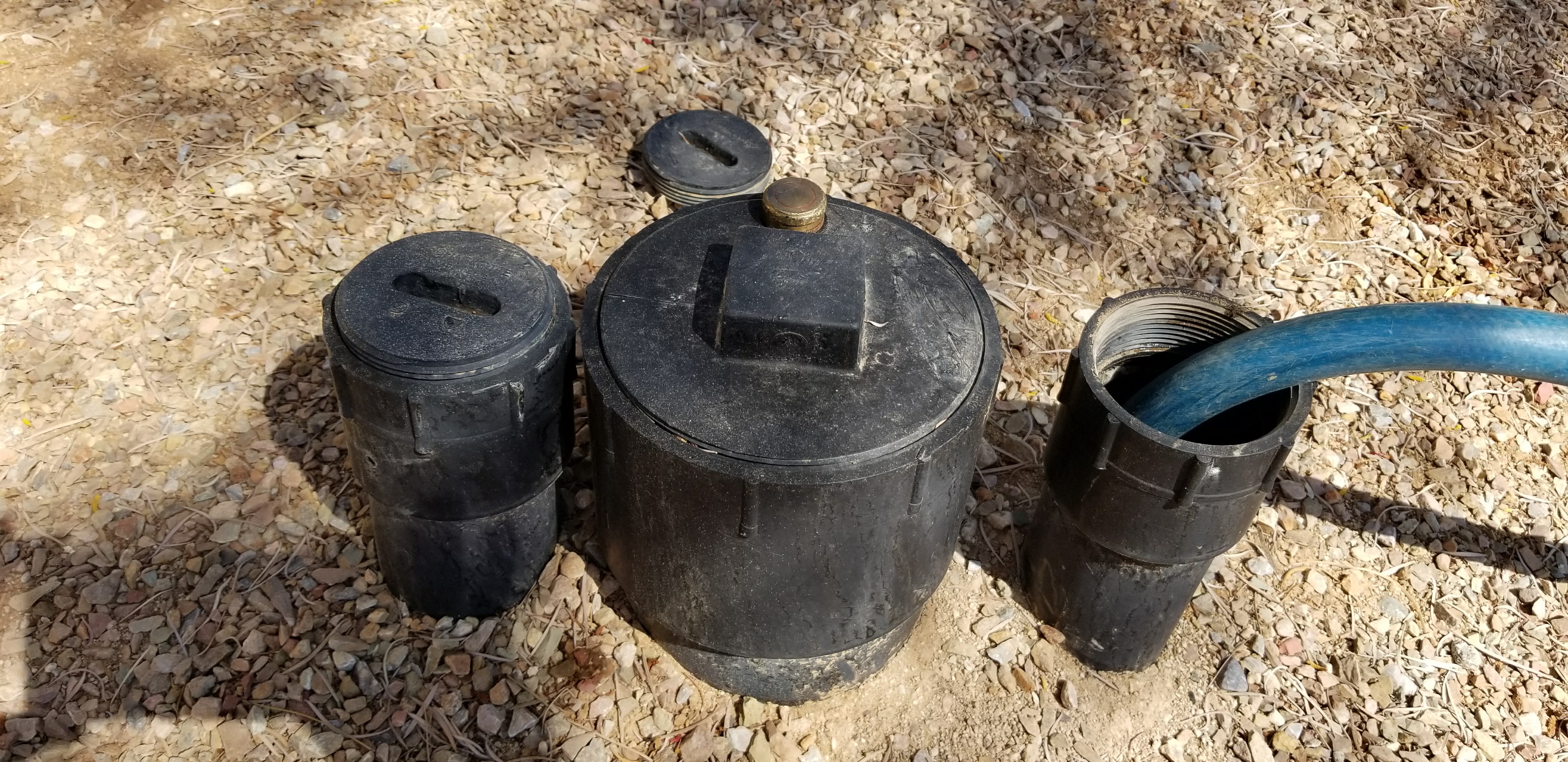

Where is everyone pumping the water to? Do you run a hose back into the home?
roro
Oct 18, 2006
1,311
Ross Craig
Here virtually all buildings have a gully trap for wastewater located outside the building, so that is where we discharge to.

the big one is the sanitary sewer, that one is their well.....
The one the hose is in goes to the street..... The one on the left is from the home... The large one in the middle is a one way flapper that allows the sewer to go out of the house.. but is for some reason everything backs up on the street side... If will not go into the home...
