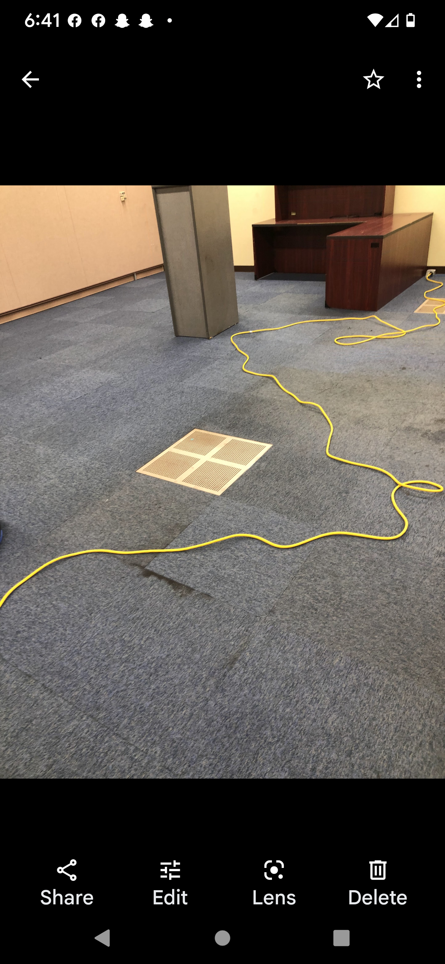

I've done both, the vlm came out great there was no way to run hoses doors locked government facility.
Would've been 350 ft run easy
Basement area that would have been swampy.
My commercial jobs dry fast!

Are you running weights on the Vibe? If not, you should… the cleaning difference is big.

Okay. I don’t. One weight? Enlighten me. What about friction?
Orbot sells a weight kit for it. The problem with your machine is it only has about 35 pounds of head weight, which is about half of the Trinity machines of comparable size. Head weight to VLM is like psi to HWE. So even if you put the entire weight kit on your machine, you’re going to be just above the head weight of competing machines.
Think of your machine with no added weight as cleaning with a wand at 200-300 psi.
