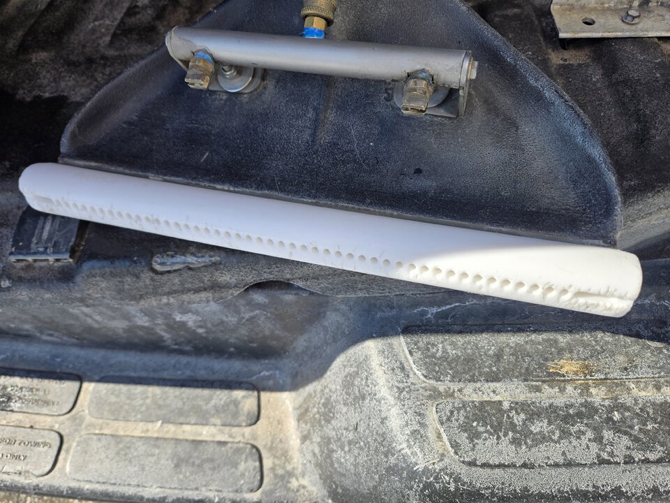

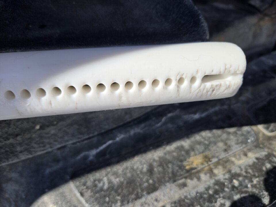

Sometimes my wand locks down on cut pile carpeting, but most of the time it doesn't. Just yesterday I was cleaning a cut pile carpet and the wand was locking down and very heavy to pull. I'm not sure what to do in those situations. The carpet had much more moisture left on it after my dry passes than usual.
I'm using a hole glide on an Evo 13" wand. It has some grooves going out to the side. They are worn down a bit, would carving them out deeper help prevent lockdown? Should I have a different glide to swap out in those situations? Would turning down the rpms on my machine to lower the vacuum power help prevent lockdown? I was running it at 1400 rpms with 100 feet of vacuum hose, which is at "medium" power in my CDS 4.8, maybe I should turn down the sauce on shorter hose runs.
I'd rather not wrestle against my wand and only end up with wetter carpet after my efforts. Any tips?

I"m really surprised to see a lockdown with that hole glide. Not normal for sure. But leave your settings on the machine as is. Can you remind us what the hg is set at on your machine?

View attachment 133873View attachment 133874
Ok thanks. The hg is set at 13.5. Although I just pulled my seal-a-door out from behind the waste tank that day. Maybe I bumped and adjusted the release! I'll check the gauge next time I use the machine tomorrow, I only had a commercial vlm job today.
was it a plush?
I'd say it was a medium pile carpet.
14,562
Have you burped your gauge in a while?

That little rubber cap on the top of the gauge behind the face of the machine. Pull it off. That releases any buildup of pressure in the gauge and resets it to make certain it’s reading accurately. If pressure is built up it might be turned up much more than 14hg, causing too much suction which could be locking the wand
But it doubt that would cause it since you are just using that hole glide. But it’s a good thing to check periodically
Most excellent. Thanks Woody!

117,102
I can't imagine any situation that a whole Glide would lock down with that cavernous wand..
I forgot what truck mount you have but make sure that your vacuum relief valve is working
117,102
He is using the smaller 1.5" Evo wand--
Perhaps the carpet/rug was rubber-backed or had PetSmart (urine "proof") padding, is my guess.
He used the word sometimes in the original post so carpets that are extremely dense like the rubber back type that you're suggesting could be an issue
The side channels channels he spoke of can certainly be regrouped with the Dremel or the side of a drill bit to provide some relief
And I hastily used type of talk and made a comment about being weak in my original post, which came out wrong but Bryce is a slight fella and I suppose it is something to be considered. It's pretty hard to imagine with that wand and a hole glide. Unless there's something wrong with his health that wasn't going on the year or two ago, which I believe he should take into consideration.
Slot and hybrid Glides would be even worse in any scenario
Check your vacuum relief valve Bryce

I'll check the vacuum relief next time I run the tm, on Monday.
Why would this cause lockdown? Is there that much more fluff to that type of padding? Or does it form a seal while other types of padding are more breathable?
Thanks for the tips. I think I am in good health, I feel fine. I don't smoke, or drink, or do any drugs, and eat only whole foods.
This is a rare phenomenon, experiencing this lockdown, which I know it is lockdown as it is leaving the carpet fibers noticeably wetter.
the rubber forms a seal.
