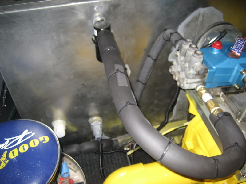

Not exactly. My (probably incomplete) understanding is that cavitation occurs when there is rapid fluctuation in local pressure below the saturated vapor pressure of the water. Temperature is involved because the pressure where cavitation occurs (at a given pressure) goes up as temperature rises. So, increasing the inlet pressure and/or reducing the liquid temperature can cure cavitation.
When the piston draws in liquid through the inlet plumbing and past the inlet valve there is always some pressure drop. Poor plumbing (tubing too small, restrictive fittings) make the situation worse. The water level above the pump inlet makes a difference as well. The higher the level - the more pressure (head, as the pump guys say) is exerted at the inlet, helping the situation. Make the pump draw water uphill (water box below pump) creates low pressure (vacuum) making the situation worse.
You can create cavitation at any temperature (with enough inlet restriction and/or low enough inlet pressure) but high temperature makes matters worse (much worse, as you approch boiling).

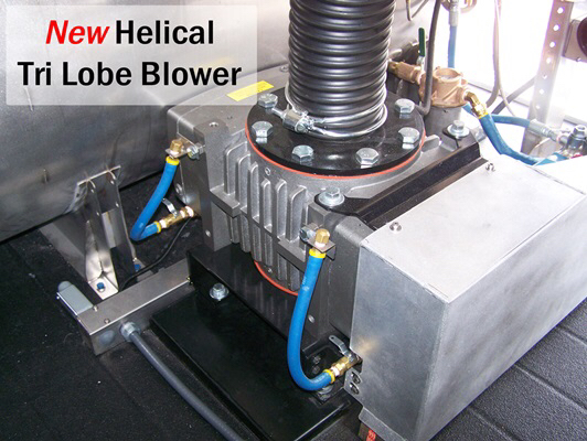

As mikes machine as well as rims machine are newer aerotechs that have the pump Mounted to the floor in the box well below the fluid or water level in the fresh tank.
You will notice the cat pump right in front of blower on floor of truck.
Older trucks like mine have the pump mounted above the blower always above the water line by at least a foot or so and the pump has to pull one foot up and at least two feet across to get the water.
I had cavitation but only because of that General pump fine inlet strainer connected to pump would suck a bit of air, once removed never have had cavitation again. Our tanks after a couple of hours will hover at 150-160 degrees preheated by motor while driving around.

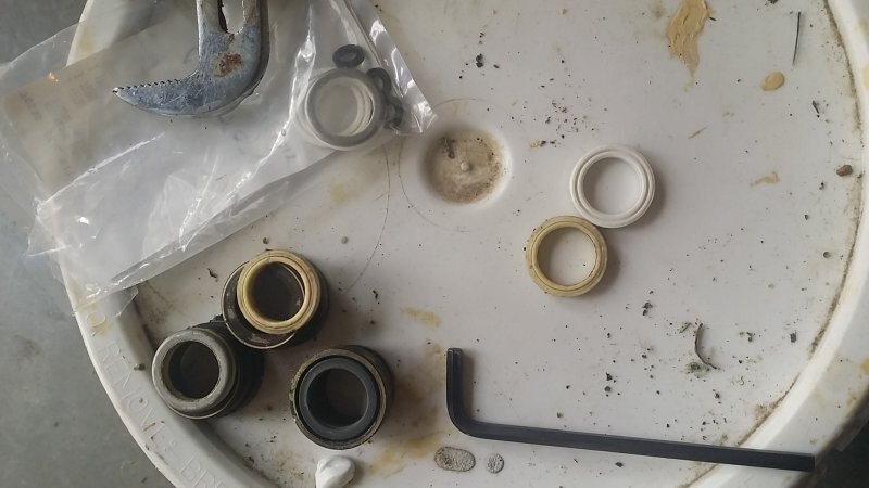

I will pull one of my cat pumps apart to see if I had that type of wear going on.

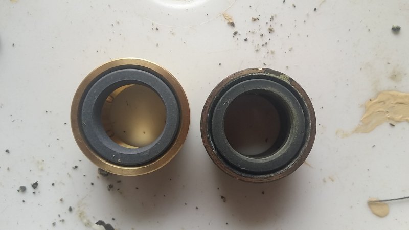

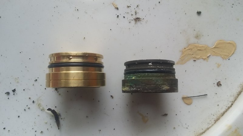

That didn't look so much like wear as it did something aggressively attacking it. ???

That is what I mean as the brass plug mike has posted a pic of does not move, it is stationary. The plunger moves in and out of the middle of it creating pressure in the head. So what ever is "wearing or eating" it has to be in the water.

I agree. severe cavitation can/will erode the pump materials but not (in my experience) discolor them like that. Certainly looks like either chemical attack or electrolysis to me.
