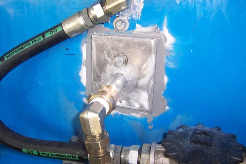

My prochem PTO had a big crack in the waste tank so heres my 20 min repair until it gets bigger.
[/img]th_100_3277.jpg[/img]
[/img]th_100_3278.jpg[/img]
[/img]th_100_3279.jpg[/img]

So my patch got some jobs done but you could still hear it suck some air. So I tore it down to see how bad. Not good as you can see. Prochem must have smoking something when they came up with this design. No way to clean around coils. [/img]th_100_3281.jpg[/img]
[/img]th_100_3282.jpg[/img]
[/img]th_100_3283.jpg[/img]

So I fixed it with with some coaching from greenie ( Thank You Greenie) What a PITA. Had re plumb some stuff because crap was so tight that 3/8" made it so the oil lines would not go back on. So after many trips to ace and hydraulic shops that did not have what I needed it's fixed. 3100 hr and only 6 yr old machine and the tank does this, Quality stuff.
So who says whos #1 because this machine would not rank very high on my list.
[/img]
[/img]

Nice repair! It's great that someone like Greenie is around and willing to help us out.
B
Becker
I'm sure he did not ask for anything on the advice, But just imagine how much he saving you in professional repairs, and possible down time, lost or delayed jobs.
Toking is a nice gesture.

If you brought this to the shop would they repair it, try to sell you a new machine or refuse to repair it because of some strange reason?
I have not had my machine to the suppiler since I joined this board. I do all machine repairs myself now. This one I wasn't too sure about but after talking with greenie I had a plan. Of course the the whloe oil line thing was prochems design & murphys law that made this repair take forever.

Thats a excellent repair. Nice and clean and will probably out last the rest of the tank.
A plumber was telling me of this product he has. Its like a playdough, pliable, and it will dry as hard as metal. He told me he was repairing a cast iron pipe, took a wad of this, flattened it out and covered the hole.
I'll have to get the name of it from him. Good to keep some on hand if you have older tanks.

The coil is a cooling coil for the hydraulic oil. The waste basket sits in the middle of the coils.
