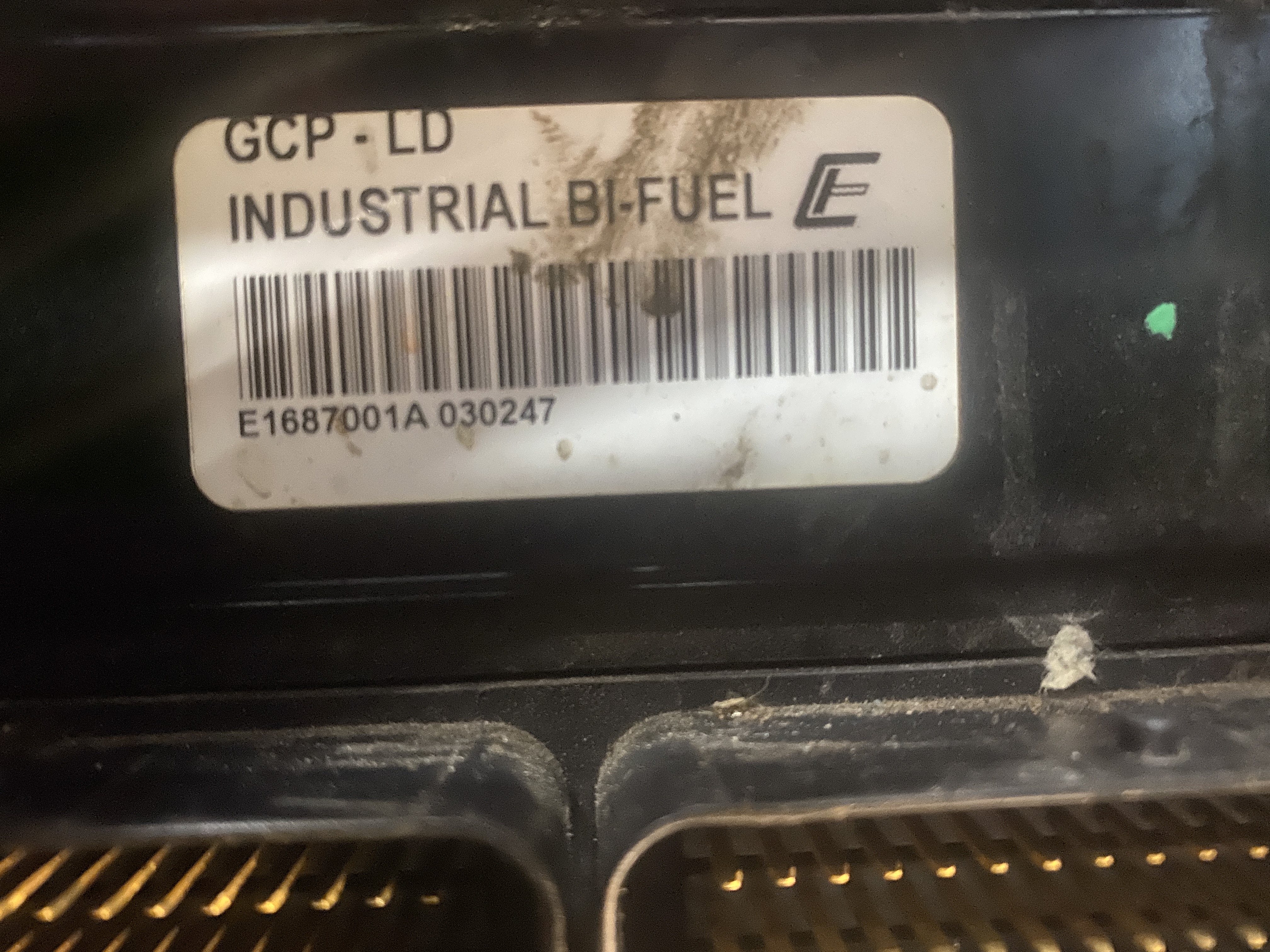

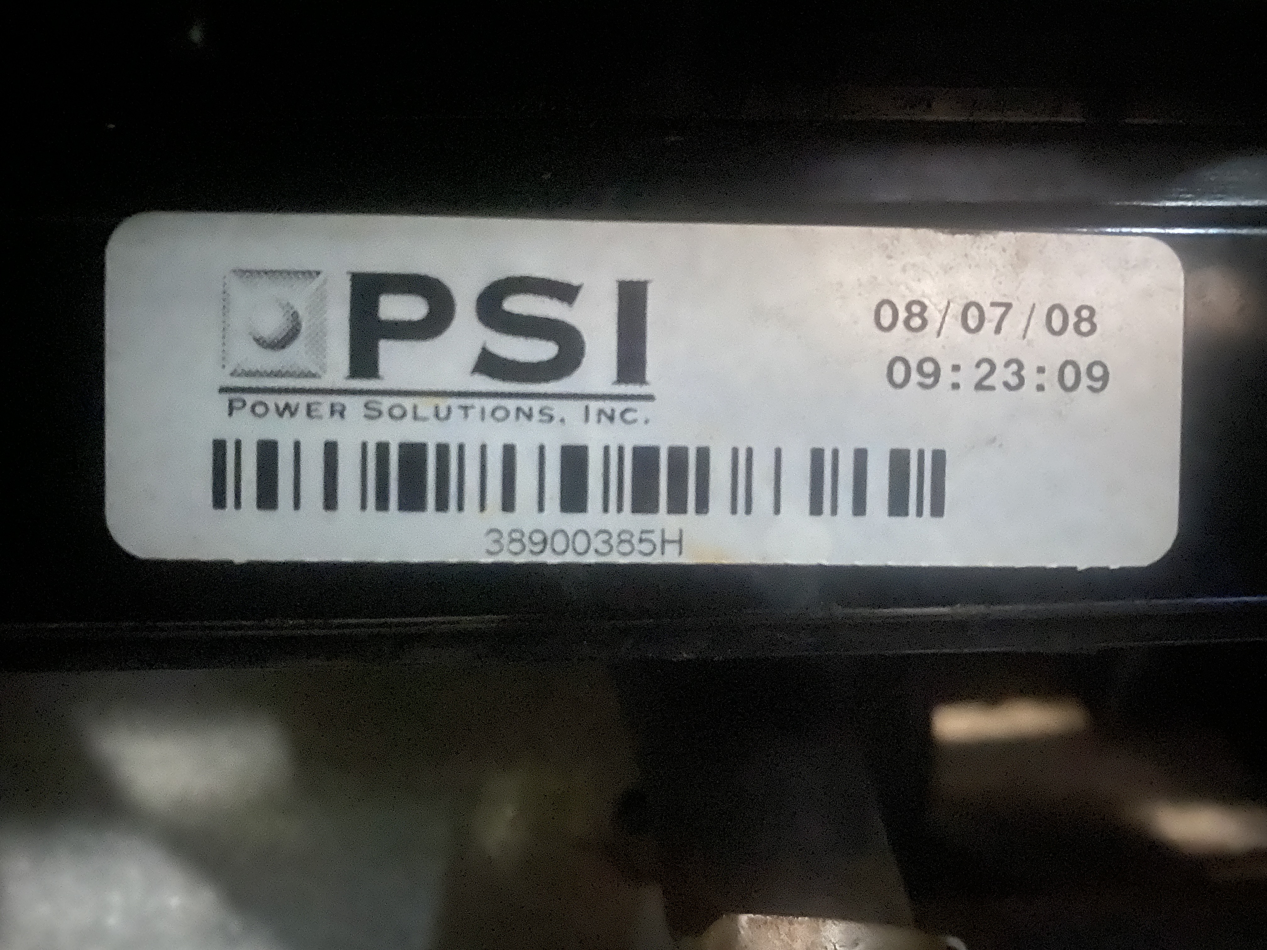

Need a replacement ecm. Here is the pictures f the one I have .

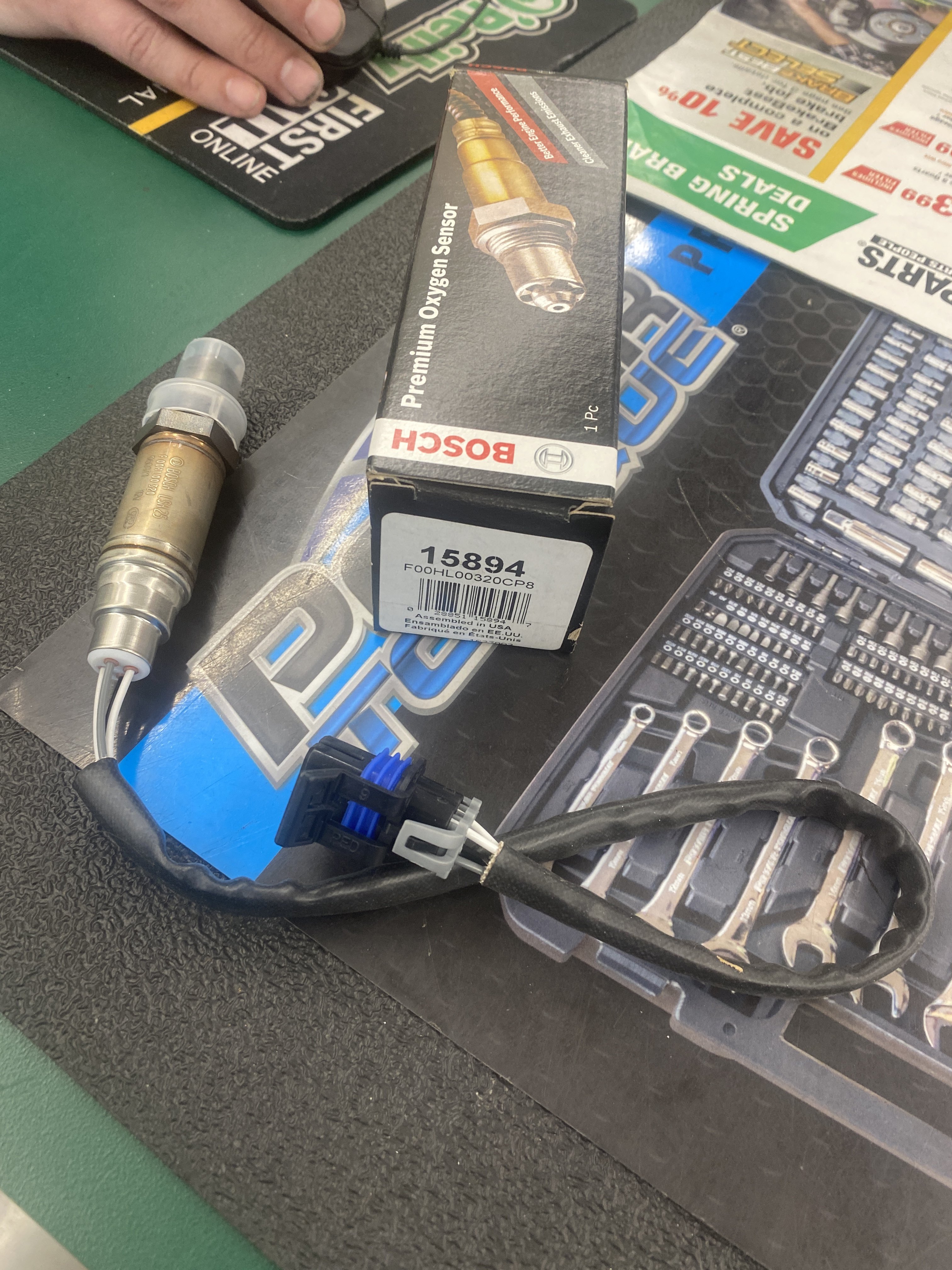

Attached is the part numbers for Orilies . Coil pack, o2 sensor 1 , wires ignition, plugs , secondary o2 sensor. If you get a problem missing or stumble try wires and plugs first .
21076AD2-A3EF-4658-8D88-5CDE8BF65795.png 839354ED-8D96-4F96-8081-2D3DCC710301.png C1CA7678-CB0F-41FF-B1DB-D8023CD67E07.png A8E69BD9-D2CE-4FE1-AC05-732A9D1826E3.jpeg
