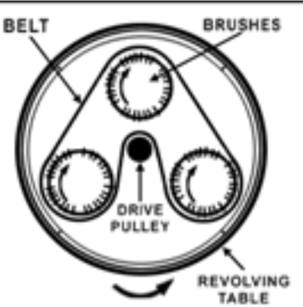

This statement is false. I use a CRB on a fairly regular basis, and not only does it help to remove ground in soil, it lifts the fibres up, and scrubs the prespray in. The end result is FAR superior to using a grandi groomer, and wand...
This machine, like all others, has its place in our industry...

Try this simple, easy test next time both tools are in a building;
Spray your pre-spray de jour
Run your CRB across a soiled traffic lane.
Run any ole bonnet or pad with any ole rotoscrub or ox-galating MoSheen right next to it.
Lemmie know if you can tell the difference
Planetary action is difficult to beat for agitation.
semantics
it's still a rotoscrub, just easier and more idiot proof than a rotary or rotary with the shakes*
