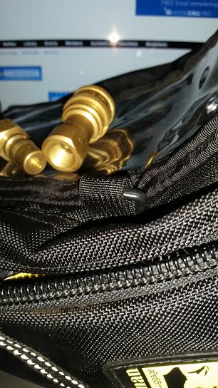

dont forget spare brass and QCs
got it......and there is an ace and HD within 5 miles of his place
