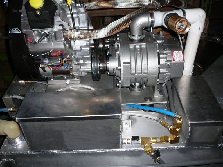

Here is a pic of the set up. We do not use the water box . We pull from the water tank (see gray hose that angels down) on bottom of pic) and comes into brass fitting

My water pump has two places to feed water. If you pull the plug or hose opposite the main feed water should flow freely. It will narrow down before or after the pump.

Force feed it water with a garden hose. On inlet side to prime the pump and get it flowing for a minute. Shut water off unit connect tm inlet hose back up.
Make sure water box is filled and close lower supply line ball valve and open ball valve for water box. Water box must be full so your draw line will prime easier. Turn unit back on and run with a tool connected and hold trigger and spray for a minute. If prime still holds( if done correctly, it will) with unit still running switch ball valves again ( close water box water supply line valve and open fresh water line ball valve) and again check to ensure you are drawing by triggering wand or whatever you are using to check correct operation.
Call me if this doesn't work 817-829-4708

It looks like one of your shut off valve is closed.!? maybe you closed if before you began working on the TM?-- I've made this mistake many times.
Dan noticed that earlier....I assume he checked and flipped the waterbox off and the tank line back on
I thought this was aleady fixed based on the post a few weeks ago

That was a stock photo of the machine from Cobb I posted to show the lay out
If that was all that was wrong is the shut off valve was turned and they didn't catch it when I drove 6 hours to Nashville to get it looked at I would have been a little upset that they didn't figure it that out.!
