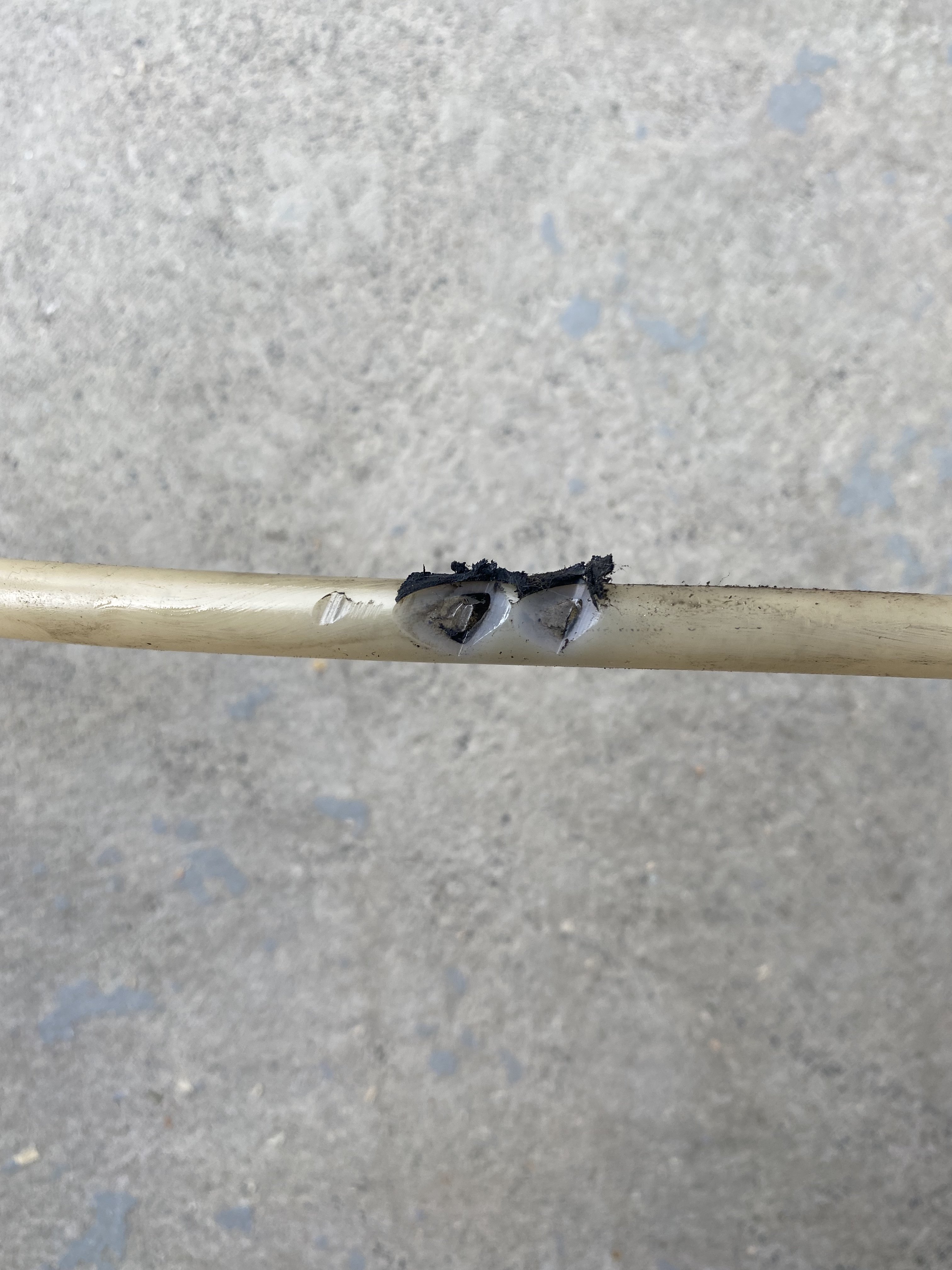

I spoke with Justin from legend brands and he gave me a few things to checkout tomorrow. I'm going to remove the lines from the bimba valve and inspect for cracks, kinks or water in them. Thanks for the reply's! I'm completely new to this industry and it's really awesome how much support experienced people give!
117,347
Just updating the post in case anyone else runs into this issue. Justin was spot on, I removed both the lines from the bimba valve and one of them had worn a hole through it. I replaced the both and now it's making heat properly!
Good to know, where was the hole?
Bosco83
Oct 26, 2021
5
Brian Boczkiewicz
Looks like the belt rubbed a hole in it.
