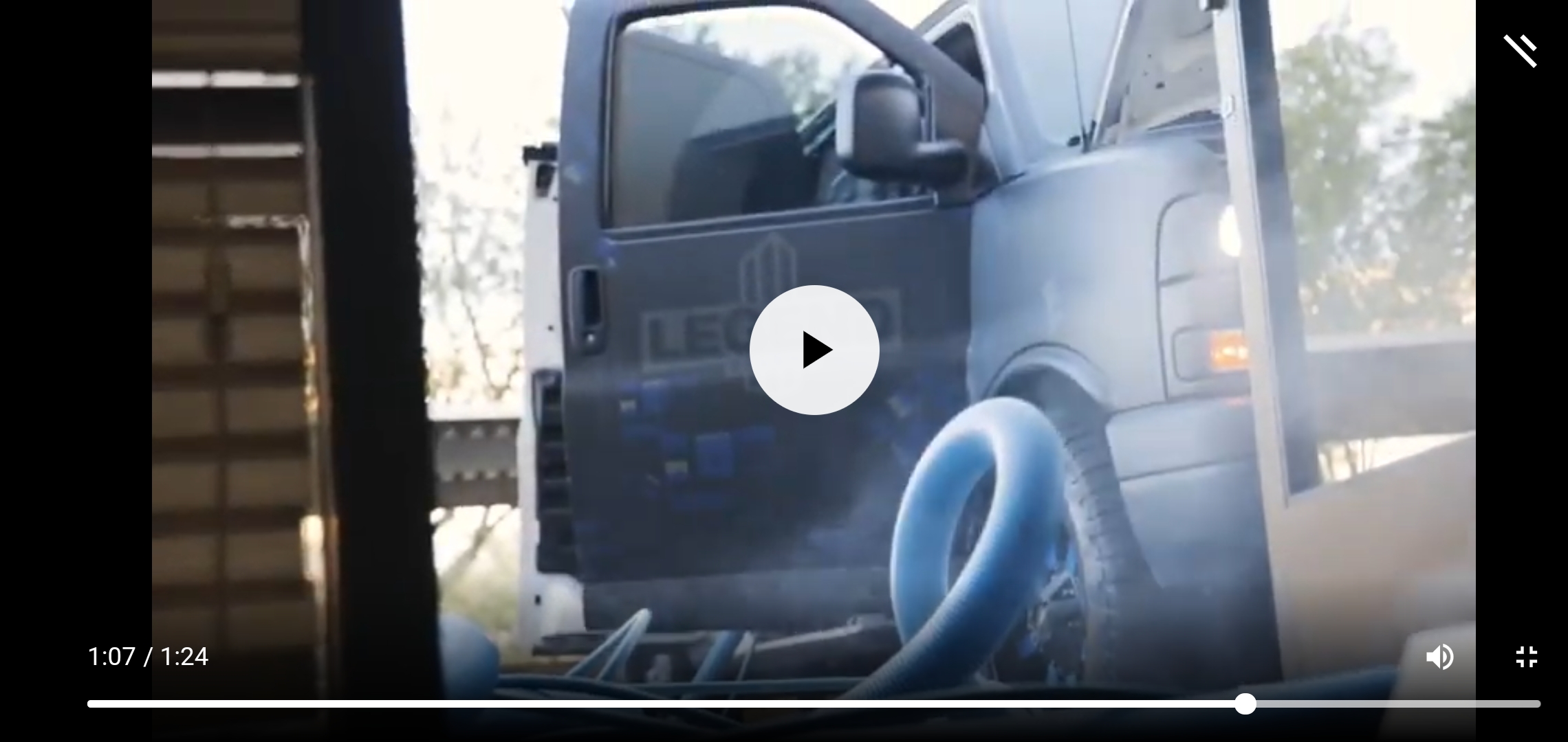

The PTS IS the pro1200se, Finkle is Einhorn... They updated the look and made a couple small tweaks and that was it. The hood up in the promo video is the most damning evidence
