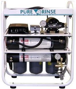

Found this at http://www.cobbcarpet.com/purerinse.html
Is this what zerorez is bragging about in all their propoganda?
Is this a must have or what?
At a cost of 4k sure seems like an expensive upgrade.
Anyone use one?
Reverse Osmosis Rinse System - No Residue
Removes All traces of Detergent Residue
1.9 GPM Output
150 lbs.
1/2 HP DC Pump Motor
Zipper Bag (Throwaway Filter Bag) or Shake-Out Bag
$3999

I have one, ( paid 3k ) - I like it and have now sold the biz.
So it is for sale.

George;
ZeroRez is spending many times what that RO system costs.
Dave Gill is using an RO water system in Florida and is quite happy with his results.
Without using any rinse agent, it provides the most complete rinsing process available.
Larry
davegillfishing
Cleaning Professional
2,229
dave gill
i love it and will not clean carpet, tile and grout without ro water again..that much of a difference.
dave

How much maintenance does it require?

davegillfishing
2,229
dave gill
the system is easy to maintain, i change the filters every 2-3 months depending on how much water gets filtered
and i am done..the filters cost me about 35.00 total. every other year i change out the membranes and they are about 50.00 each
and i run 3 of them..
my water is as pure as it gets..
i have a unbeatable combination..i use the powermax as my prespray and a pure chem free rinse and i am good to go..i also use less prespray and chems
because the water is so pure.

A home RO system uses more water than it makes. The filters need a lot of water so it might take 2 or 3 gallons to get 1 gal of RO water in the resevoir tank.
How does this system work? Where does the extra water go?
DI water does not have any waste....it takes 1 gal. of water to make 1 gal. of DI water.

A
alazo1
You really don't need di for cleaning. Ro will get up to 90% pure. Ro does waste a lot of water but I think the bigger ones as in the pic waste much less. I think it's because it's under more pressure then the house pipes.
Albert
