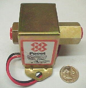

fuel pump should be located on the frame rail under the van.. 15 mins and you are done.
Check the connections at the pump.
a pump might last 50 hours or 5000.
Look for the pump were the tap at the tank starts, follow the hose to the TM. It will be located between the tank and the machine.

I think a new pump will set ya back about $25.00.. it has been awhile since I had to replace mine. I might be on the 5000 hr pump now.
follow the black fuel line where you installed the fuel filter.
It will take you to the pump.
No biggie to change, unless it's in a gawd awful spot to get to.
When you turn the key on, you should be able to hear it run.
If not, check for lose or broken wires first, before you spend a $30 dollar bill at NAPA for an electric fuel pump.
(which is just a generic 12vt elec fuel pump.
It will probably be in a bubble pack hanging on a shelf.
(that's where they're at at my local NAPA

They don't squirt a heck of a lot of pressure either.
4 psi is it
no square or round little box with a red, black and green wire on it?
(about the size of an in-line fuel filter)

The pump will be about the 1.5"x3 inches. hose going in, hose coming out. 2 wires.
It will be on the outside of the tank.

The valve cover mounted Kohler pump is fine for power equipment, but wimpy for pulling gas up from the van's fuel tank instead of pushing from below like most TM's need. It will perform poorly with long fuel lines and vapor-lock prone hot weather conditions.
I promise just about every AutoZone, Advance Auto, Oreilly's, NAPA, Pep Boys, or local parts supplier has the pump pictured earlier in this thread....for about $40.

AutoZone doesn't carry that Facet pump... or one that looks like it.
Advance Auto parts carries a P.O.S. made by, "Mr. Gasket", that has a failure rate of about 33.3%, based upon personal experience.
PepBoys doesn't carry it... at least not the one near me. (I'm not a big Pep Boys fan, anyway...)
NAPA carries it... for $40 to $50, depending upon what store you're in that day, it seems. (Some stores charge more for the lower PSI version, for some reason...) It's made by Facet, but it's black resin... not metallic.
Luckily, I haven't found the need to use any external fuel pump in going on 2 or more years now (I forgot how long ago at the moment...). The Kohler one does fine, if you use 5/16" fuel hose and hose barbs... at least at the lengths I set it up for, which is about 7 feet total, as close as I can educated guesstimate here at the computer.

Get a pump Like I showed you in the pic..
As I recall if the van is fuel injected you need an electric fuel pump.
I had a Kohler 25hp.. The goofy guys installed it without a fuel pump. That lasted about a week.

We bought two for the EZ's almost six years ago at AutoZone, and one for a spare.
One went bad after 3 years, and the other two are still working on the 405's.
AZ may have "chinafied" their lineup since then??
