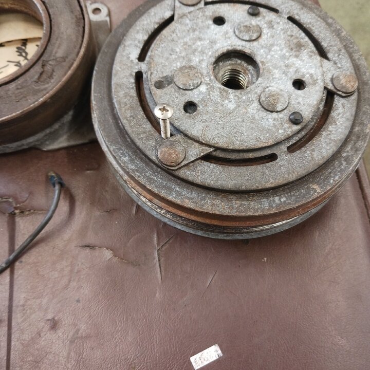

Turns out i have at least 2 pump clutches they each are configured double A belt and fit a Âľ" straight keyed shaft. Haven't measured diameter both are currently mounted on hypro 2340bp pumps if your interested in one make sure shaft size is correct and let me know the diameter of your pulley and we'll go from there. These are my personal spare parts and not "free to good home". However if you want one im willing to part with it. I will test/pull/&ship when you receive it drop a check in the mail for what it's worth to you that'll be the price
Dwain Ray
Jul 22, 2020
630
Thanks Dwain. For the tips and for looking into some old parts for me. I'll get a tap and a short bolt and make my stuck clutch more stuck soon!

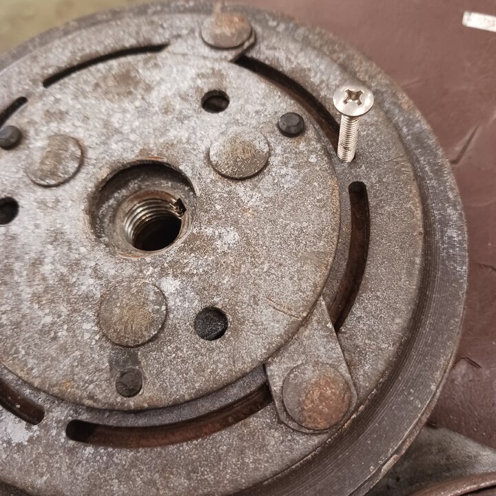

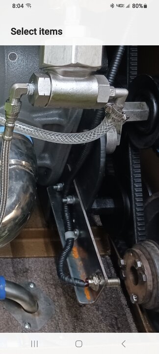

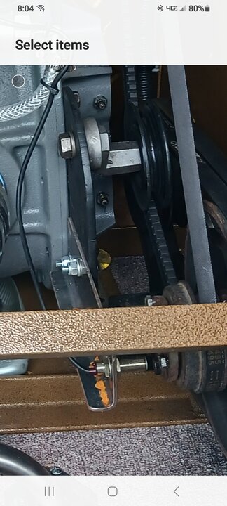

Im sorry, the clutch i drilled out and tapped is an old style obsolete clutch and has alot of space to bolt looks like the only way to do it on a modern style clutch is to remove the magnet and drill and tap inside the 6 grooves and use 8/32 machine screws. I did this 15 years or so ago memory's not what it used to be but with the magnet removed it shouldn't be necessary to tap just run a machine screw thru and put a nylon lock nut on the other end itll spin in the place once occupied with magnet

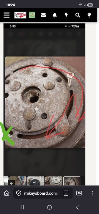

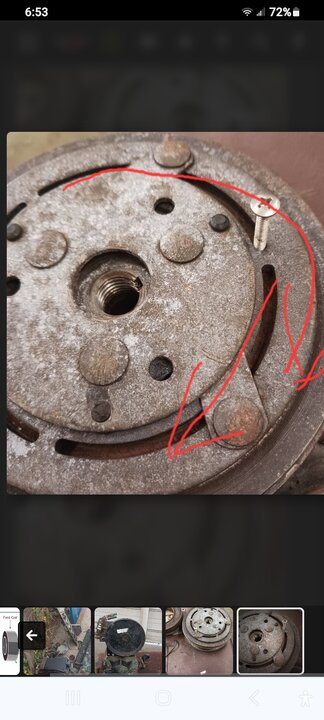

Just make sure that if you use machine screws that you place um where the armature butts up against them rotating see picture and if 1 bolt works 2 will work better
Bryce C
DFW
Feb 9, 2024
1,044
Bryce
Clockwise according to your arrow. I suppose if the armature starts spinning freely and the pulley is spinning clockwise that makes sense. Would the armature possibly drift away from where it butts against the pulley when she comes close to a dead stop, and then nail it real hard upon starting up again? What if we stick one over there too to sort of pinch it both ways?
I was going to post a picture but I still can't post a picture! Argggh!!!
Dwain Ray
Jul 22, 2020
630
You just want the bolt to hold the armature so it cannot slip or move in the picture the bolt is in the proper place for clockwise rotation. If counterclockwise it would be placed on the other side of the metal partition (for lack of better word)
