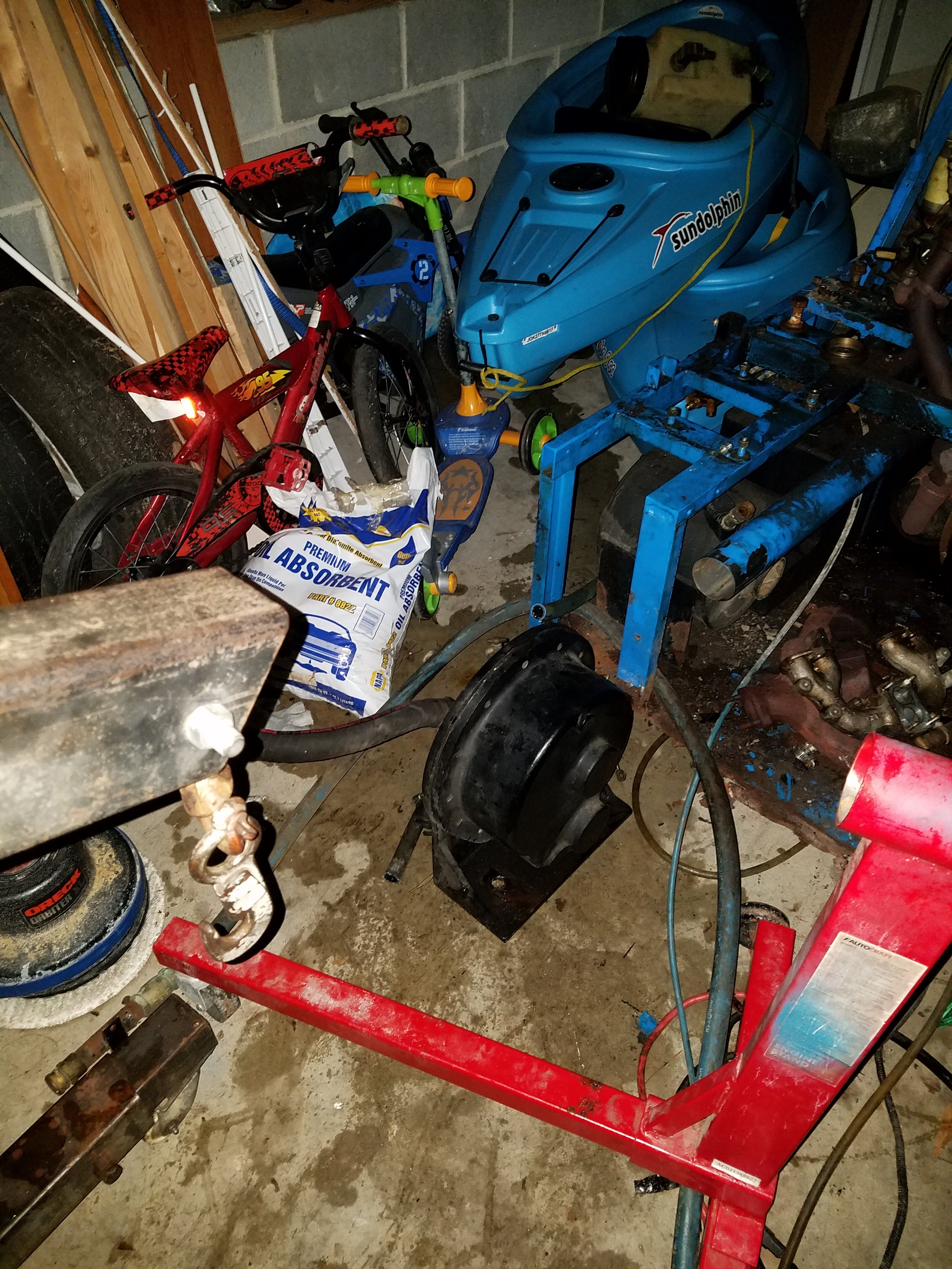

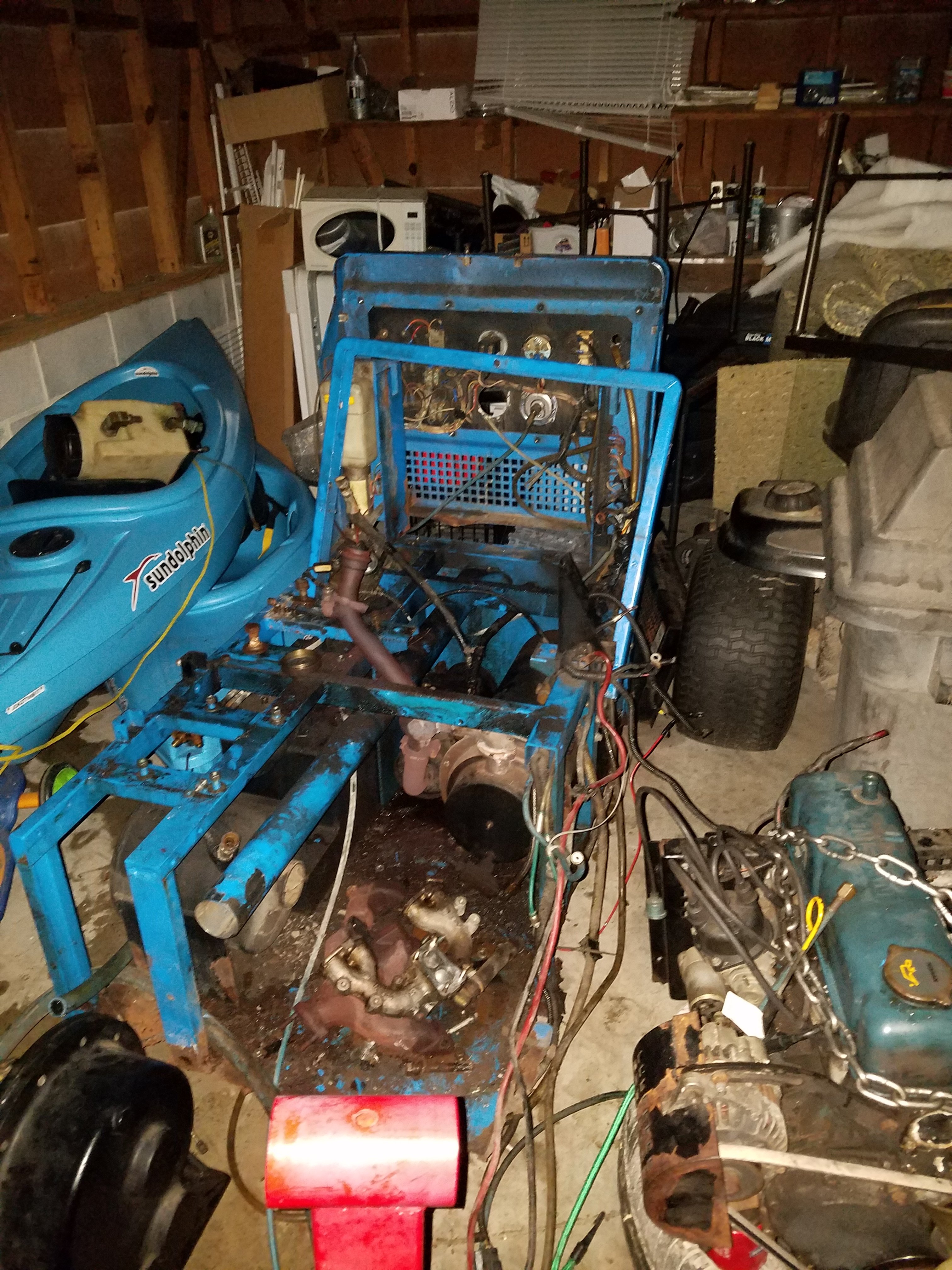

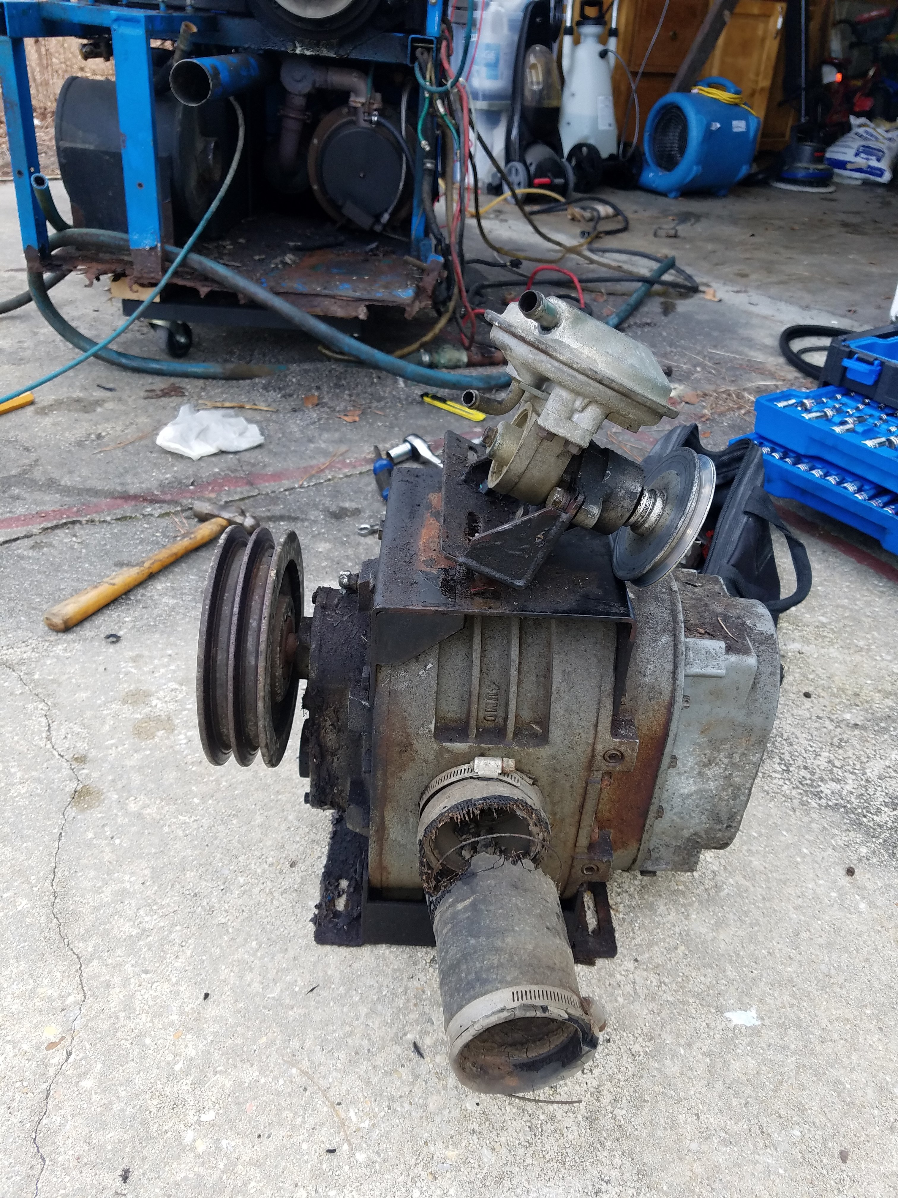

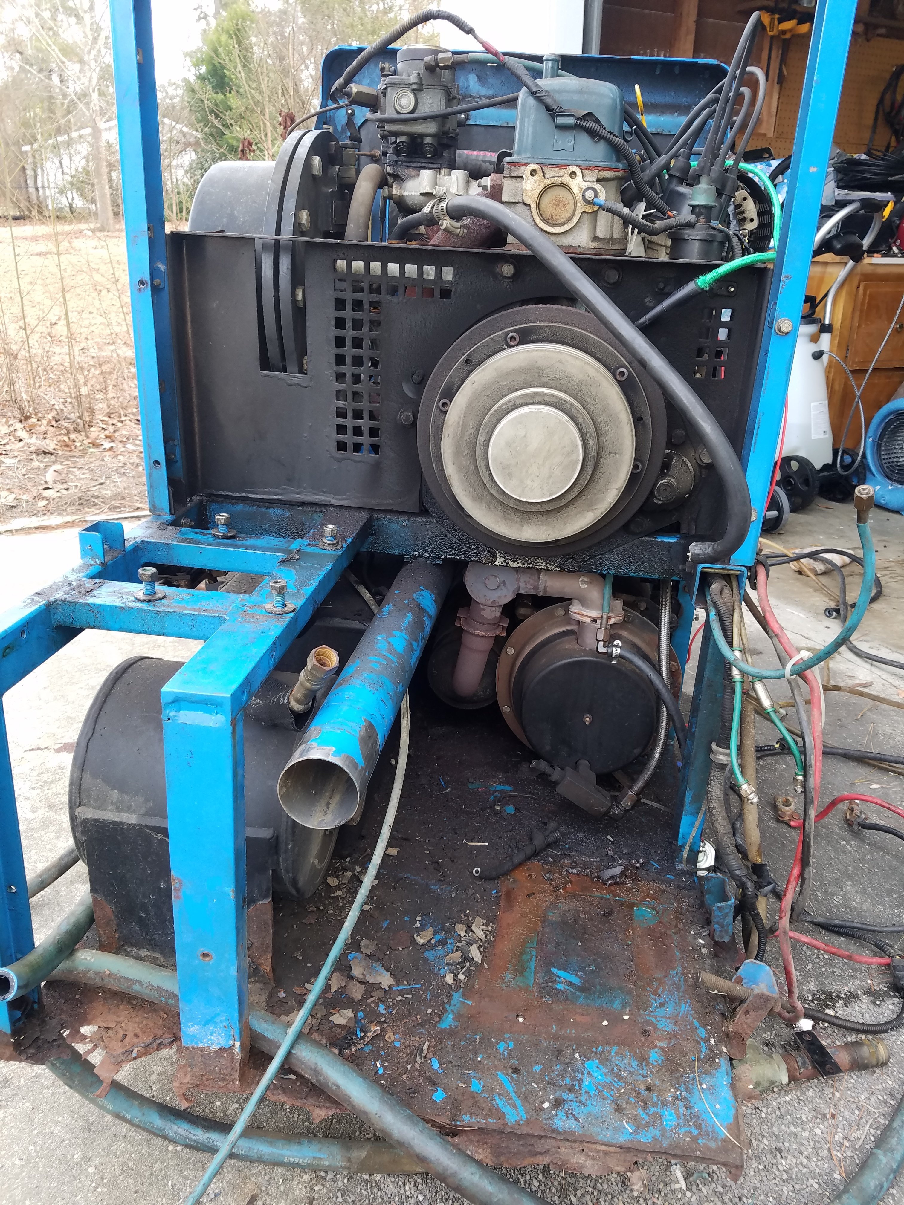

Just an update of where I'm at on this build
