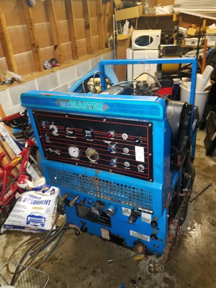

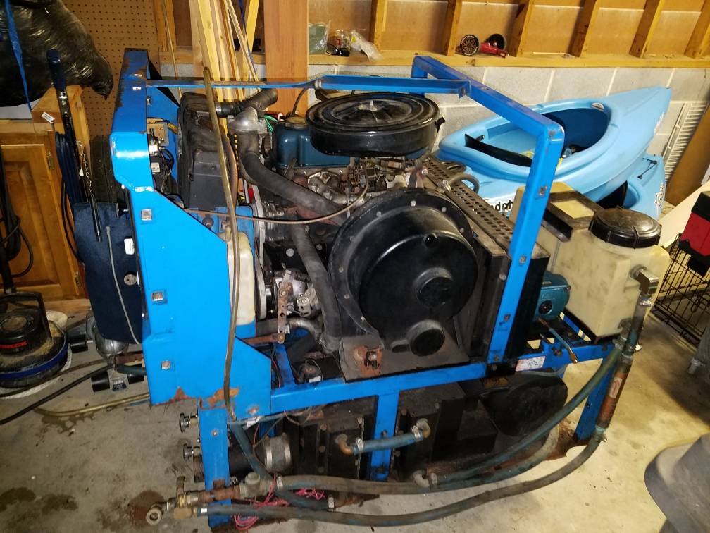

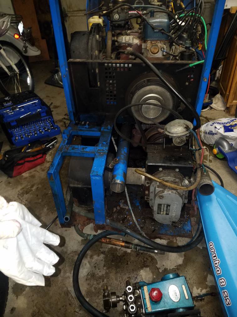

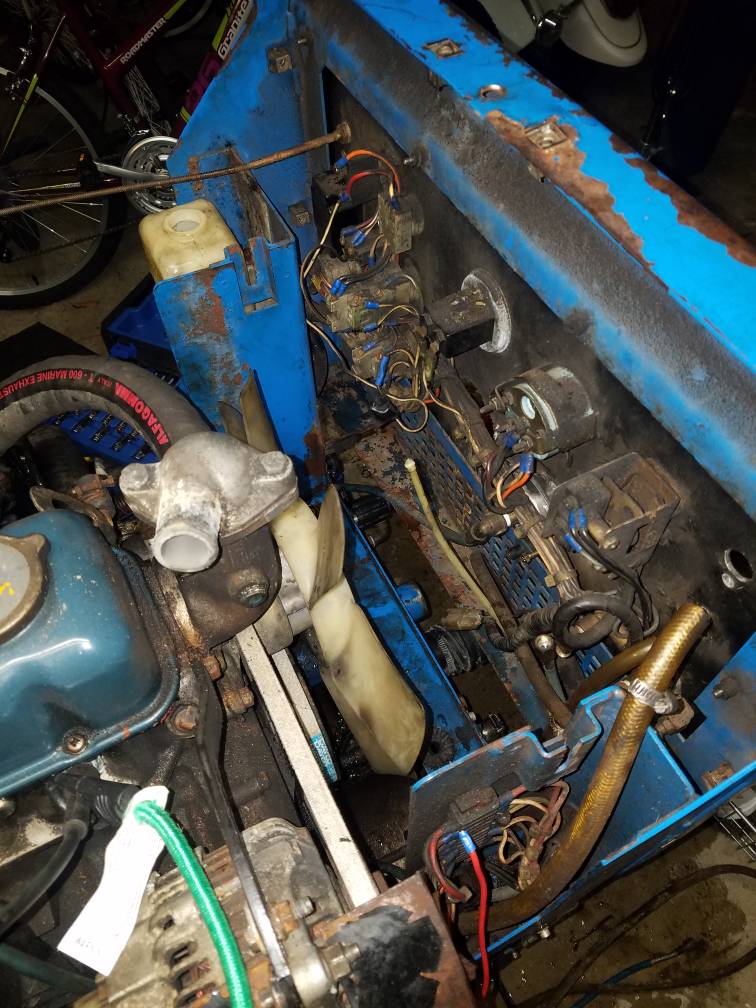

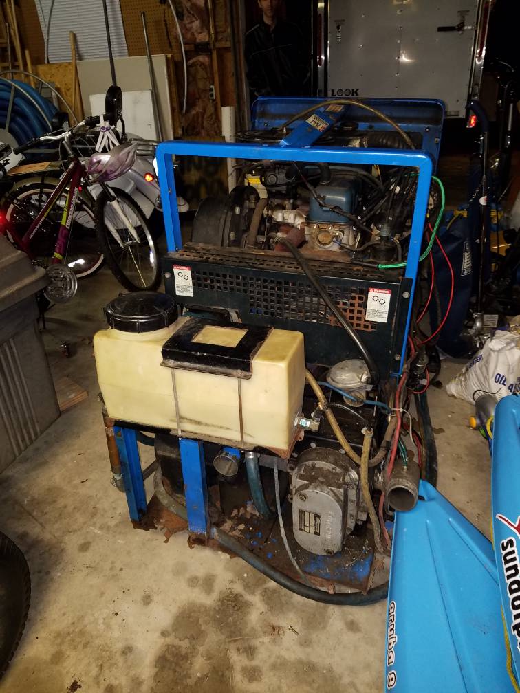

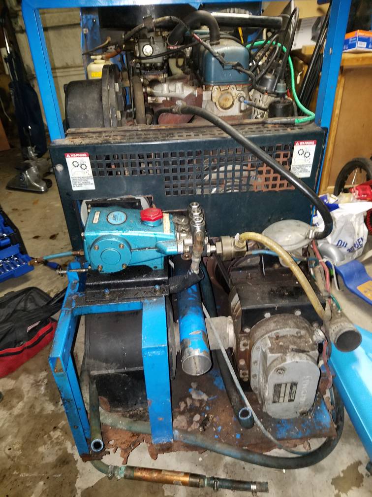

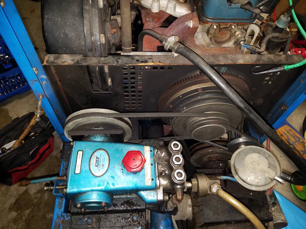

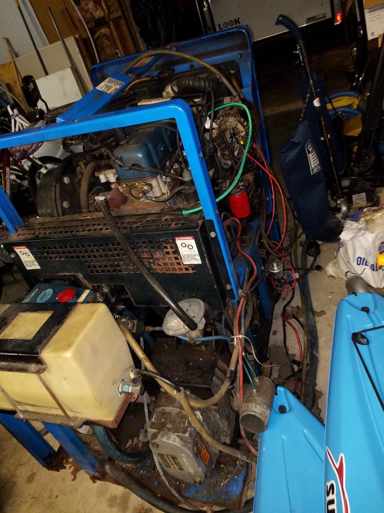

So I've decided to rebuild my Prochem Performer even though it is running just fine. The main reasons for the rebuild is one the frame on the bottom was mostly rusted out. Two everything leaked even though it was all really small leaks it annoyed me. Three that leak was going to slowly rot out my enclosed trailer plywood floor. Plus I'm thinking about doing a few mods to it. We'll see. So just a quick run down I'm doing a full on frame rebuild powder coating the frame, painting the engine block, replacing all deals and gaskets, rebuilding carb, brazing the copper in the heat exchanger or buying copper tubing to recoil heat exchanger (I may put in a different water heater instead of the heat exchangers ). In my enclosed trailer I'm doing diamond plate walls, rubber floor mat for floor and seal wood with a premium wood sealer, interior lights and whatever else I can enhance in there lol. Here's where I'm at so far! I have pics pre tear down. I spent 2 hours tearing down some of it and this is where I'm at now. Chime in with any input or ideas of how to make this machine a beast or just better in general.

Wow. That's a lot of wires, hoses, bells and whistles to run a engine, blower, pump and heat exchanger.
I like things much more simple.
14,087
With a well designed truckmount that Does have wires, and bells and whistles, you soon find out that it’s a economical, powerful machine that’s very safe for a tech to operate And will take some of the labor cost off the job
This truckmount is well worth restoring.

Yep as Matt said benefit is the safety features like oil sensor, heat sensor, water pressure sensor, waste tank sensor, so on so forth which all keep the machine for destroying itself if something is wrong and you're not aware bc your cleaning. All these sensors shut it down to prevent damage but yea I think it could be simplified some or at least cleaned up a bit.

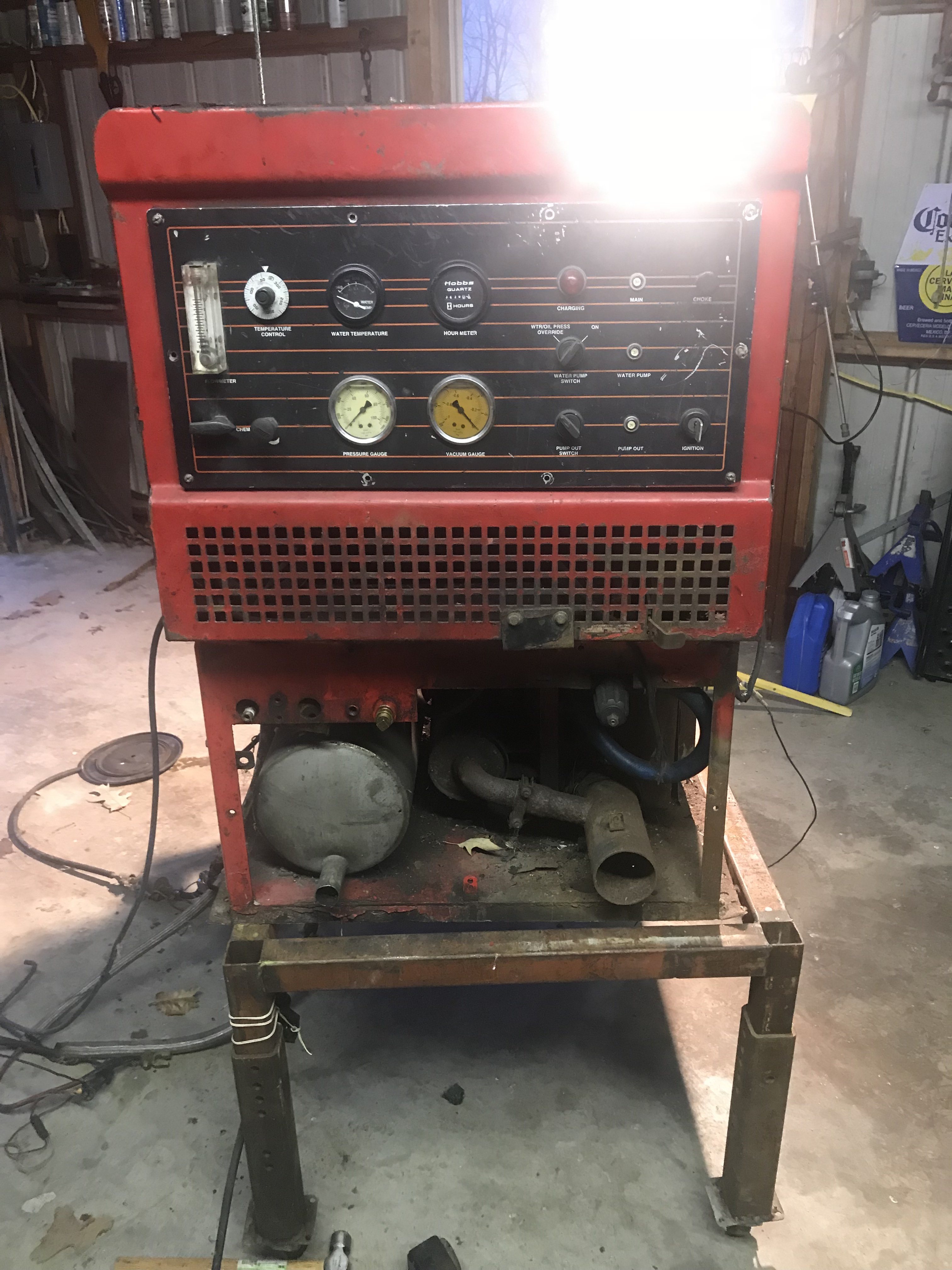

If I had a tip I would recommend building a heavy table to put it on. I’m rebuilding a 405 right now and having it up off the ground is great. Also I’ve done a couple replacements of the base on 405s. I’ll dig up some pictures.

That would be great! Luckily I have an engine stand to mount the motor up to while I go through it but dag on if the blower and other parts aren't heavy as well lol. I'm thinking of upgrading to the 405 blower for the better suction. Also considering going up to a 2000 or more psi pump because I feel 1000 psi is under powered for what the motor can handle?

Your heat exchanger are only rated at around 1200psi. So a higher psi is not an option. You can make a cold water circuit that bypasses the HX.
You would also have to change out the unloader to got that route. Also I don’t think the silencer is the same on 405 models. I might be wrong on that. Dad has a non 405 performer in his shop so I’ll check.​
