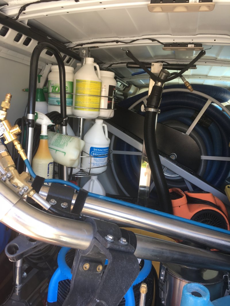

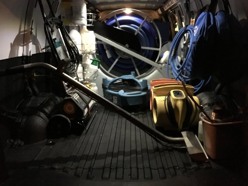

Tool box, rags, tarps, sealadoor, flat mops, multi sprayer, takes..
Where do they go?

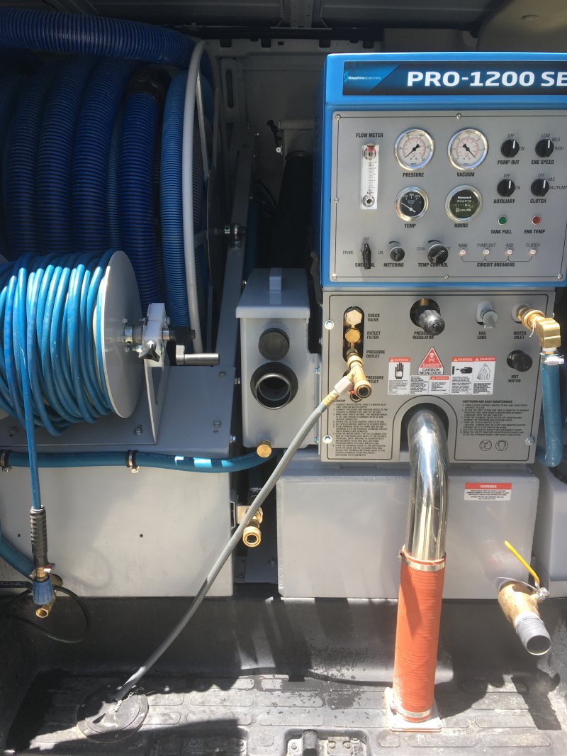

Tarps on dash, I use a hydroforce it's in a bucket. Rags and excessories in a plastic container. I don't carry a multi sprayer I have one but barely use it. Rakes behind real with grout brush. I hung the spinner above waste tank.
I'm setting this up for my guys no flat mop.

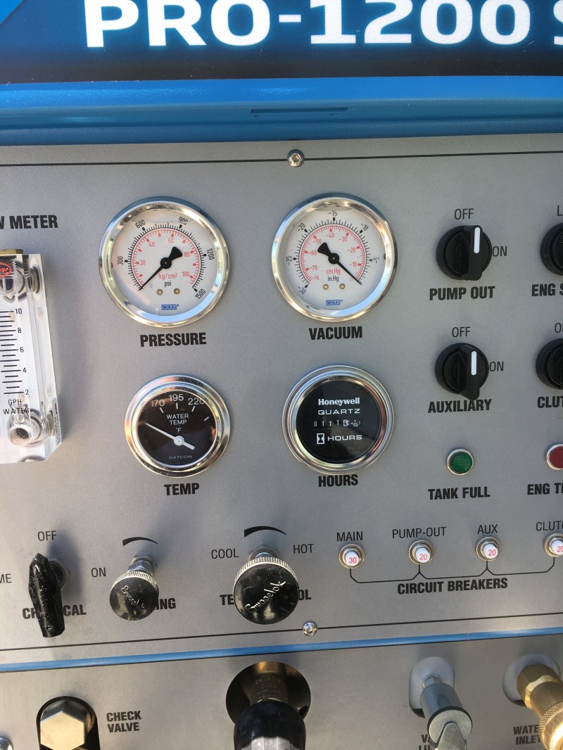

K so I bumped up the lift so it stays between 12-13, if I want it higher I'll have to add more washers.
But on high it hits about 220 consistently and the hose gets hot.
medium about 195-220.
Feels like it has more vacuum then the 570
On high.
