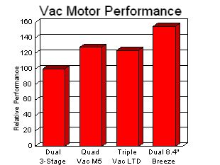

This is what a REAL Mytee modified portable delivers @ sealed suction:
15.61 in hg . . .
Also have performance on the carpet in these graphs :
More info at our web page:

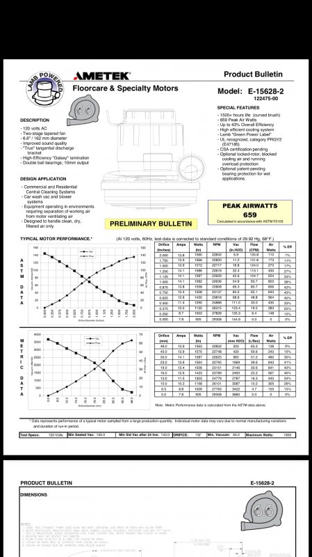

Ametek's data sheet for the 116765 lists a sealed vac of 136" wc, so two in series (using the 60% rule):
136 X 1.6 = 217.6
Yup, Sams number for the two vacs in series matches just about exactly with the predicted value. Ain't science wonderful! :biggrin:
D
dwellpro
High lift equals low cfm. You can't suck a basketball through a straw.
CFM testing is a lot more difficult to test for than waterlift / sealed suction. The easy way is to just measure the amp draw on the motor under operation (no hose, hose, with wand etc, your choice) then compare the amp draw to the data sheet (attached), read over to Lift or CFM and you are in the ballpark, probably within + or - 2% worse case. If the motors are in air parallel you are dead on, two motor CFM.(2 x 115 CFM= 230CFM) if in air series use only one motor CFM. Since I am at elevation, at 8000feet, the air density is way lower so I will have variations in flow, the motor speed will increase slight so the CFM will be higher.
