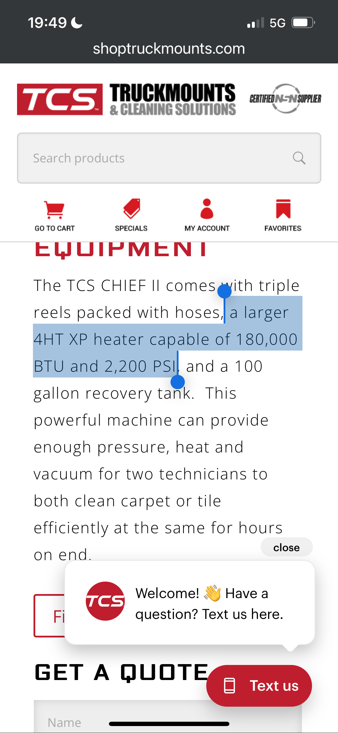

Looks like the 180,ooo BTU heater comes with the Chief 2. Is the heater external from the unit, or is it housed within the unit (ie: enclosed within what's shown in the image of the link provided)?
If I go with this unit, in addition to what's listed, I will need a propane tank and I should be good to go, right?
Finally, to confirm, the Chief 2 will be able to comfortably do carpet, tile/grout, and water extraction with ease? Or will it still struggle?
Edit: I can't seem to find any information on PSI for the Chief II??

The pump is capable of 2000psi....which you won't need
I believe the 4ht extreme is included which is also good to 2000 psi.
You would be able to high pressure clean with heat
The heater is external to the unit

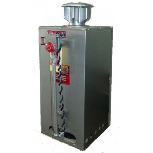

TCS heaters have a max pressure capacity of 800 psi.
Chief II has a 4ht “extreme”
4ht comes in high pressure 1000psi and extreme 2000psi
Looks like the 3ht has that option too
Reactions: alexcarpets

I will be looking at going with the "extreme" if I go with this unit. That said I have two questions:
1) First question sounds dumb, but it's a genuine question for someone new to the industry. The previous poster mentioned 800 psi's as the maximum pressure capacity of the heater. Does the heater not heat the water up, only? Or does it have a dual function of heating the water, and pressuring is it to go down the hose and to the wand?
2) The second question is with respect to the "Little Giant" Heater. It mentions, "3.75 GPM (60° Rise)1.87 GPM (120° Rise)". That would mean that standard garden hose water going into the tank, and then through the heater, with an initial temperature of 50F, would only get up to 110F (@ 3.75 gpm) and 170F (@ 1.87 gpm). Is that the temperature going down to the wand? That seems really low. I think I may have missed a step, or have misunderstood the concept?
Thanks,
Thanks,
1. The heater only heats the water but the coils/plumbing are rated to 2000 psi
2. The 4ht has plenty of heat. You are going to be using much closer to 1.25 gpm than 3.75 . And that is constant flow which you will seldom use. In normal use you will get higher temps up to the high temp limit of the heater.
Keep in mind that heat exchangers also suffer this drop as flow is increased to constant

Ah! The gpm flow was an oversight on my part. That said, even with a 1.25gpm that only brings the temperature calculation up to 170 F, which seems really low.
Again that is not the max temp. That is the temp rise at a continuous flow rate.
