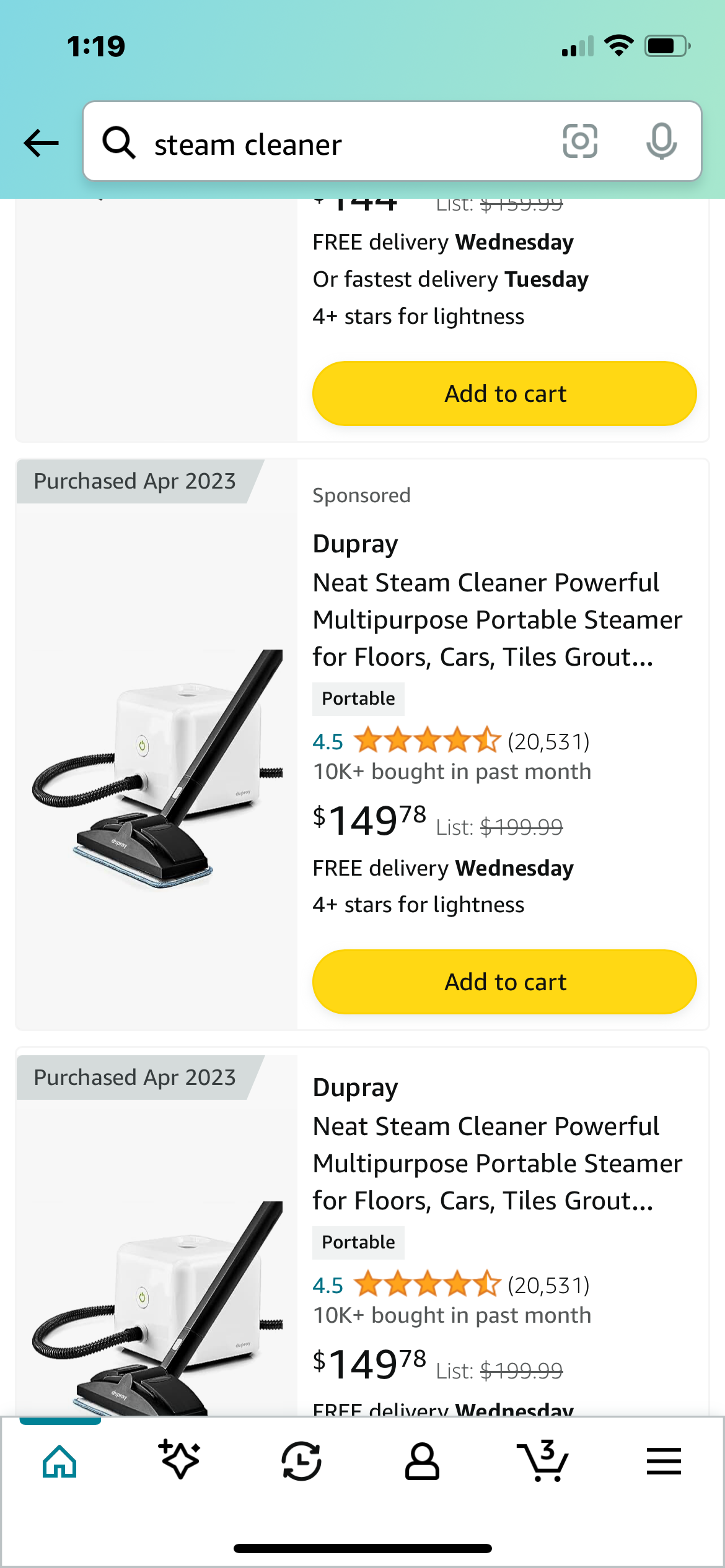

It’s almost always a good investment to start out with a TM if you can swing it, but if you have to start small then go with the standard 500 psi portable and pick up a small steam machine to help with grout.
The flat mop head shown in the picture is worthless but it comes with a good grout tool.

There are lots of ways to clean tile rather than blasting it with high pressure. You can pick up a floor machine used for $150-$500. Scrub a tile floor with it, use a pole brush for stubborn grout staining, then rinse with a hard surface tool. A truck mount is much easier to use for residential but you have to factor in the cost.
