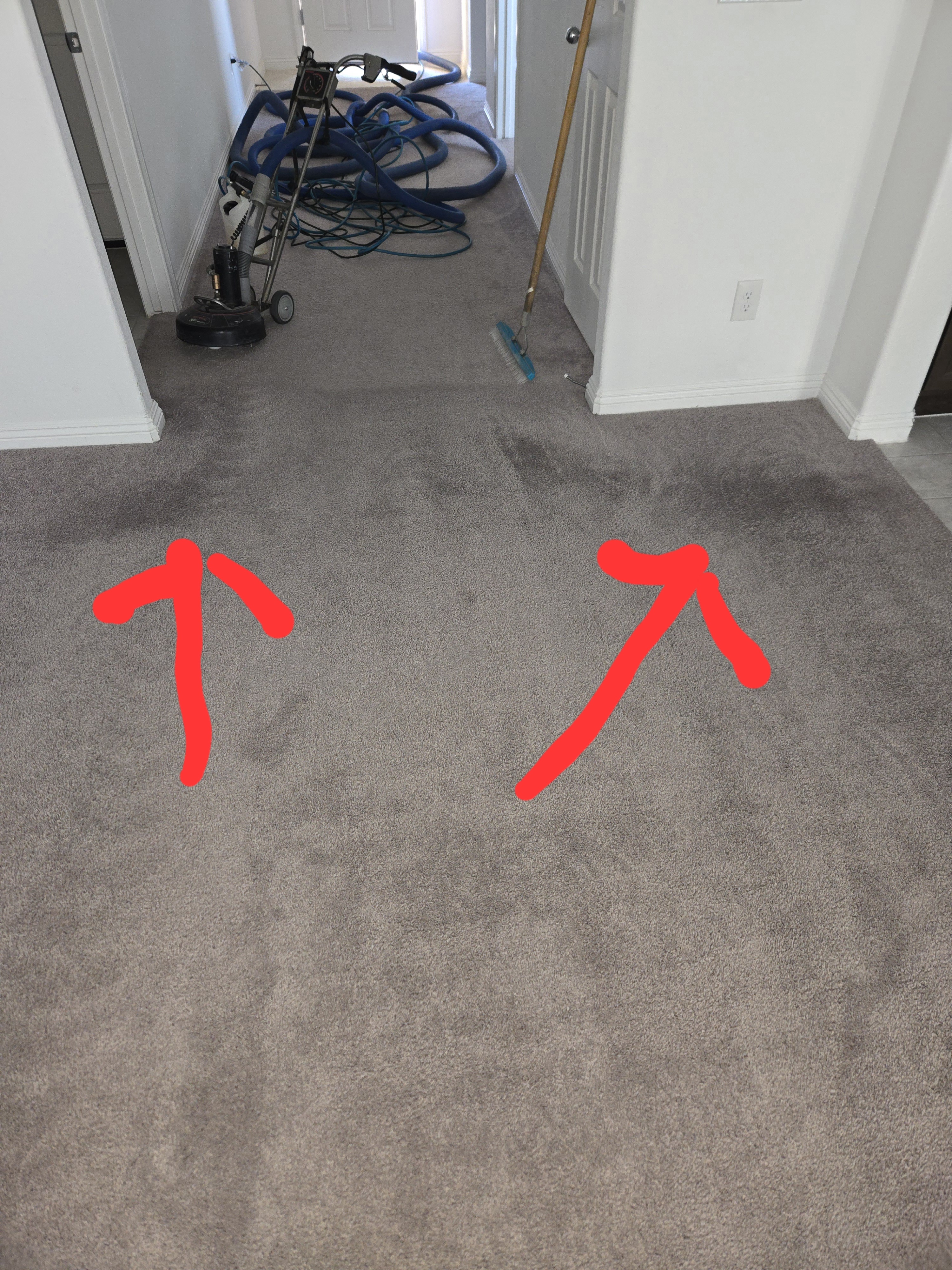

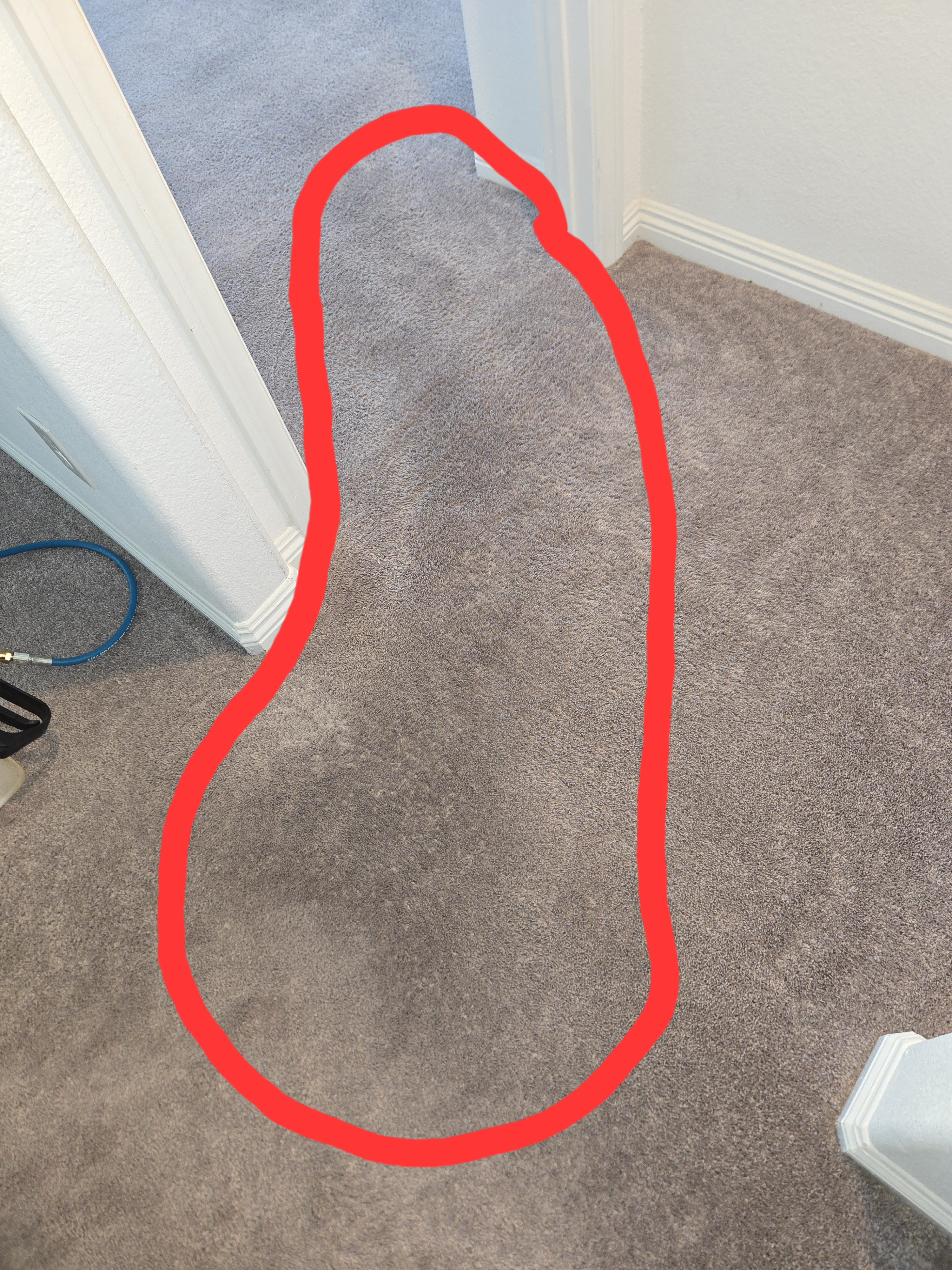

This looks like crap, all these housing tracks in my town have this crappy polyester carpet, a customer showed me a carpet upgrade and it was just a thicker polyester. šŸ™„ Has anyone used "Boost All"? My former Aramsco rep. told me to use it? I haven't yet...(I think it's just wearing and shading different.)

I would say about 10 years? Usually works great for me, I use a little Prochem Power Solvent for tough spots, but normally Flex, RotoVac 360i standard 3 jet head, brush head if it's really soiled, 400-500 psi, and full heat on the Prochem Apex...it's just these 2 housing tracks with polyester that I'm unable to get these dark pathways to blend? Nothing I try on it does anything? Thinking the fiber is just breaking down and I'm seeing wear shading? šŸ¤·ā€ā™‚ļø Just frustrating because it looks like I left it dirty....

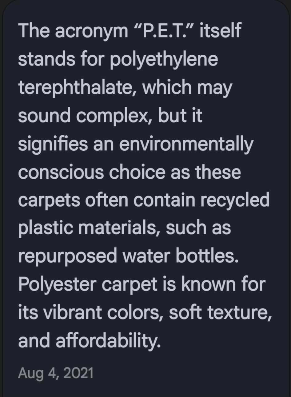

This polyester carpet is a good option for the homebuilder, as it's cheaper in price, but since the carpet is made from recycled plastic, it's not holding up very well. I remember my teacher at my IICRC class telling us not to purchase "Green Products". I'd say don't purchase green, recycled carpet either....

Most likey, it’s not a prespray issue. There’s a thousand good prespray products and he’s probably already using one. In my experience, if a Rotovac with a brush head doesn’t solve the issue, then it’s time to replace the carpet.

Sometimes dinge away from cti and fill scratches and brighten worn carpet.
But when the fiber untwists and looses density.
Or has pile reversal, there's not much you can do.
