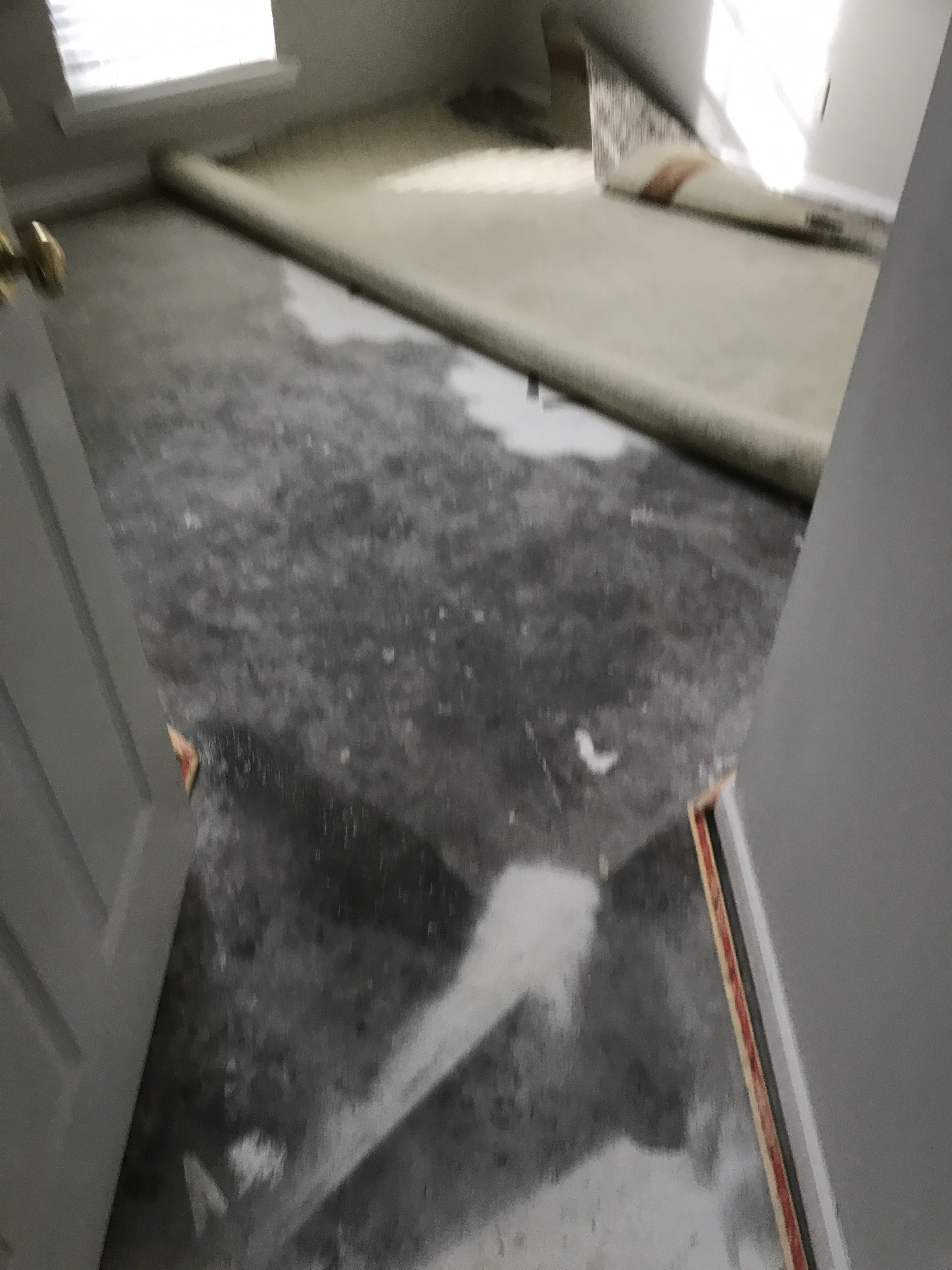

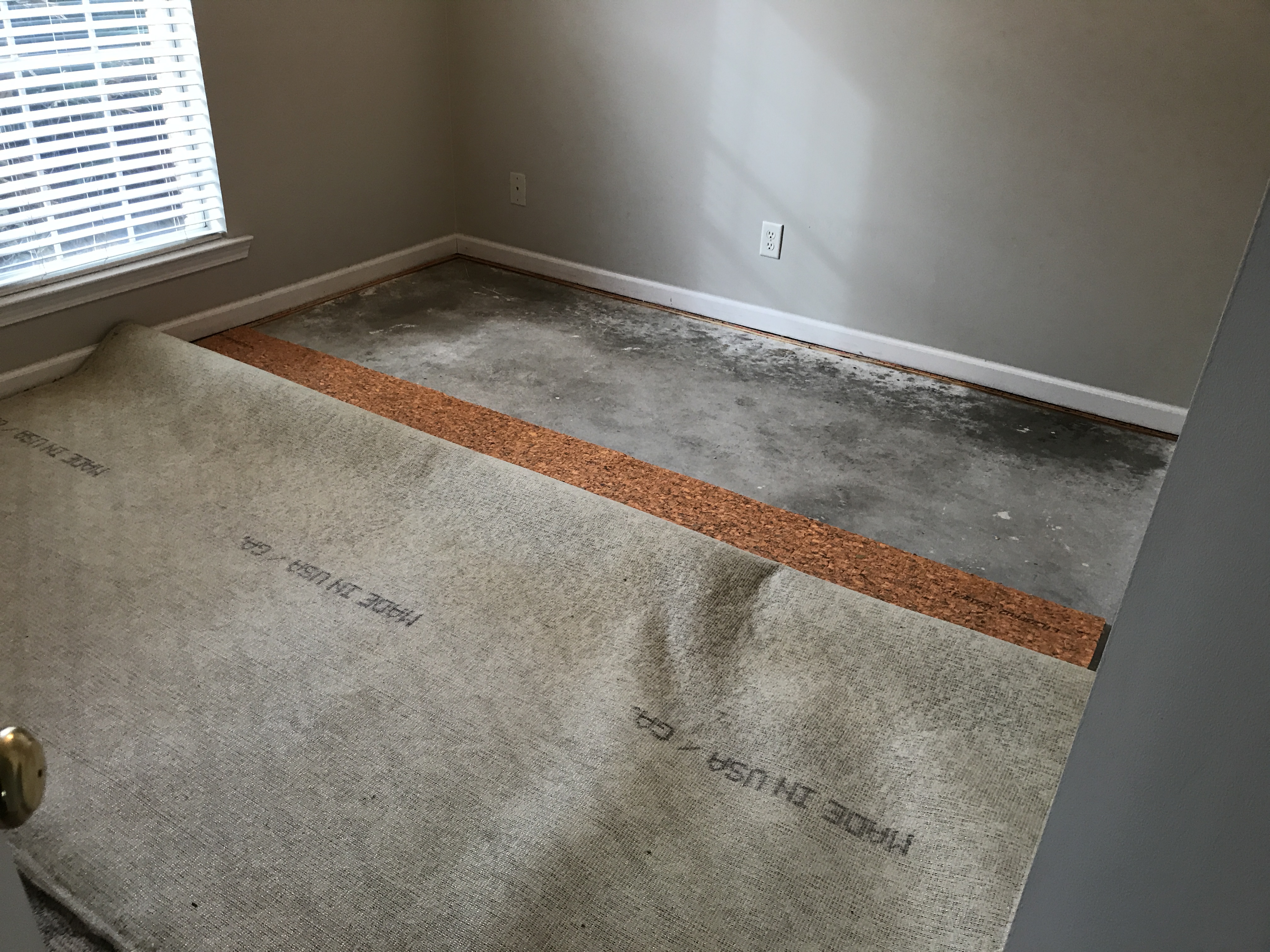

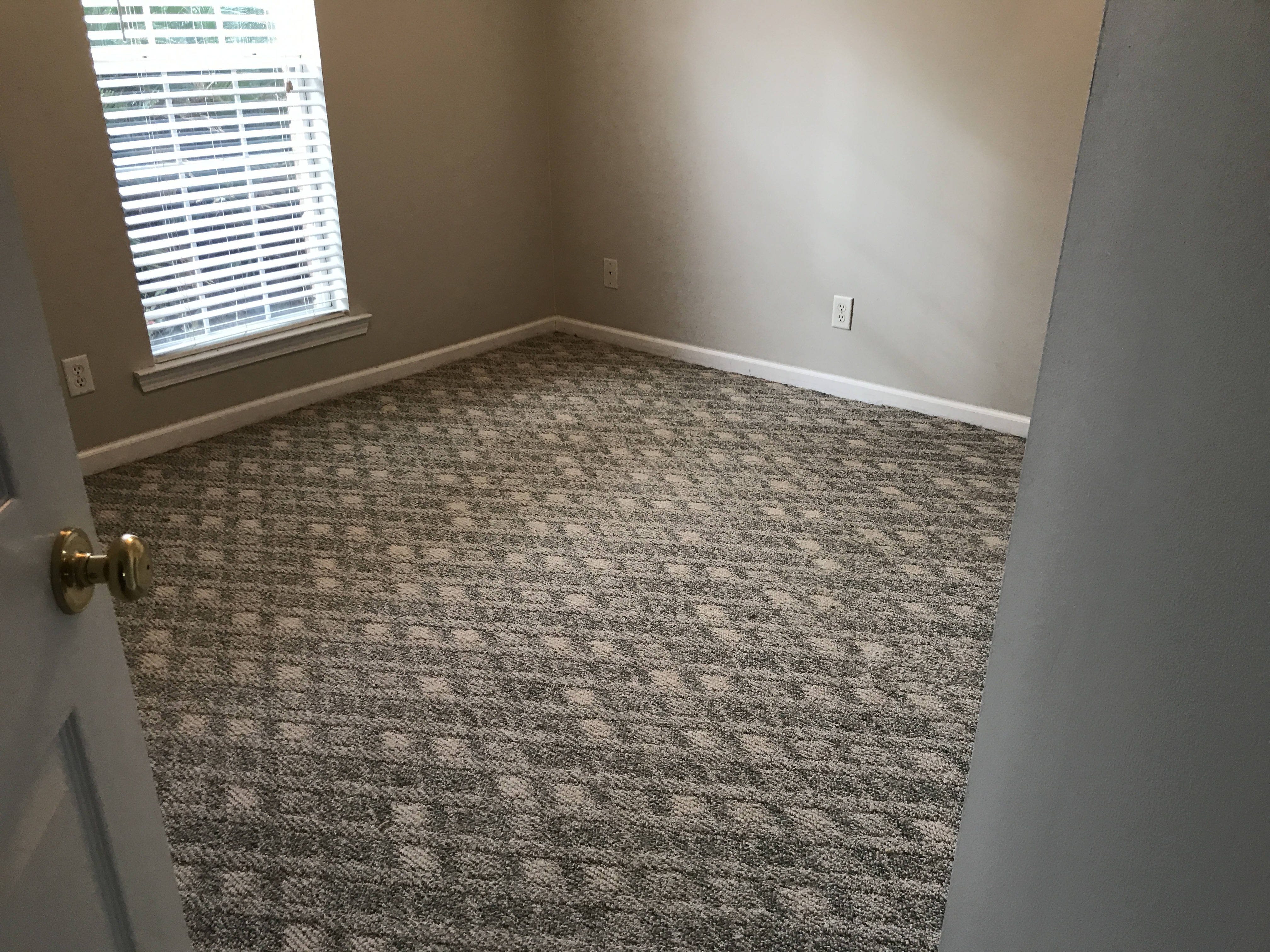

I had to flood clean a cat piss bedroom today. Came out beautifully.
