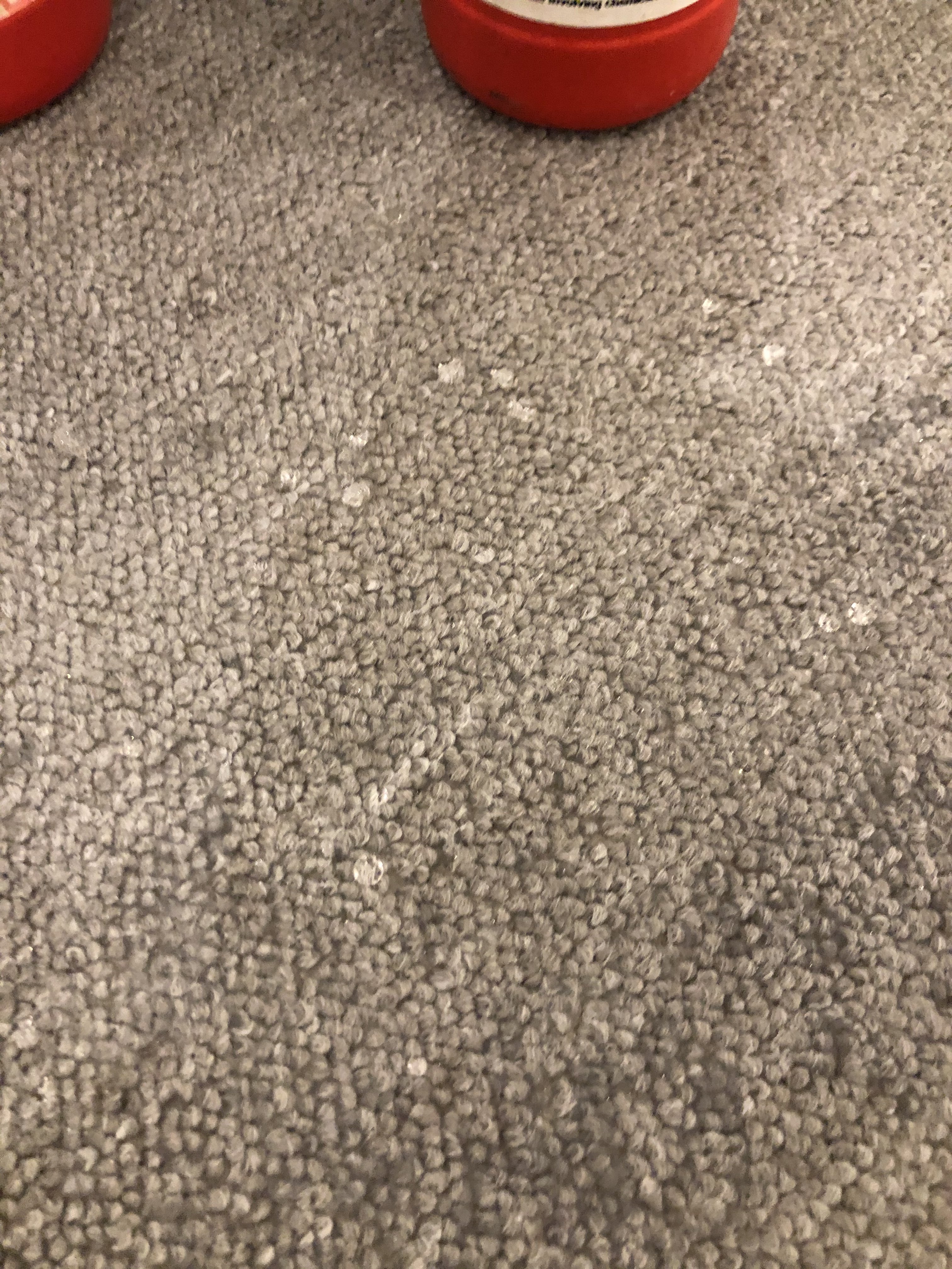

Hard to see but this carpet was rinsed with clean and protect and there was noticeable water heading from pre spray and rinse again.
Maybe buy a gallon and test before you say stuff is misleading or doesn’t work.
making bad judgements can cost you credibility.
But good testing and not theory can establish reliable judgements.
Reactions: Lee Stockwell
11,570
Now go drop some water on an uncleaned area....
We cleaned it all yesterday, I was surprised it was beading you.
my guy dragged a wheel chair and possible burned the carpet I was trying to get the line out. But there was definite beading so it does have protective qualities.
