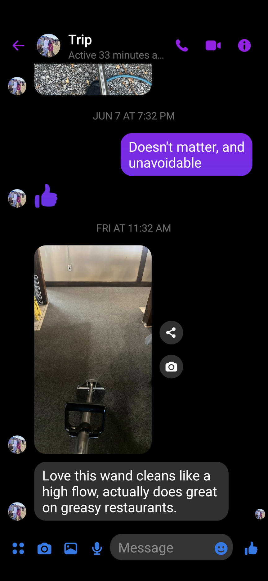

You were very specific on how many turns I needed to spin on it and I followed your directions. I can’t remember how many

THIS IS NOT ME. THIS IS A DIFFERENT TRIP. I DO NOT DO RESTAURANTS. I AM A HIGH END HACK.
28,277
I normally don't do restaurants either but I have a club coming up. I would prefer to use the truck mount but the last guy who did got shut down because of the noise. Can only do it late at night or early in the morning. So encap it will be. The good thing is, it's all carpet tiles and they vacuum every evening. We'll see how it does.
