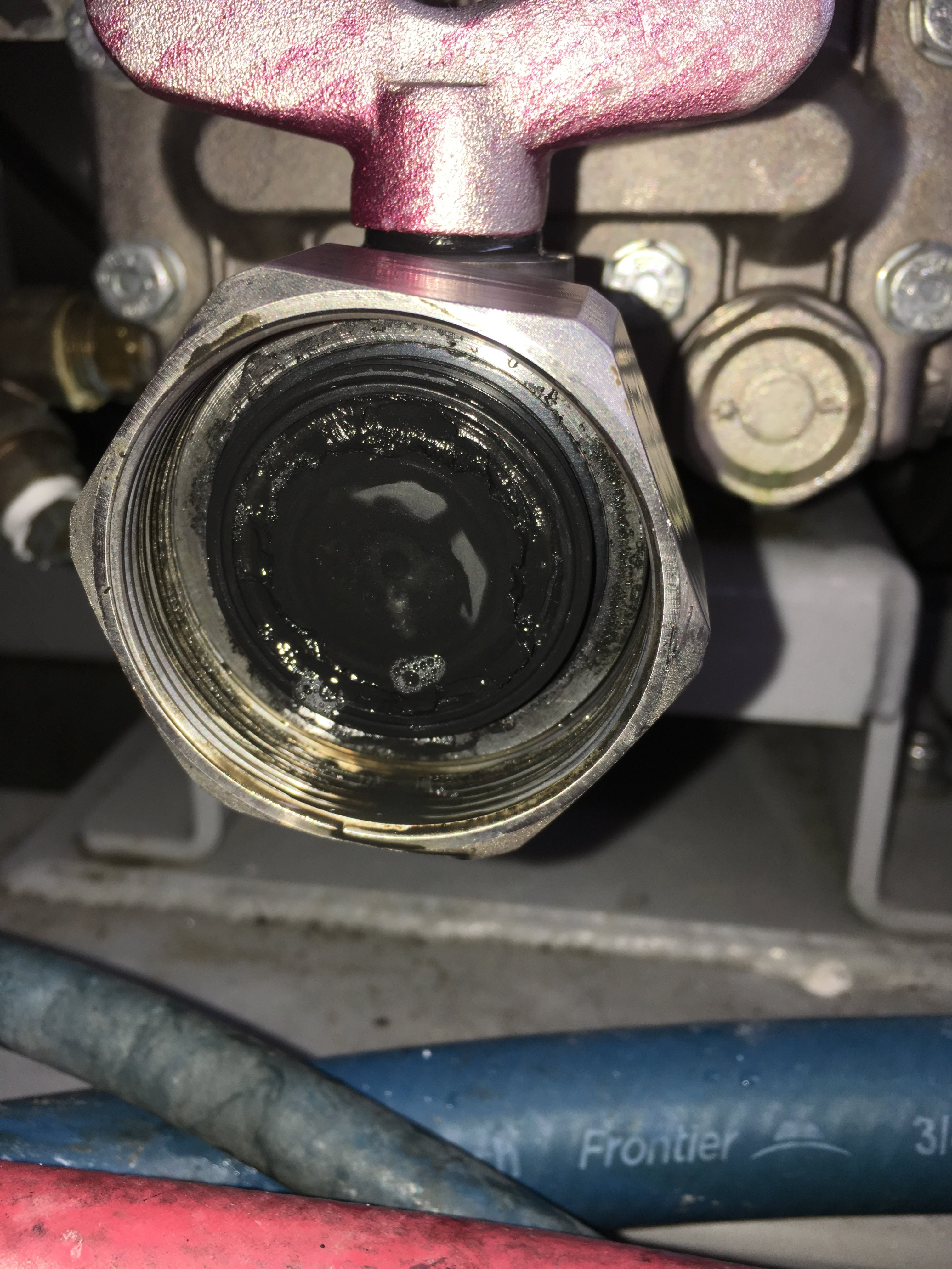

Looks like the O Ring on the high pressure side is chewed up. I’ll flip it around and get through this job.

Sweet.....thats like the check valves being stuck open..its allowing it to blow by and not building pressure..

@Jim Martin, after looking at the diagram you posted, I am missing one Oring completely. The low pressure side is totally dissolved. Glad I bought a few extras. This was my first time getting into one of these pumps. I appreciate the help.

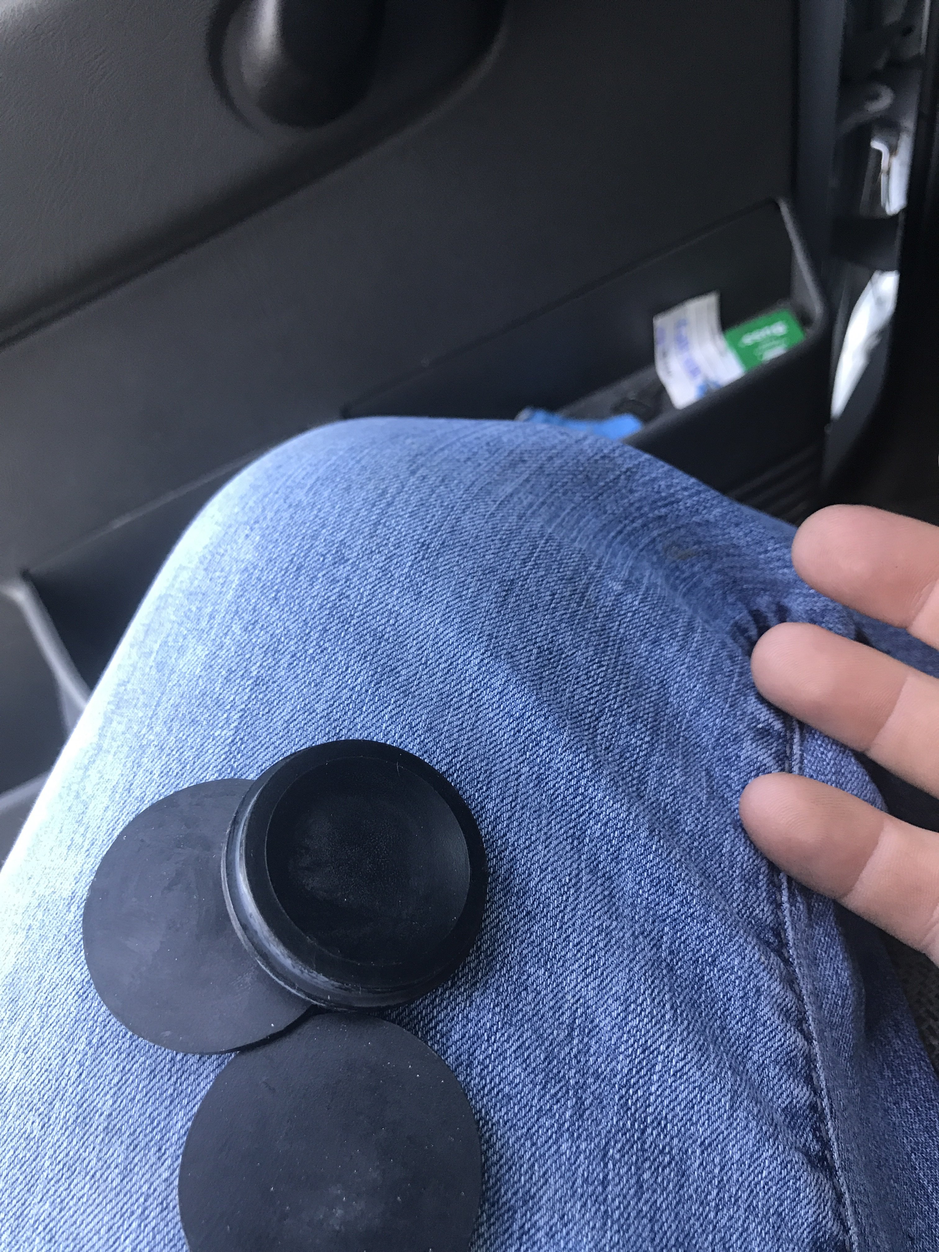

Damn guys. I decided to check my diaphragm tonsee how it looks. It looked a little roaches and about to go out. I got 1400 hours out of this thing so I can’t complain. Glad I ordered a new one last night. It’s still working but looks like it could give up any minute.
24,044
I put it back together and now its not working again! Ugh! I think I also crushed a check valve plastic housing when putting it back together. I think they are okay because they passed the suck test. Going to see if I can get new parts today.
24,044
I just ordered a check valve kit. $34 and $22 two-day shipping. My local guy only has the diaphragm without the lip. I'm going to try tha until my new one arrives. I should have never taken it apart to check it!
