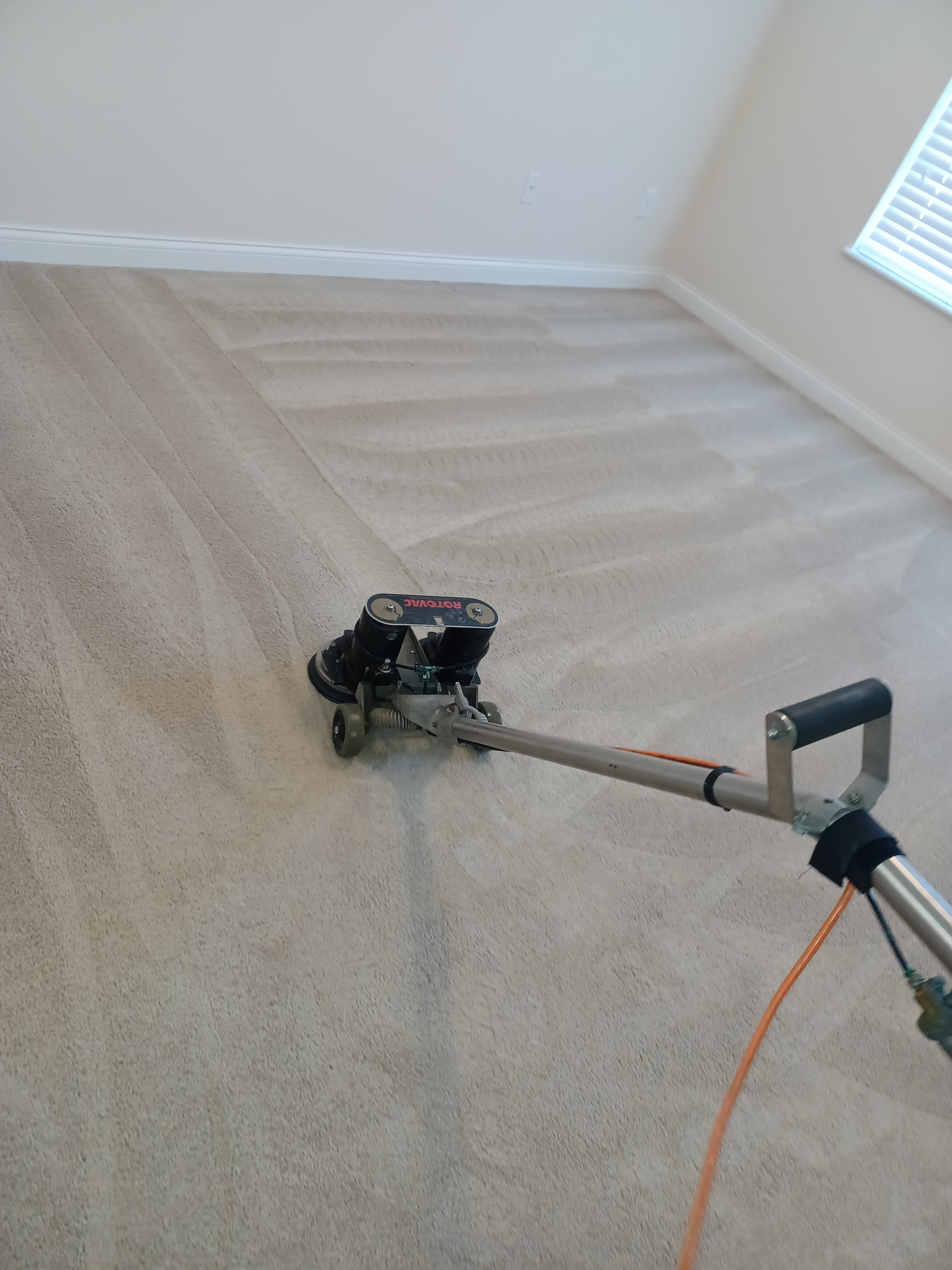

My vlm tool!!! Sorry could not resist:stir:

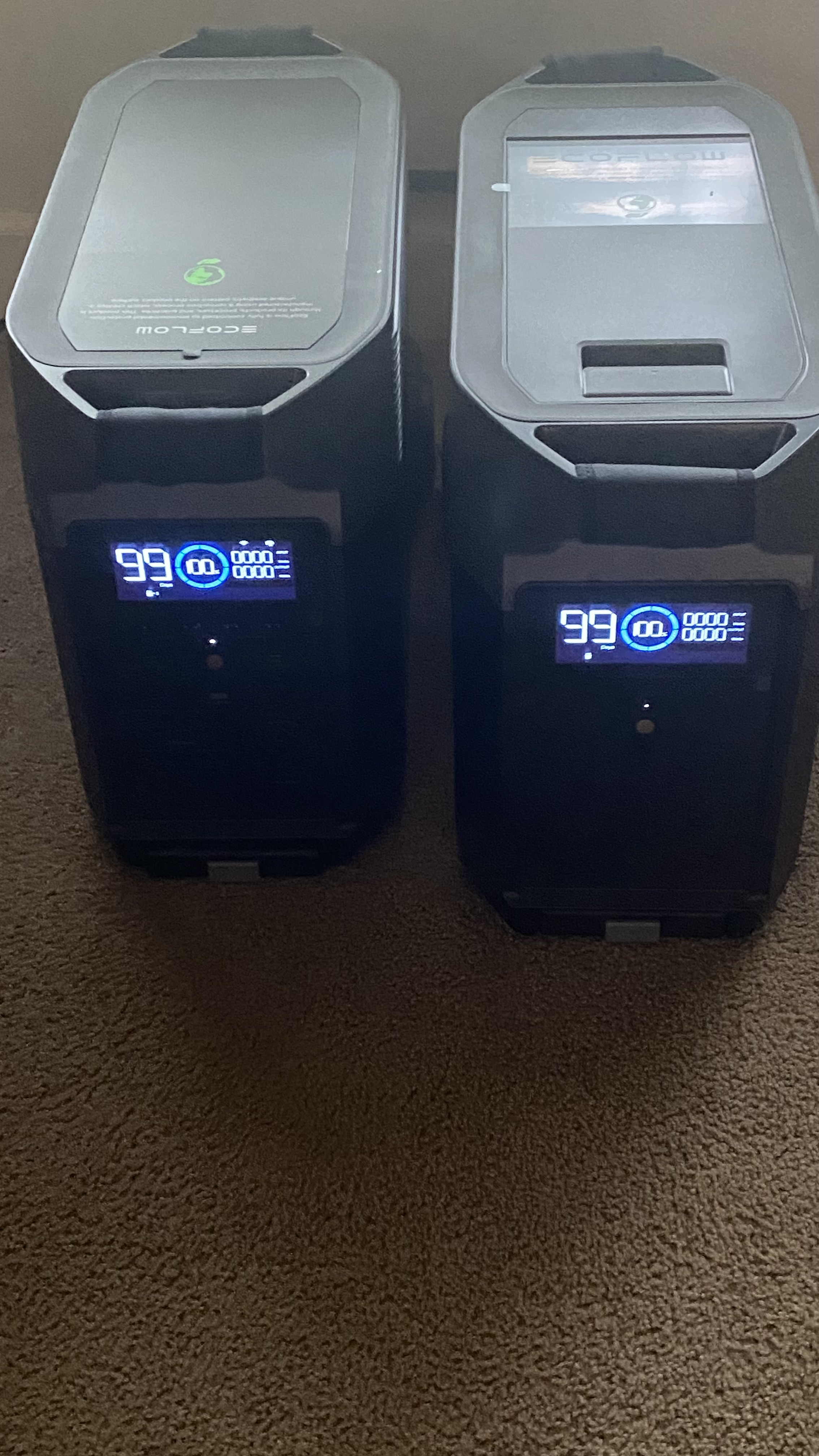

So, if you used one of these power units, how long could you run a Pad Machine on one charge? It could be a viable option in situations where power has been shut off.
I have something like 7.6kwh with that unit so probably all day if needed. Maybe more.
I might have this f'd up, but if you were using something like a Phoenix that draws 5.5 amps and 660 watts an hour. You would get approximately 37 minutes from a Yeti Goal Zero 400.

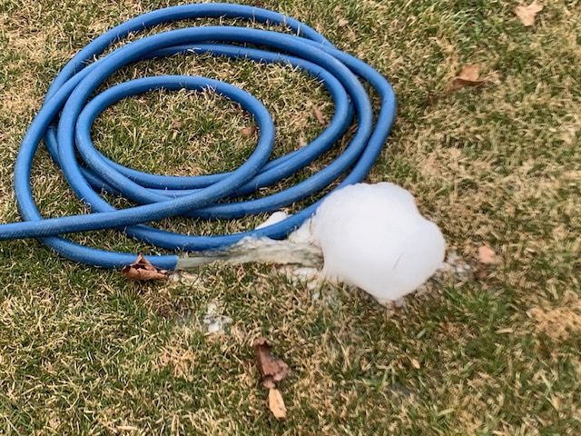

VLM removes soil as do all carpet cleaning methods. What I do need convincing on is what they leave behind.
The way I clean with HWE is very similar to washing your clothes. Wash cycle/Agitation/rinse cycle. Apply cleaning agent, CRB, rinse with water and groom. With the CRB doing most of the work, I can reduce the amount of cleaning agent and water pressure.
So when I clean for a repeat customer. At any point, I can remove the hose cuff off my wand and I will see just water inside the hose, extremely little or no white (cleaning agent).
Today I cleaned for a past customer that I used to clean annually. Last year she tried a VLM cleaner. She said it looked good at first but then kinda *dulled out*. When I started cleaning I noticed a slight reduction of suction, so I take off my cuff and see lots of white (cleaning agent) so much so in fact that from that point on I just presprayed water because there was enough cleaning agent in the carpet from the VLM that I just needed to activate it.
Pictures say a thousand words. Again, all I presprayed was plain, softened water.
