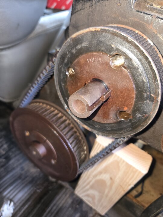

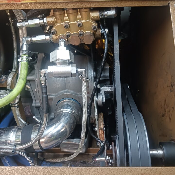

It was just stuck like hell. On another note I heard a pop when I was putting the new blower mounting bolt in to replace the one that sheared off. I'm really really hoping it was just the bottle jack shifting when pressure was taken off of it as I tightened the new mounting bolt to the blower. I'll find out tomorrow morning.

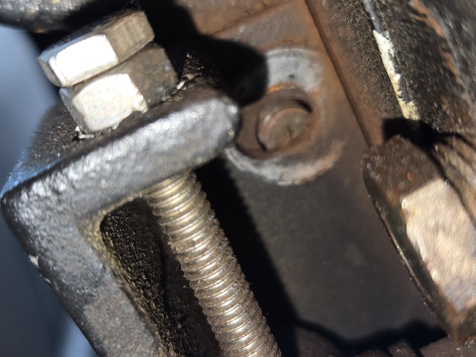

I take it you got the old broken bolt out ok? I need better pics of the pulley and brand name?? All my machines have browning pulleys with them the 2 bolts that tighten are used to to remove ( open holes to tighten threded to remove )
17522851254224000643885556067412.jpg 17522851797355647080666731939762.jpg 17522852408263238859085426810309.jpg
View attachment 131697 View attachment 131698 View attachment 131699
I did get the sheared bolt out! I propped the blower up with a small bottle jack and the bolt came out pretty easily. Nice pulley, mine is stupid, there are 3 holes total, and only 1 hole to thread a grub screw in to pop the pulley off. If there were 2 removal holes on opposing sides I imagine going back and forth a few times would make it come off like a breeze.
If you can't get the pulley off, and you can't adjust the tension in enough to get the belt on. Can you loosen / remove mounting bracket bolts enough to get the belt on?? How about loosening the 4 jackshaft bolts and leave the blower stationary and move the driveshaft in enough to get the belt on. If there's not enough threds on the driveshaft bolts to allow it to move enough to install the belt , maybe remove the bolts 1 at a time and temporarily replace with longer ones to keep everything together while replacing the belt then tighten up and reinstall the original bolts one at a time ???now another thought are you attempting these repairs with the driver and passenger seats still in the van???
