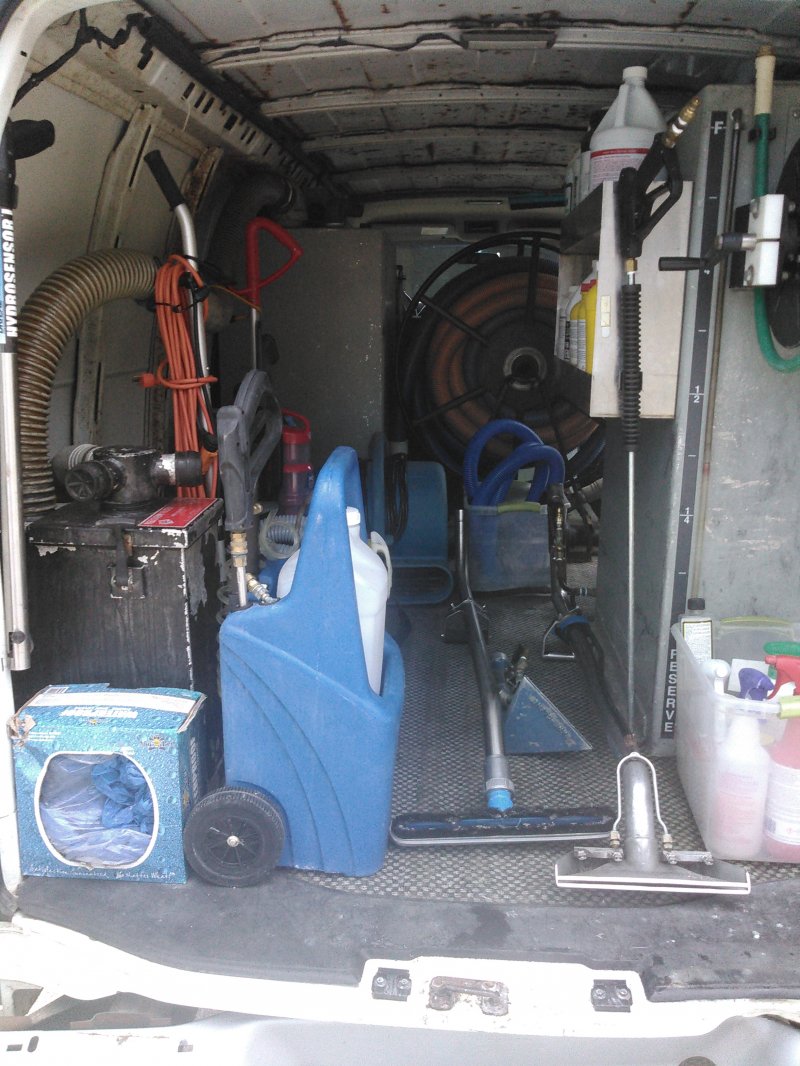

My 2002 white magic
Sounds like it's the clutch. I'm going to take it in and have some other things looked at too. Maybe I'll look vawter up while I'm there.

My first slide in was a WM pro 1700 but wasn't very magic. The filter box always smelled even after cleaning the filter. the water always stayed in the bottom. I drilled a hole at the very bottom of the box then put a male fitting with a hose and ball valve end. when the unit was off I could flush the box with fresh water to keep it clean and no smell any more. A little work but worth it. jz.
I get that water in the box when the filter or lint sock is dirty. I take it out hose it off and stick the garden hose in the vac port for about ten minutes and dump that water and I'm ready to go.
I think my water filter was leaking. I have been fixing leakes and hope that's the last one. My pump seams like it was getting air especially at higher pressures.

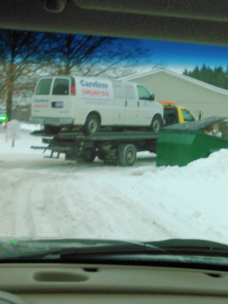

Here we go again. Only this time I dumped about ten gallons of gas at the same place the fuel pump went out last time.
Just got in. The gas spill was on a frozen parking lot at the same complex I broke down at last time.
I covered the spill,about two parking spaces, with sand. Had to go break through some ice and snow at my daughter's.
They have a crew that does accident cleanup coming to remove and dispose of the dirt.
I tried talking the maintenance guy into letting me hose it down and clean it up but he was nervous about the amount of gas. He called the district manager over the complex managers wanting to let me handle it.
Then had to freeze proof the van because the shop won't pull it in or run a heater due to the gas smell.
Crazy...
Lol nahhh, just a part of doing business.
Waiting to hear from the mechanic still.
May get a bill for the cleanup too.

Looking at two grand for cleanup. Vans not fixed yet but sounds like they are already denying responsibility. Says a sensor went out. This might get interesting.
I don't know. It looked like a shower. Must've leaked for 20 minutes maybe.
Two parking spaces roughly.
Yep something is fishy. Now it's the line to the fuel filter. I think it wasn't put on correctly.
Last guy who worked on it should pay the bill.
After I talked with the shop owner he wrote the bill off.
I get the sense he knows they messed up and only after I mentioned the clean up cost did he offer to write it off.
Not sure I'll get anywhere but I'm going back in a couple days with more info
Funny, he took responsibility for the leak but then said the problem wasn't something they worked on.
I'd probably win in court but I'm eating this one. First one in my ten years, I guess I can't complain much.
