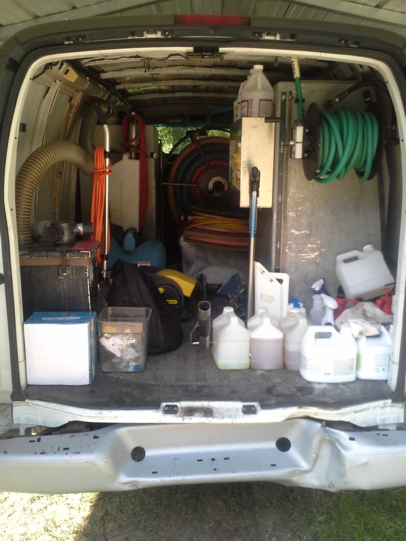

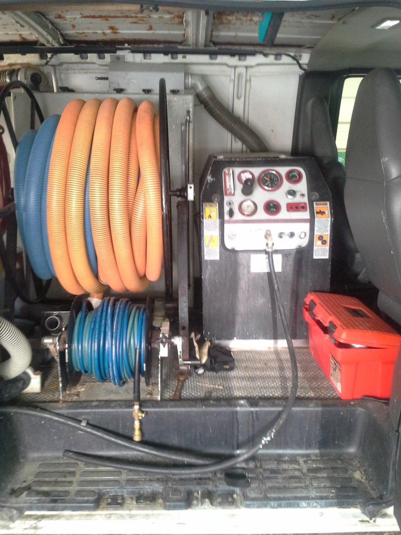

Do you have some good pictures of your setup to show us what you're proud of? I like seeing some good white magics.
Ill post picks one of these days.
Bumper and rear door. Its not high on the list but its there. Want a new drivers seat also.
