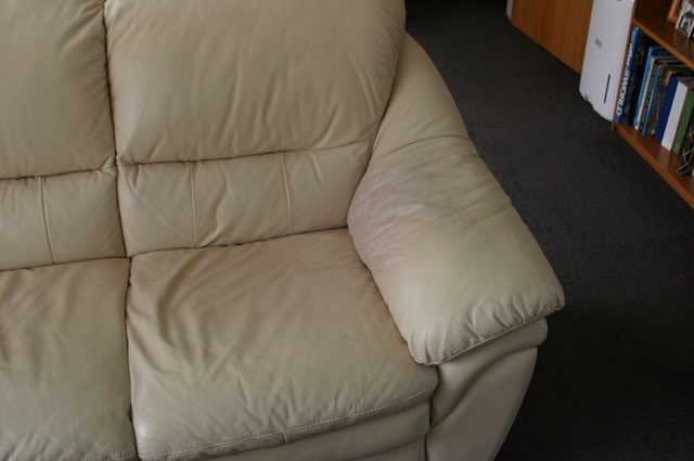

A client called with a the need to 'clean' her MIL's couch a week out fro Christmas because they were visiting from out of town.
Cream finished leather in overall good condition except for some dye transfer. I nornally try to do any leather work but it had to be done when I couldn't get there and my tech went out to 'clean' this suite.
He hasn't come across dye transfer before so it was a new problem to him. He called me very soon into the cleaning with the problem and in the end, I r4e scheduled for when I could get there.
In the mean thime, I spoke with the client and she told me she had some black cushions on it... immediately a light went off in me head as to why Jesse couldn't remove this 'soiling'.
The client wasn't home when I called, so I have no more conclusive data, including no idea what the cushions looked like sorry. I used a dye transfer remover to no effect. The dye seems to be IN the leather now.

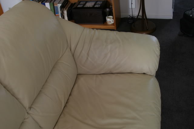

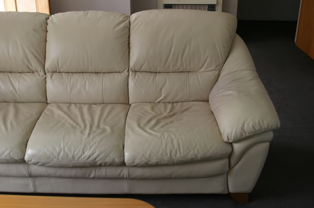

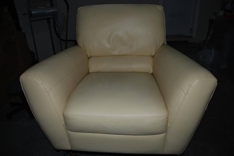

Overall picture.

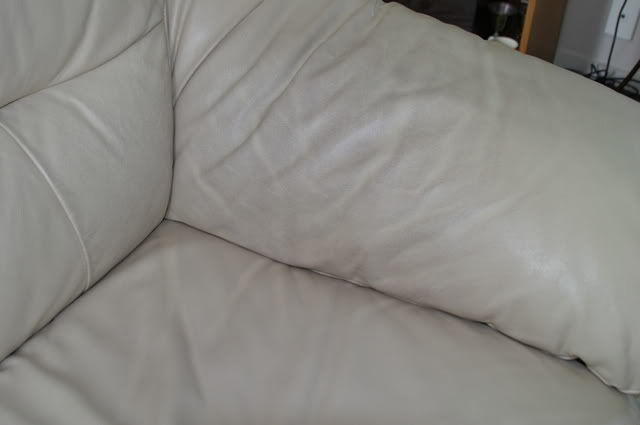

Close up of dye transfer.

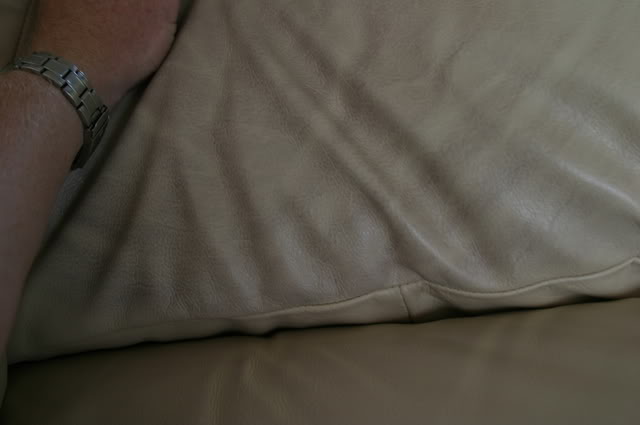

But while there, I noticed another 'problem', in any light, there is a 'green flourescence' type discolouration on the body contact areas od the arms and the fronts of the seat cushions.
Adding this next problem in (which the client hasn't raised with me so maybe unaware of) I'm beginning to wonder if there is a fault with either the leather finishing of else a flow on effect from inappropriate use of products during it's life.
This is the first case of dye transfer taht I haven't been able to correct. I'm wondering if a re colouring is needed but I was honest with her and said I didn't know but would ask some questions of you guys.
Suggestions? Cures?

The greenish tinge may be caused by the cleaning process. The dye will be made up of several colours and the cleaning process may have removed some of the colours but not others (we have seen this on more than one occassion) eg. the blue and green elements may have sunk deeper into the finish and cleaning may have removed the red elements leaving a different colour behind.
The only real recourse now will be to recolour and refinish the leather. Use alcohol cleaner first to see if this will remove any more of the dye and then proceed through the recolouring process.

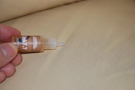

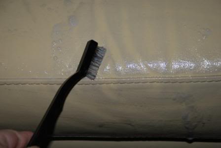

My tech cleaned the two seater, so any discolouration is from previous cleaners and not us.
On the dye transfer, I first used a transfer dye remover from Fenice, when that failed, I tried a strong cleaner then as a last resort, SPS - surface preparation solution. This will take off any clear finish and start to remove the pigments. I deliberately did this to see if it was IN the pigment and as I was removing cream pigment, the black colour wasn't moving at all.
I'm not into full colour restoration so will pass on to another company a couple of hours away that does.

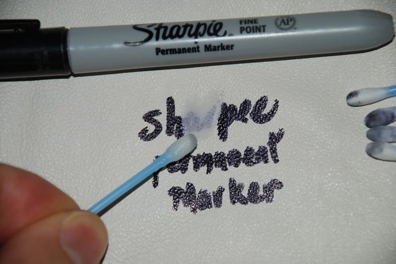

#5 Permanent Marker removed by either d’Marker10.5™ or d’Ink7.7™.
#6 d’Ink7.7™ in action

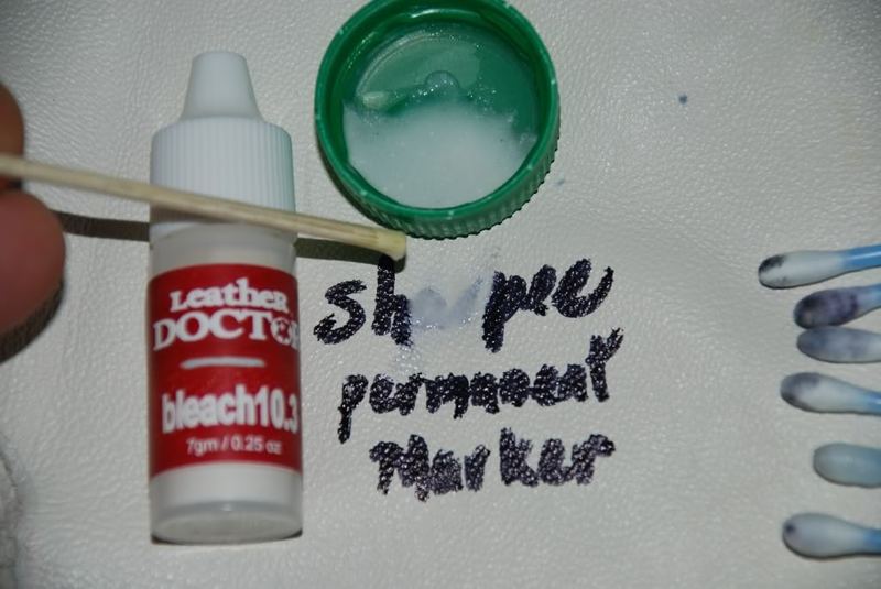

#7 Optional bleach10.3™.
# 8 After bleaching
