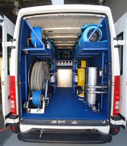

More installs as requested...

1st CLASS all the way. Our American distys SUCK in comparison. There is NO comparison. Most American truck mounted vans would be condemned if they we're houses by the government.
PURE, PURE QUALITY!!!!!!!!!!!!!!!!!!!!!!!!!!!!!!!!!!!!!!!!!!!!!!!!!!!!!!!!!!!!!!!!!!!!!!!

Those look terrific! If I had been able to get a setup like that when I was purchasing from Powerclean I would have. That is some nice looking stuff.
Do you know if those of use with a couple year old Genesis can get that new "larger" waste tank? It appears to be the same width from what I can see, but it is taller.

That really is amazing. I am quite impressed. I love the look of all that stainless.
Why can't we get that in America?

Very nice installs on both trucks. I like the idea of using more Stainless.
I think that since the equipment costs more over there, that it is installed and maintained at a higher level.

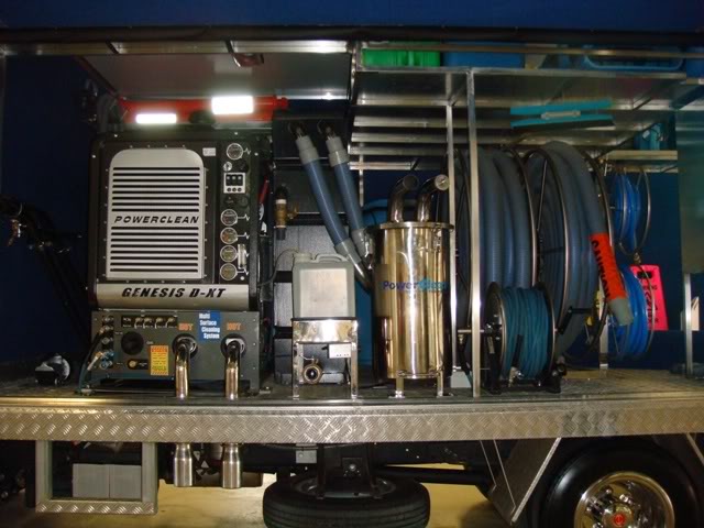

I like the tilt-out feature on your inline filter. What was the cost of just the filter?
We had a line of NSS tank vacs that emptied the same way and customers liked that feature.

The only thing I don't like about the filter, is how HIGH up the vacuum connections are, I see that being a problem. Other than that, I want an external filter badly.

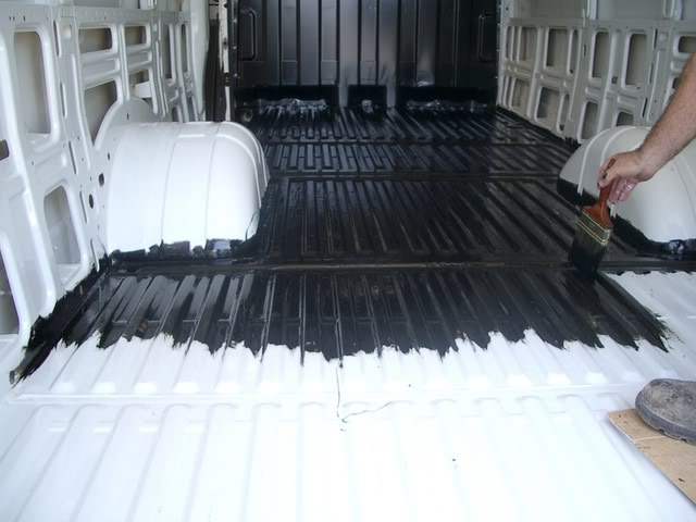

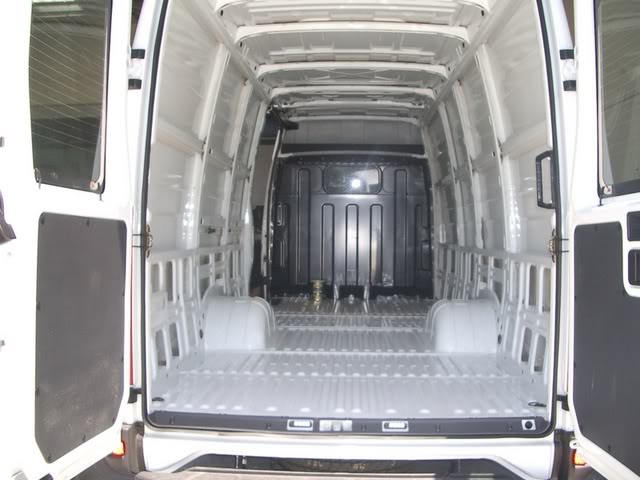

Pmatte said:

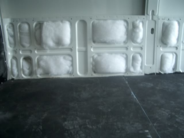

Going back to the Toyota installation;is the carpeting glued directly to the factory walls or to the marine grade plywood?Also,if it is glued to the ply,do you attach the wood to the walls and then carpet the wood or do you carpet the wood and then attach to the walls?Thanks again and keep those installation pictures coming.
Patrick
I'll give you a quick run down of our installations starting with a new van
We then rustproof the floor
Fit marine grade ply and screw that to the floor.
Fit insulation into all of the wall cavities

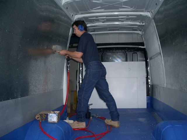

Cut Zinc sheeting to size and rivet it to the cross members of the walls

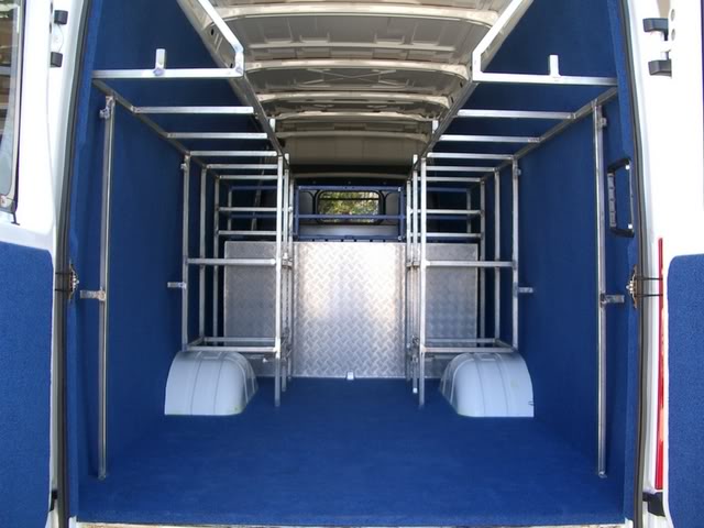

Apply marine carpet to floor, walls and doors. Measure up and start fabrication the custom racking and auxiliary tanks
Before it gets completed and loaded before it rolls out of our factory...
If you have any other questions Patrick, don't hesitate to ask. :)
Jim

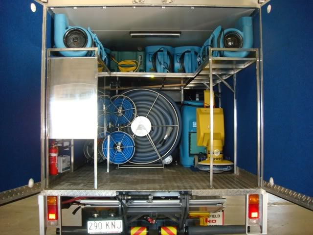

Jim Bethel
Here are the finished photo's of the rig that I partially posted earlier. The Stainless racking and wraps have now been completed. On board currently there is 2 dehums, Cimex, 22 air movers and still a lot of space left over. All the racking including the chemical lock box is stainless. Came up great!
Side view showing the PowerClean Diesel D-XT Genesis.

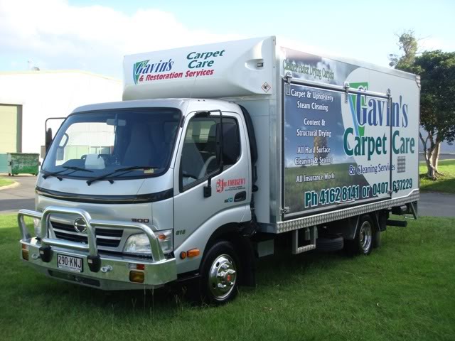

Finished off including the wrap.
Jim
J
Jim Bethel
There is nothing fixed, as no two installs are ever the same. Everything is custom and done into different vans or trucks.
Each customer requests different things as well. We just charge our normal weekly rate plus material. So the labour content on something like that would be anywhere from $1000 to $2000.
Jim
you have the "best in show" installs, Jim
truly top-o-da-heap!
set up for max efficiency and economy of space.
very very well done!
A
Aaron Richards
The only thing I can see that's not perfect with those trucks is that one of them isn't mine!
