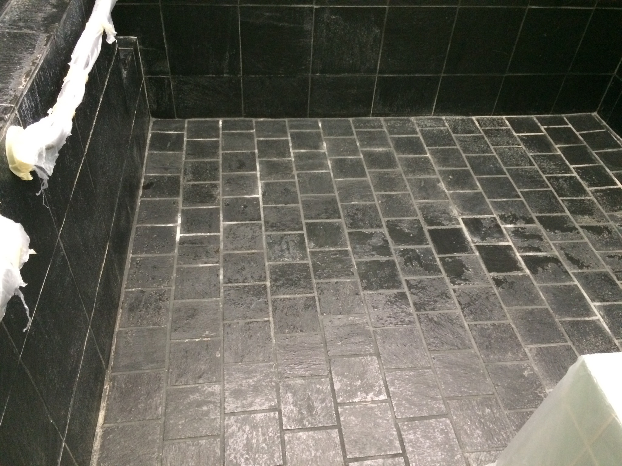

This is how it looked after it dried.
I forgot to update this thread:
I showed this picture to Bryan at Mikey's first hard surface class that I went to a couple years ago and he told me that I needed to use a floor stripping chemical. That what was remaining was one of those products that the lady had been using. So thanks for reminding me about this post @Bryce C
Anytime Matt, happy to be of service. I'll be here sleuthing on the boards for the next 2 to 30 years 🙃
