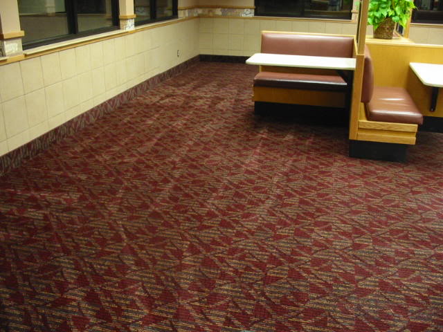

Well I had some fun doing three locations last nite. Haven't been cleaned since Feb.
Glad they called to clean again, guess they sold enough burgers. Used do every month now they say probably be every other month.
Presprayed with Cleanstreak then scrubbed and rinsed with high heat and Dry Slurry.

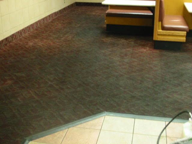

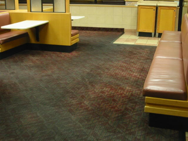

Before when I walked in not presprayed. DOH!

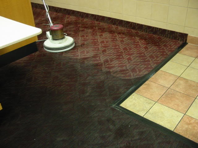

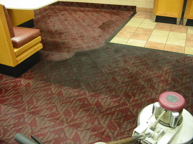

Scrubbin with the minuteman

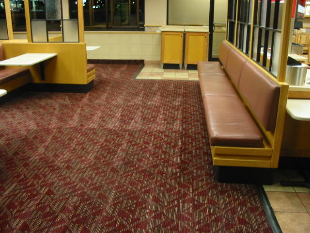

After the rinse

Daniel on this job the pre-spray was sittin on top of the grime. Brad is Nationally Ranked Carpet Cleaner. He did the right thing. Pre-Scrub was a must. The only thing I would have done different was Pre-Scrub with a Green Pad. Daniel if you ever want to be a Nationally Ranked Carpet Cleaner a Pre-Scrub is a must. Scrub and run guys need not apply.

Daniel this location was hammered. I hear ya on its easy to clean resty's. When I sprayed it just sat on top so it had to be scrubbed. Why do the slow pull cleaning pass when you don't have to?
Time is money and the truck ran less doing it this way.
