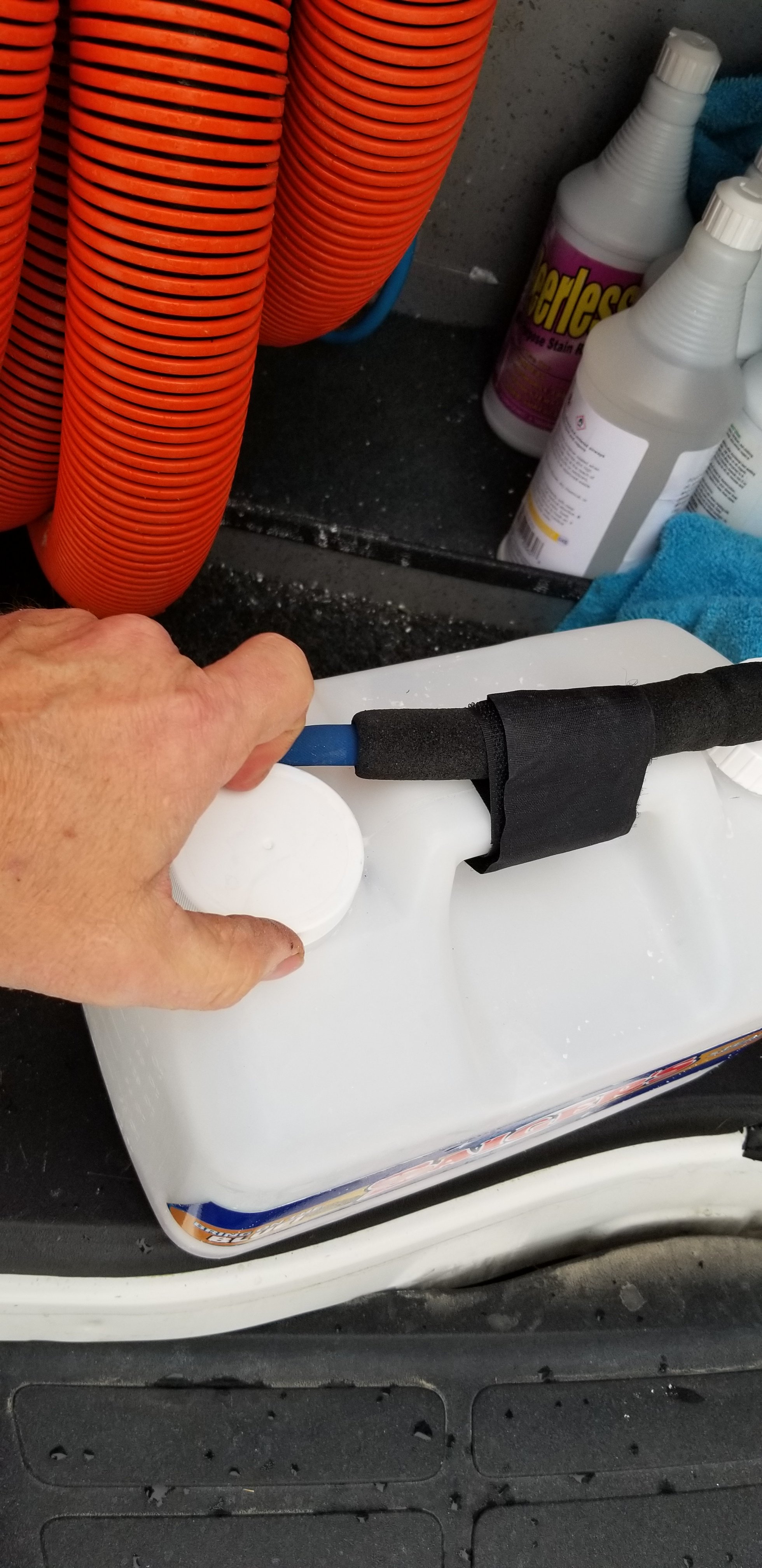

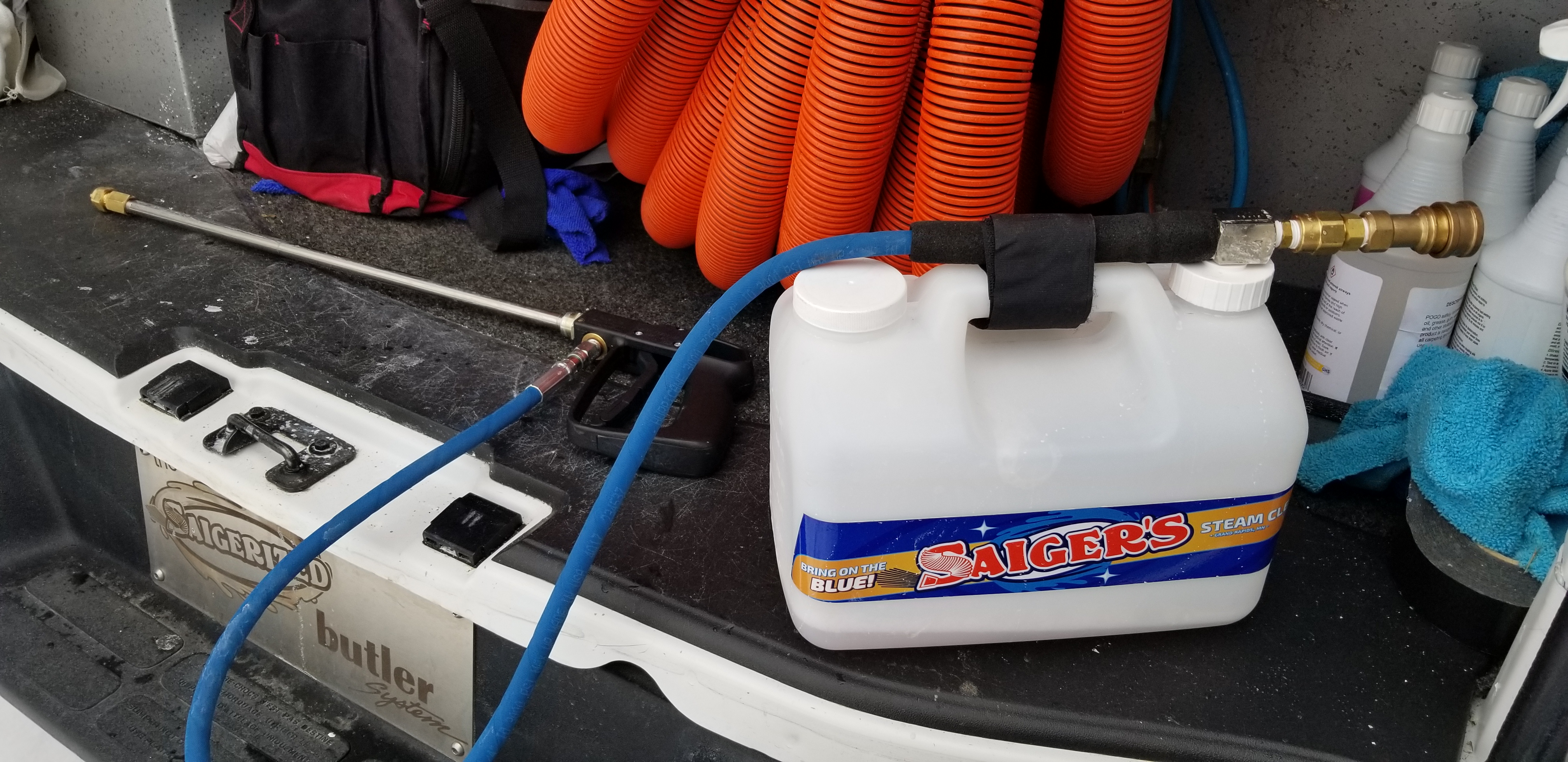

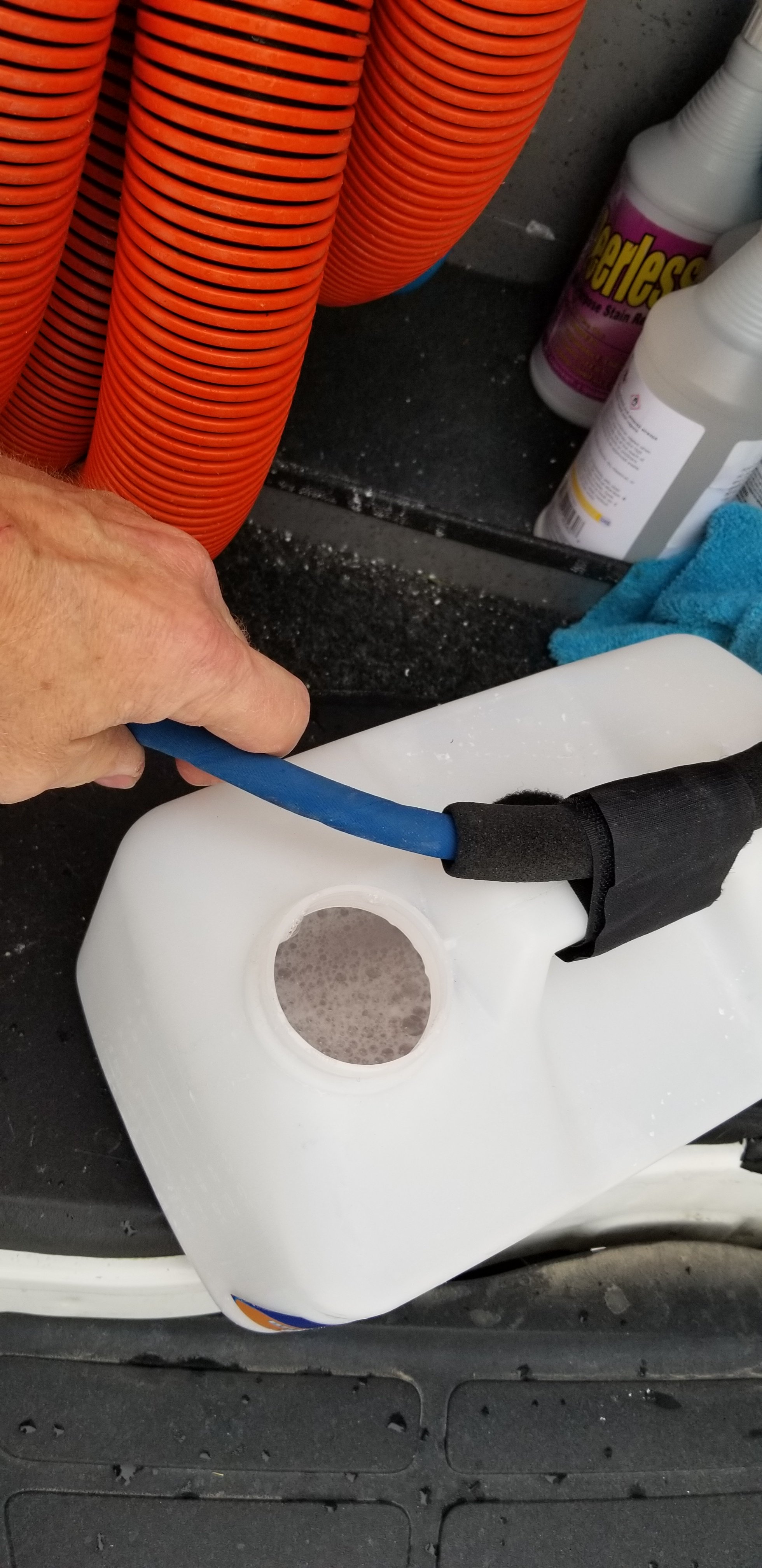

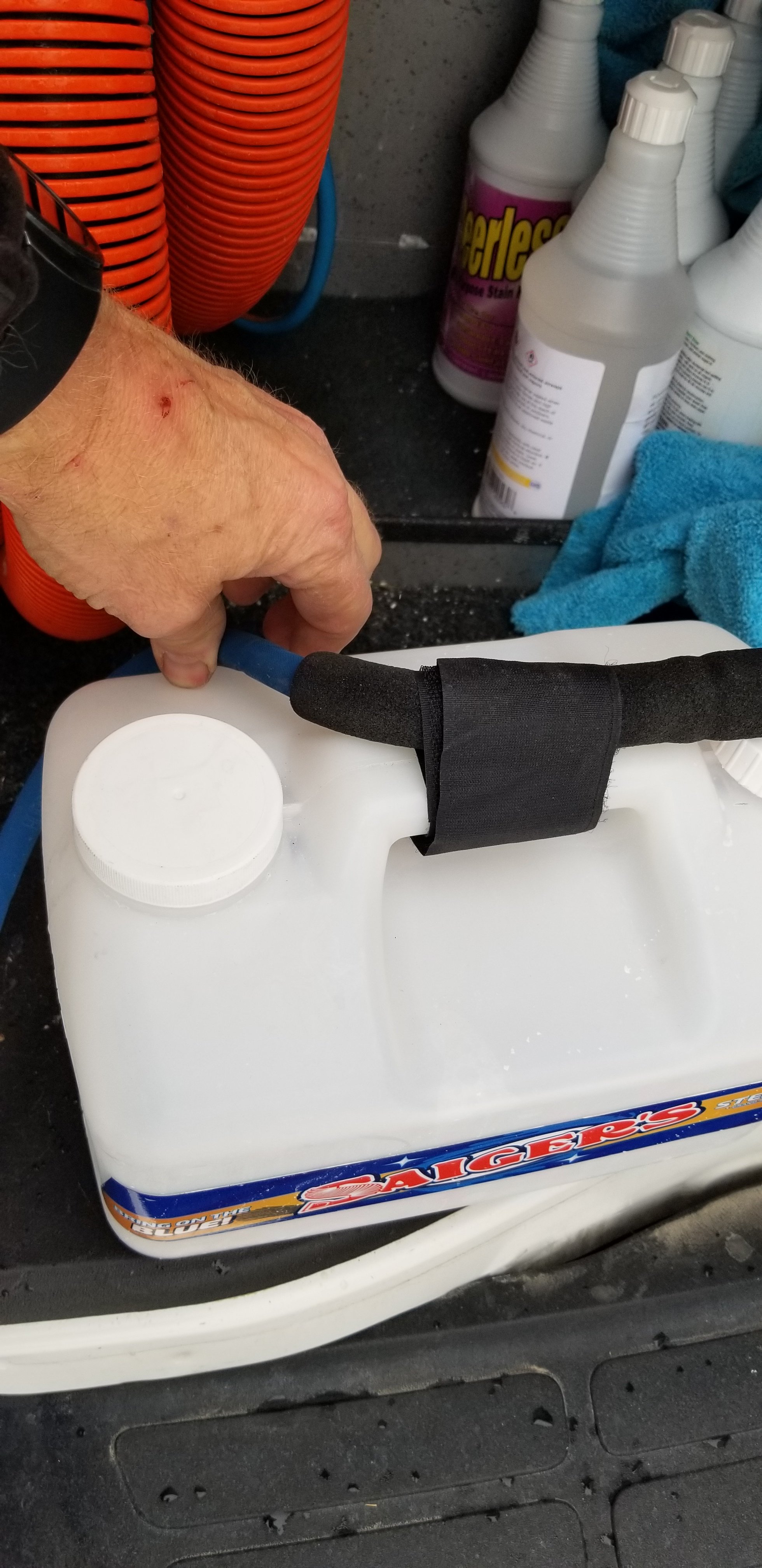

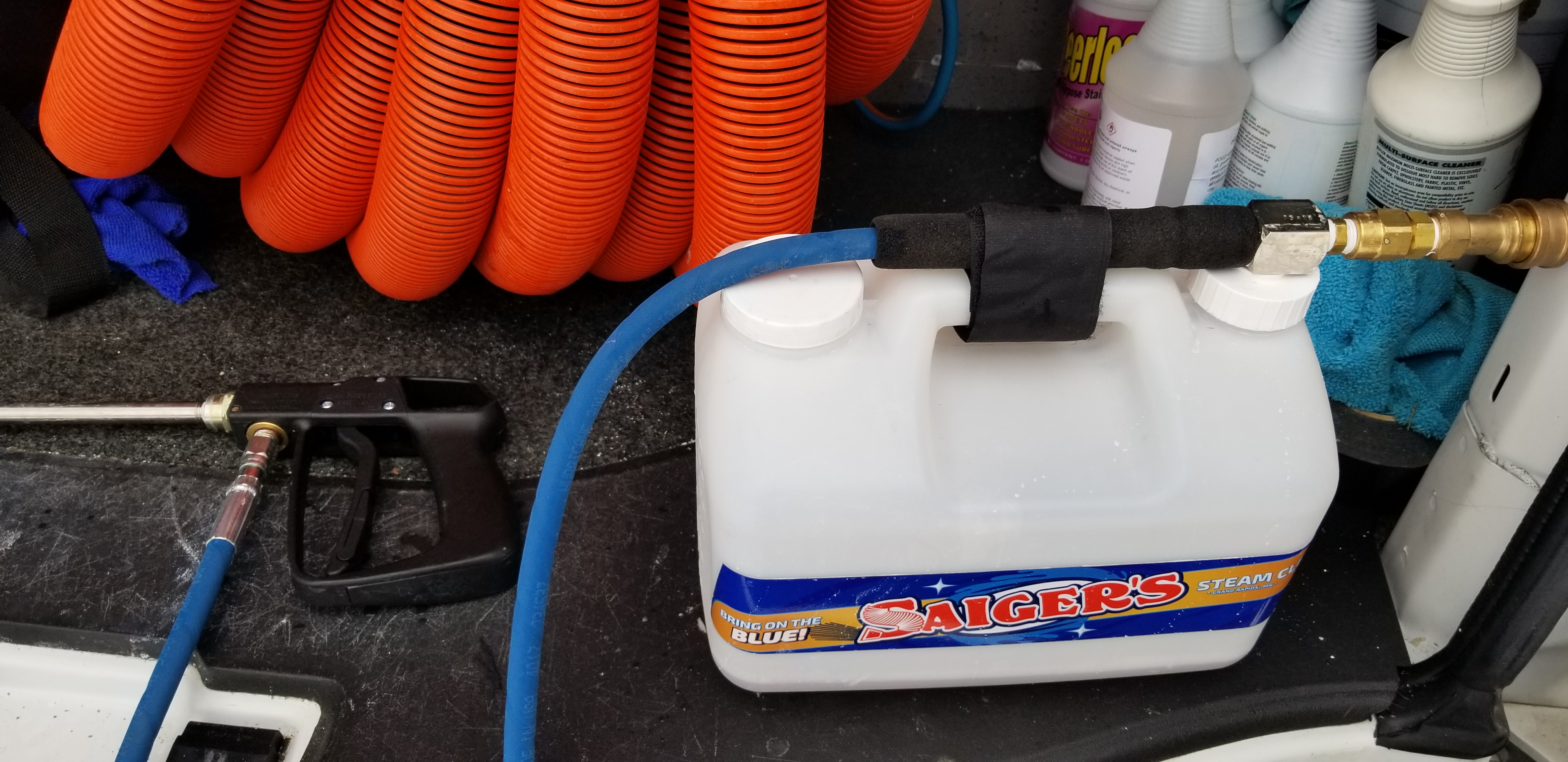

Multi sprayer brand.
Don't get the adjustable version.
Get the one with the yellow Tip in it and take that out.
Get an extra Dema valve and keep in the truck. When it goes bad you will be ready... Then order another Dema valve to have in your truck repair kit (like about every three years)
JonDon has the Multi Sprayer private labeled as Powerforce II
I am now using their new six quart version. Not sure if JonDon has on their website but a cool new feature taking out the hard inline brass tube.
Keep in mind there is a filter coming into the Multi Sprayer brand high pressure sprayer and also another filter at the end of the wand by the jet.
