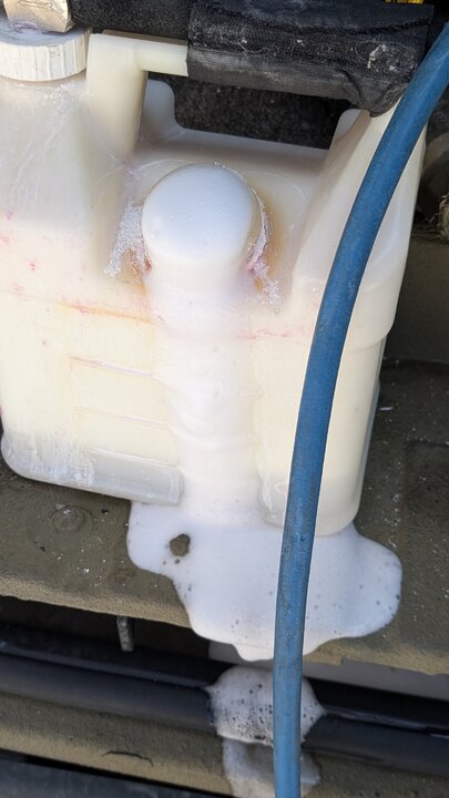

My Influencer version is packed with the power of Bio8...
14,645
I’ve never had Bio-8 foam like that, but I don’t mix my chems in the HF and I don’t use TM hot water
Maybe you should try it
Activating that Na2CO3·1.5 H2O2 with TM hot water really knocks out the organic funk
