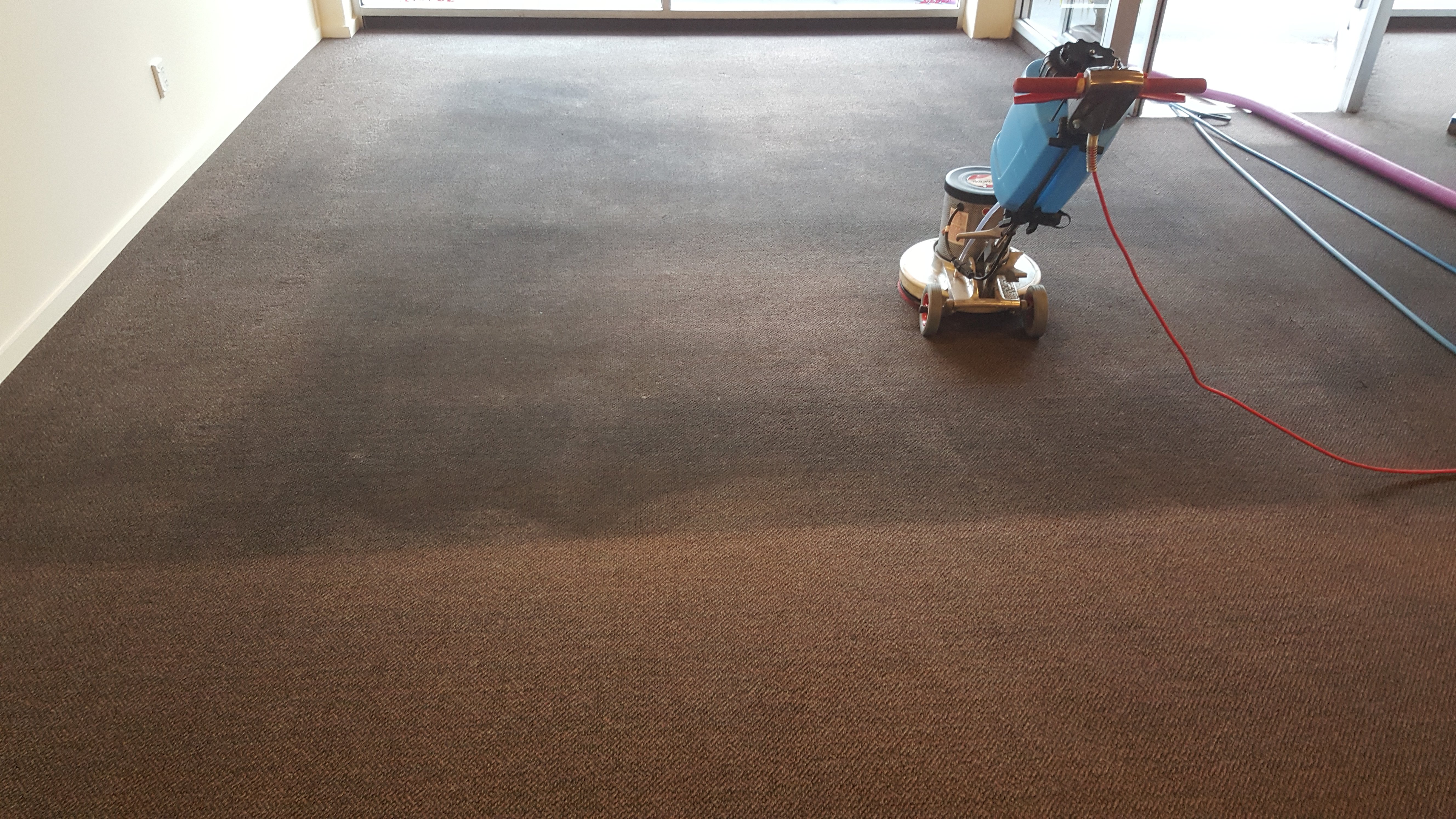

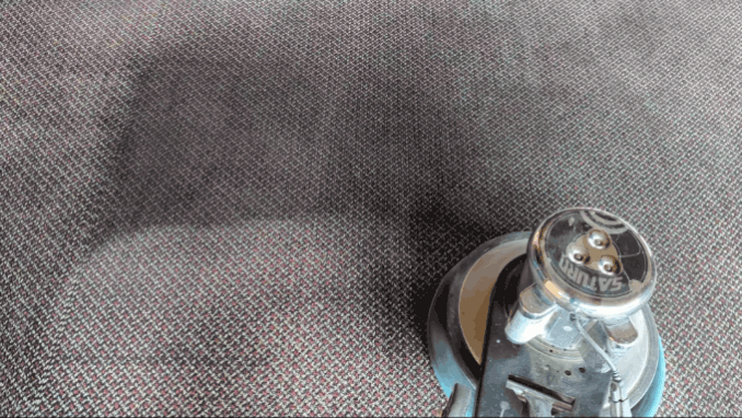

Its been eons since Ive post padded with a 175..
is he going to extract that or leave it filthy?
I hope he's a 30%'er (hack and knows it)
cause that carpet is still scummy AF
EDIT..I see he extracted it :very_drunk:

I'm a big fan of post padding, but rarely have time to do it.
I've been toying with the idea of putting down my prespray with my O.P. and scrubbing with a red pad as I apply it on the carpets that need a little extra love.
though I love a red pad scrubbing, I dont think an op would put down enough juice before extracting?
