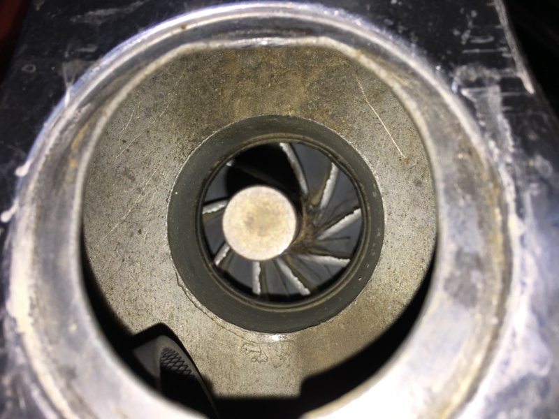

It boggs down when I lower the vacuum on the carpet, and yes the belt is good on it. It just doesn't feel as strong as it did a few years ago.
When it was new, it conquered the carpet, but now, it just feels like it doesn't want to pull away from me.
The picture just shows how bad the fan is wore on the motor. It's coming close to 7-9years old and it's got several hours on it. So, has anyone here wore out a Royal?

Did you get a quote on a rebuild?
Yeah, seems like it might be good to replace whatever is worn.
I like the Royal because it's so simple. I bet a new motor or new fan blade deal (creates the lift), brush roll.
The picture just shows how bad the fan is wore on the motor. It's coming close to 7-9years old and it's got several hours on it. So, has anyone here wore out a Royal?View attachment 19917
A couple of possible answers for you is that the belt has streached out over time and while it "looks good" it may be too loose.
The belt may be slipping from either the belt, motor post, or brush roll being too smooth and the belt can't get a grip anymore. try sandpaper to rough up the wood brush roll or the metal motor post a little
The fan blades don't effect the brush roll at all, it only effects the suck of the vacuum.
Yeah, I replace my belts and brush roll frequently. But I never thought of messing with the motor post. I'll get out some sandpaper before Monday and let you know if it's any better.
I agree with the fan blades not affecting the brush roll. I was showing the condition of them just to show you ya'll how well used this motor is
