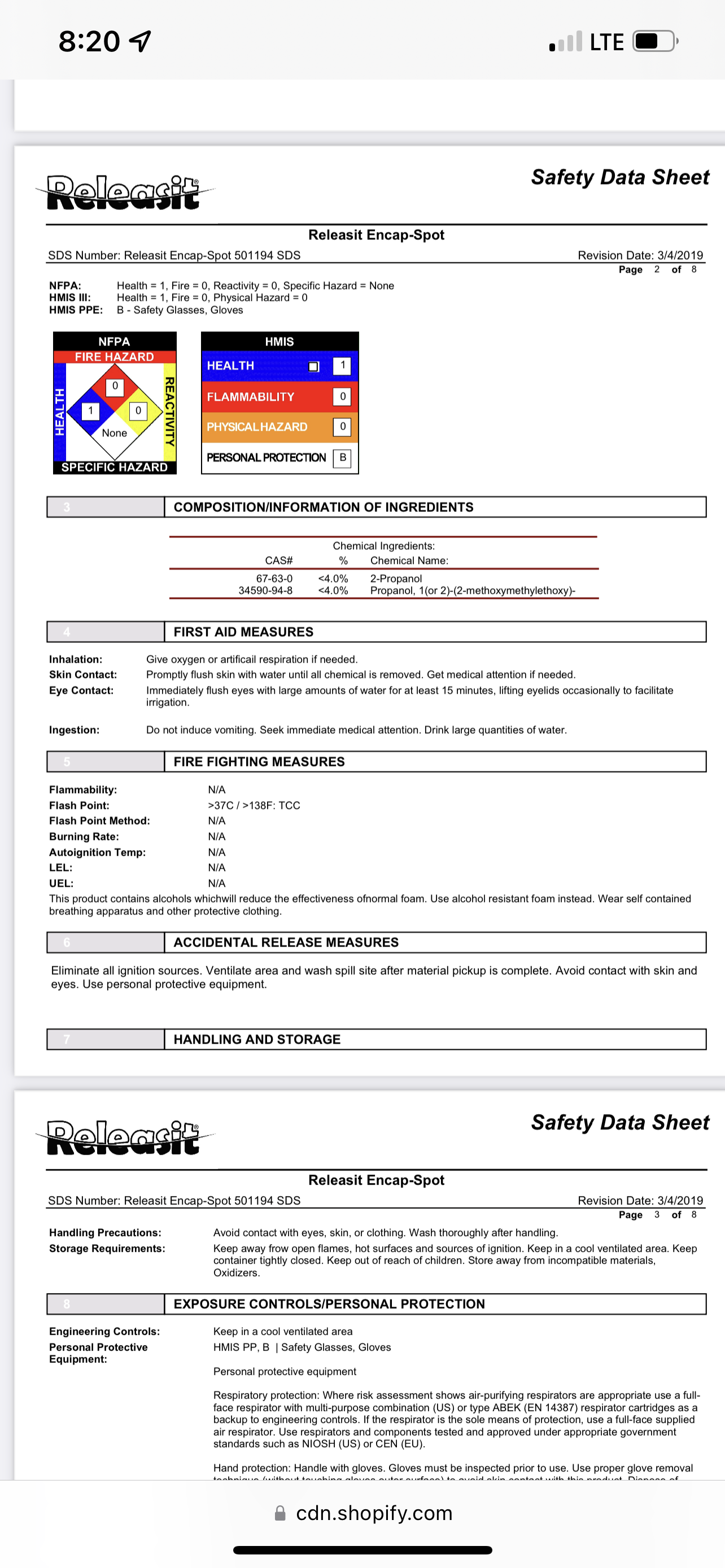

Encap-Spot will also take out a lot of ink spots.
Isopropyl Alcohol

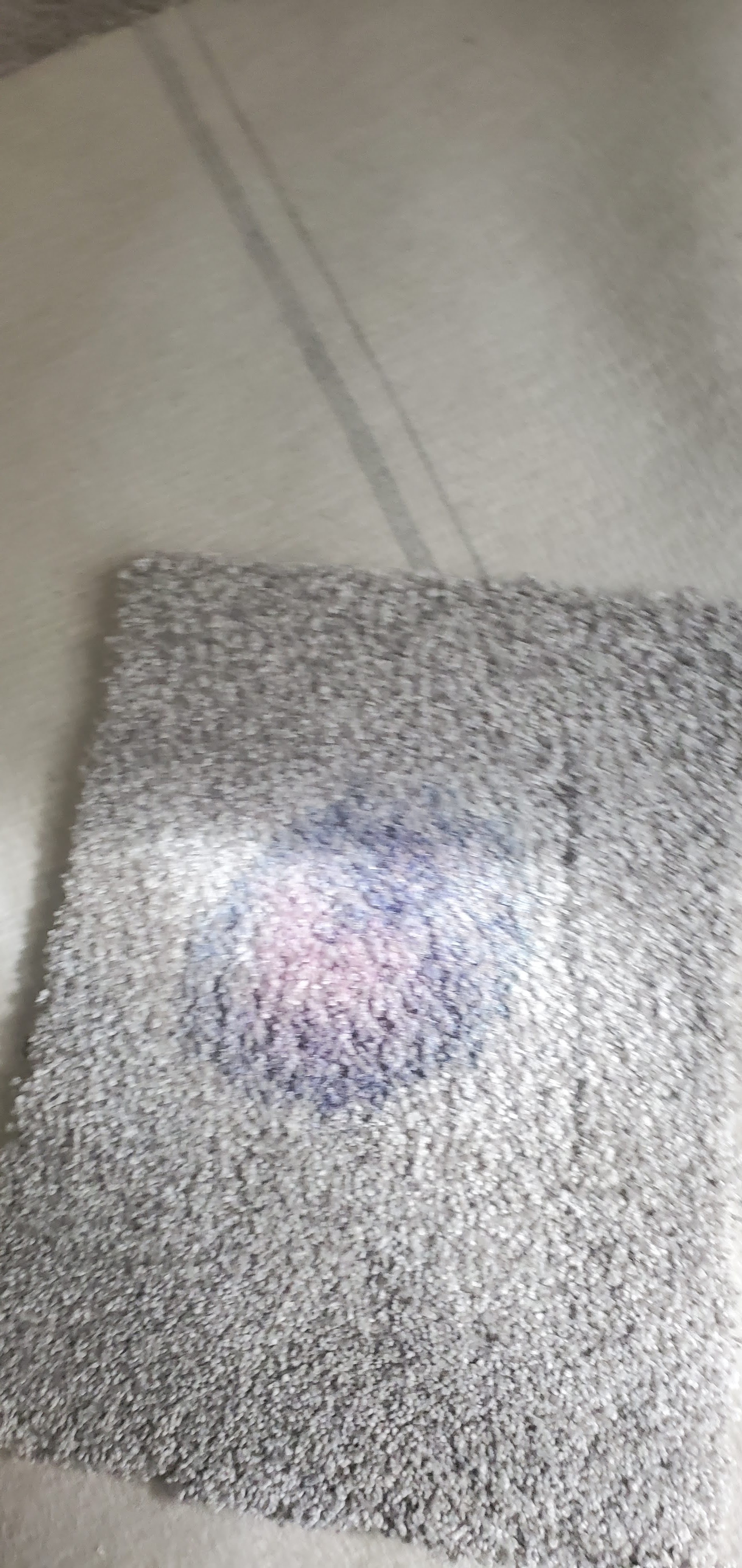

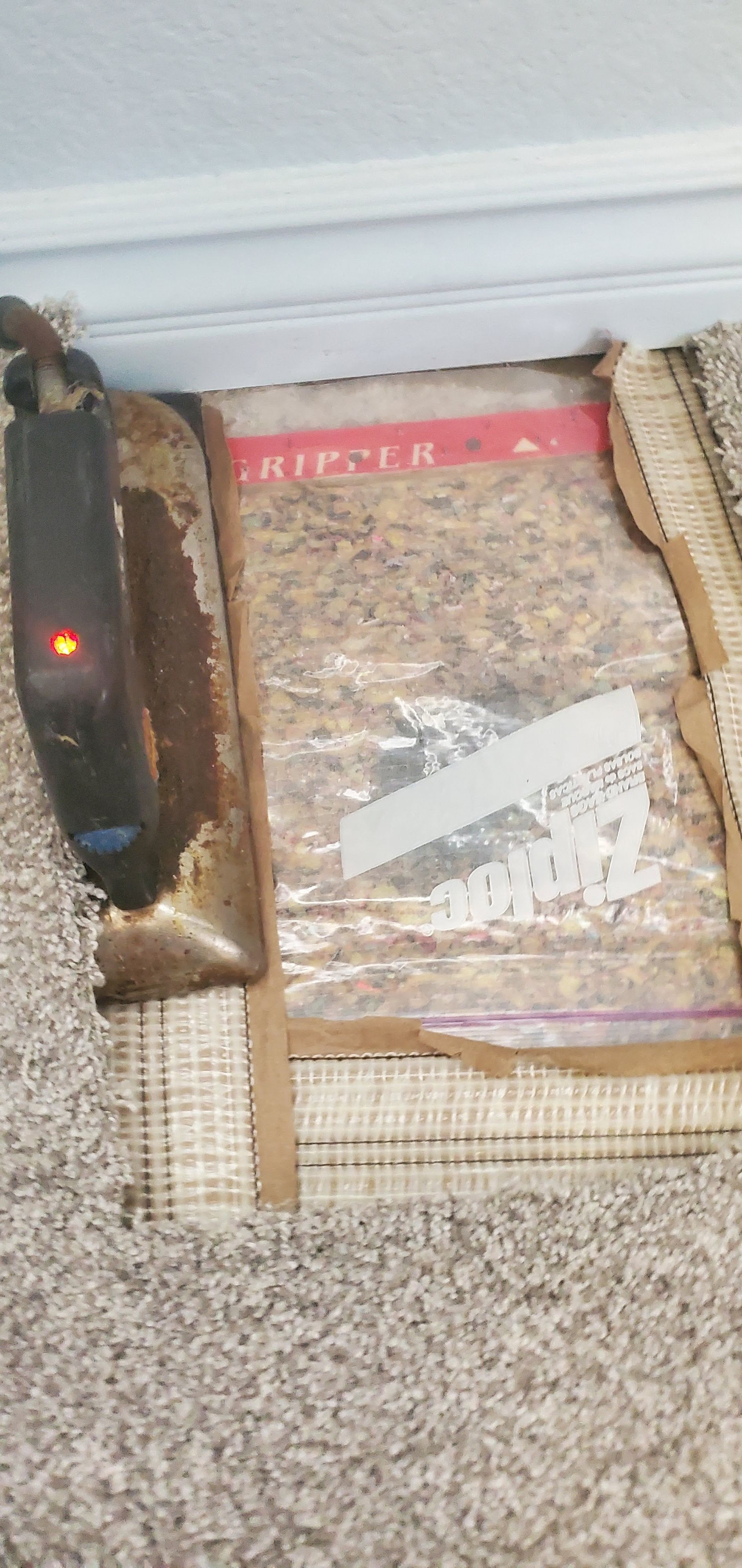

Seriously not all ink is created equal, just cause you got lucky on a sofa and thought you were a hero.
I had a small drop in carpet explode ended up patching it.
You can see the size of the ink spot in the pad.
View attachment 115320 View attachment 115321
Your right on that….As i said a few threads up….had a situation that appeared small ink no problem….ended up half the room was inundated with The Blob.
