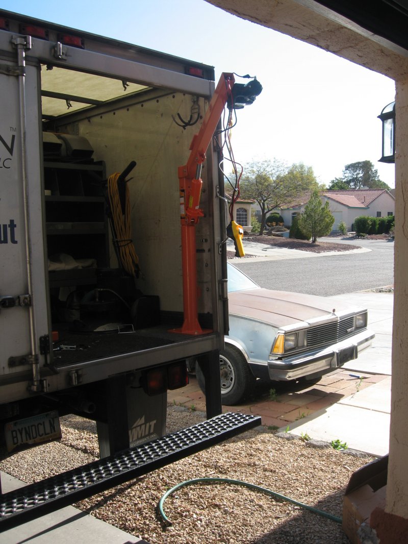

I like that step. I think I'll get my metal guy to cut mine off and weld on one of those

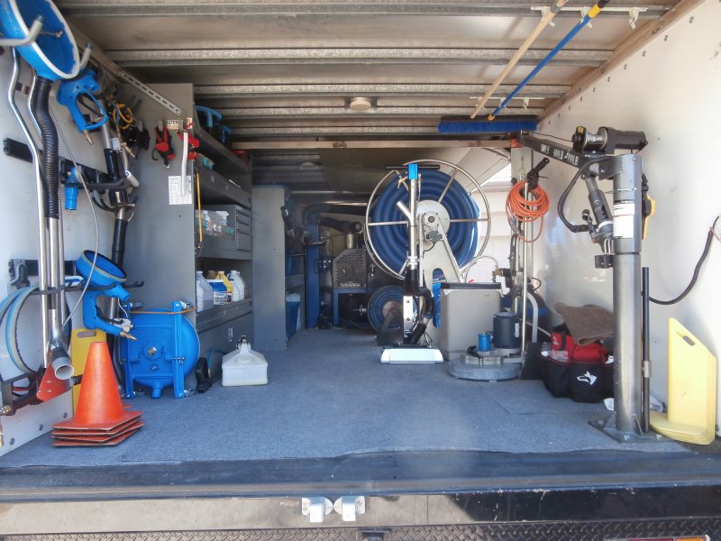

The carpet idea could work, if you're committed to pressure washing it every day. Until you've had a sticky surface at the back of a box truck you have no idea how much guck gets sucked up from the road.
Grip tape is great on a flat surface, but will not adhere well to diamond plate. It will peel of in chunks.
Do not use the Rustoleum spray-on bed liner! It's brittle and doesn't adhere well. I think it's meant to be used where you want the look of a tough surface, but never have anything contact that surface. Herculiner or one of the other roll-on bed liners would be better for the purpose. Might be worth checking with a local Line-X guy to get a price to coat the bumper, that stuff is tough and has a pretty grippy surface. (Note, you'll never be able to completely rinse detergent spills out of it.)
Maybe try shoes with a grippy sole, or be like Mikey and just parkour roll in and out.

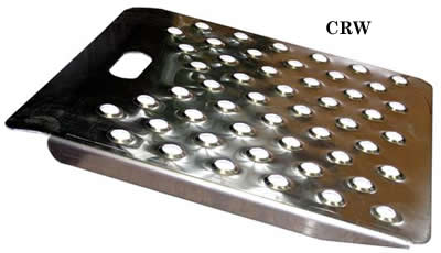

Hell.....bolt one of these down and be done with it
