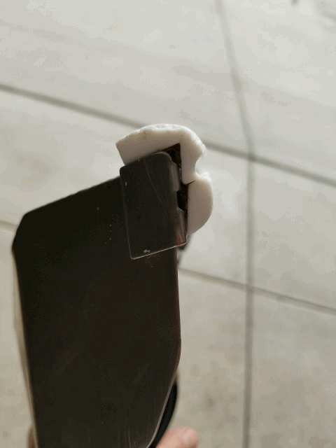

The PMF was recommended and as I said I bought 2 glides both streaked like no other.
They weren't dang glides either.
? Chirp.
Hook a wand with this Glide to a well formulated extractor and voila!
Notice it's round profile and two piece design effectively removing any Bridge support they are a custom one-off option available through pmf for their Mach Wands and most likely the 802 which is a darn good wand as well.
I bought what I was told was the best wand for JUST extraction.
PMF2051, 2 or 3 12"width 2" hose .
Whats the part number for this glide.
Or should I just call them? Who do I ask for?
