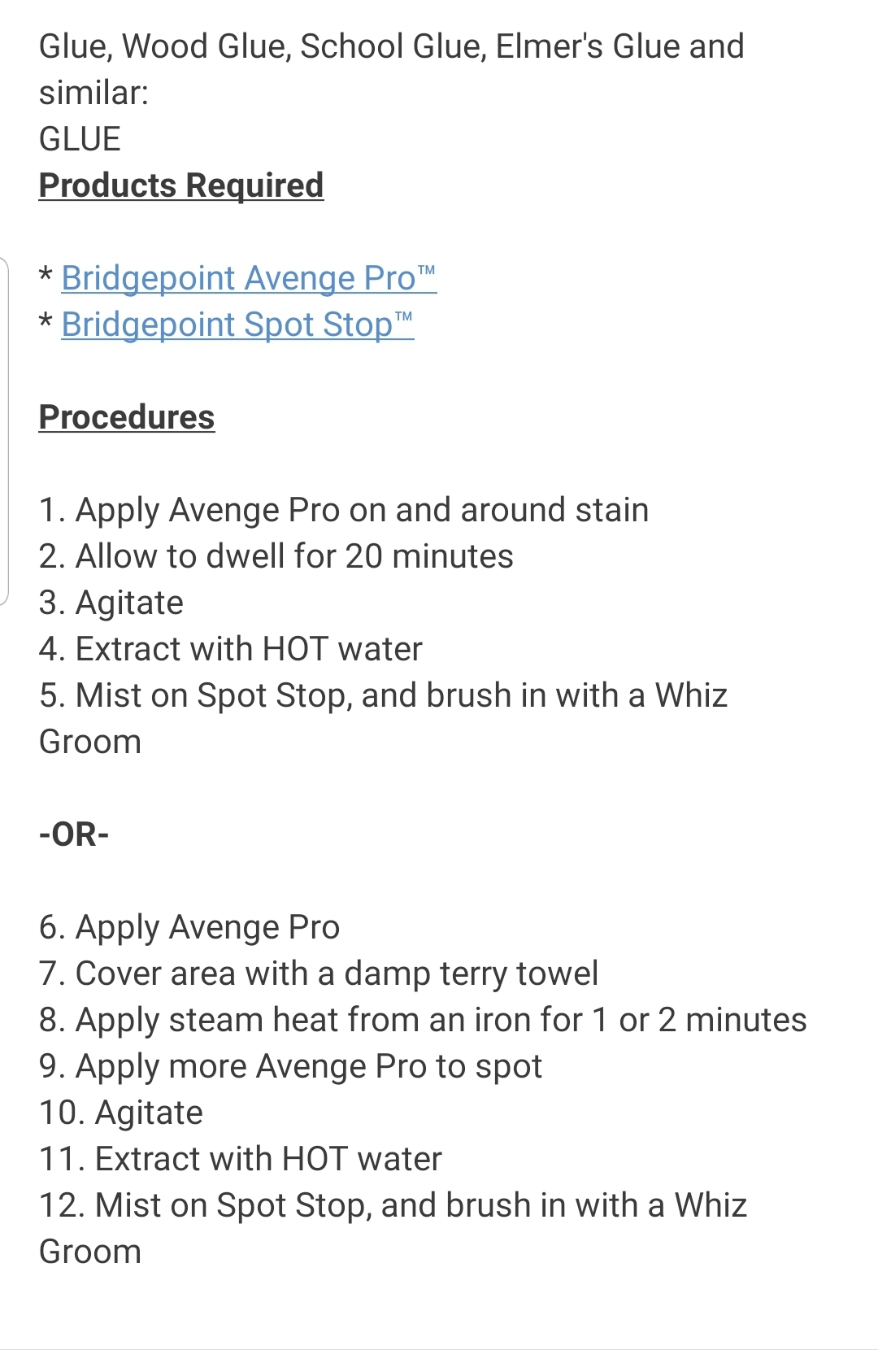

a scottw post I stole from somewhere.. :shifty:
never tried his way so dunno?
This works pretty well for glues. Slime usually adds a few ingredients to make removal difficult. There are several recipes for slime. Usually adding the citrus solvent and more moist heat are the best additional steps to take.

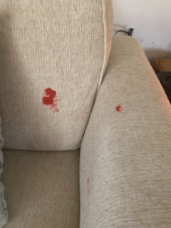

look what a customer just sent me to have look at tomorrow..
not sure if its home made silly putty or not? But its bright! 😳
