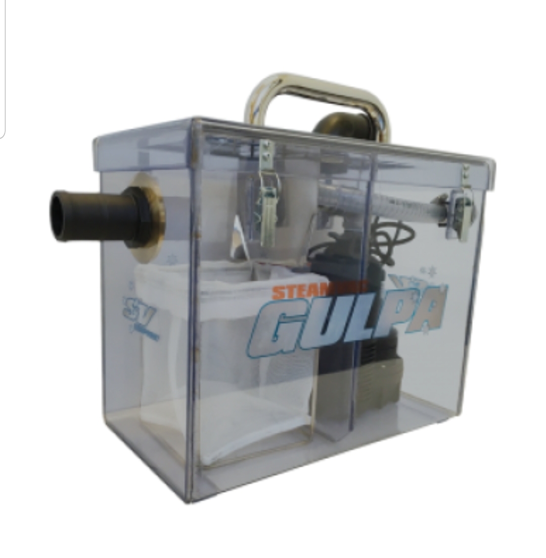

This is the only inline filter I use. Over 25 years old. I have 2 of them. Large screen filters out debris and pump out lets me clean all day long. It would be nice to see a new, improved version. Clear plexiglass keeps the customers mesmerized by the dirty water.
View attachment 95615 View attachment 95616

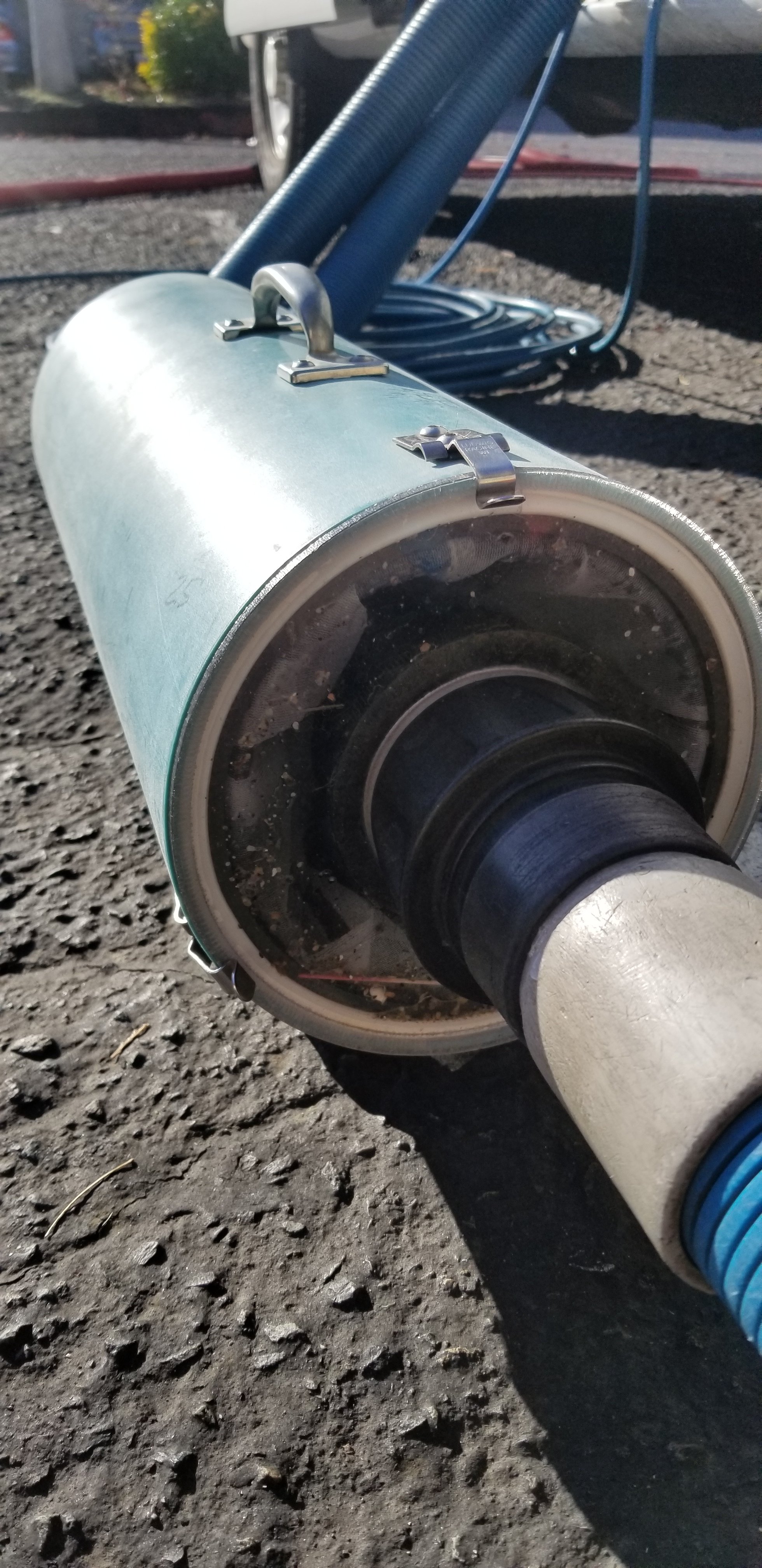

I have a brand new white liner in my filter, and you can see no pooling, I'm cleaning with 550 psi 8 flow.
This is a filter I am working on right now, we have cnc and I am able to make most of the parts in house. Nothing overly special about the filter except it does its job.
I have been super busy so I haven't had time to focus on it. I have always liked to clear front lid even though they can crack it colder climates.
I have a few guys asking about them and I should be able to get some ready over this next week or two.

I've been testing this version since PHX,
no complaints works as it should but I prefer the OG with the SS lid and no finger pinching clasps....

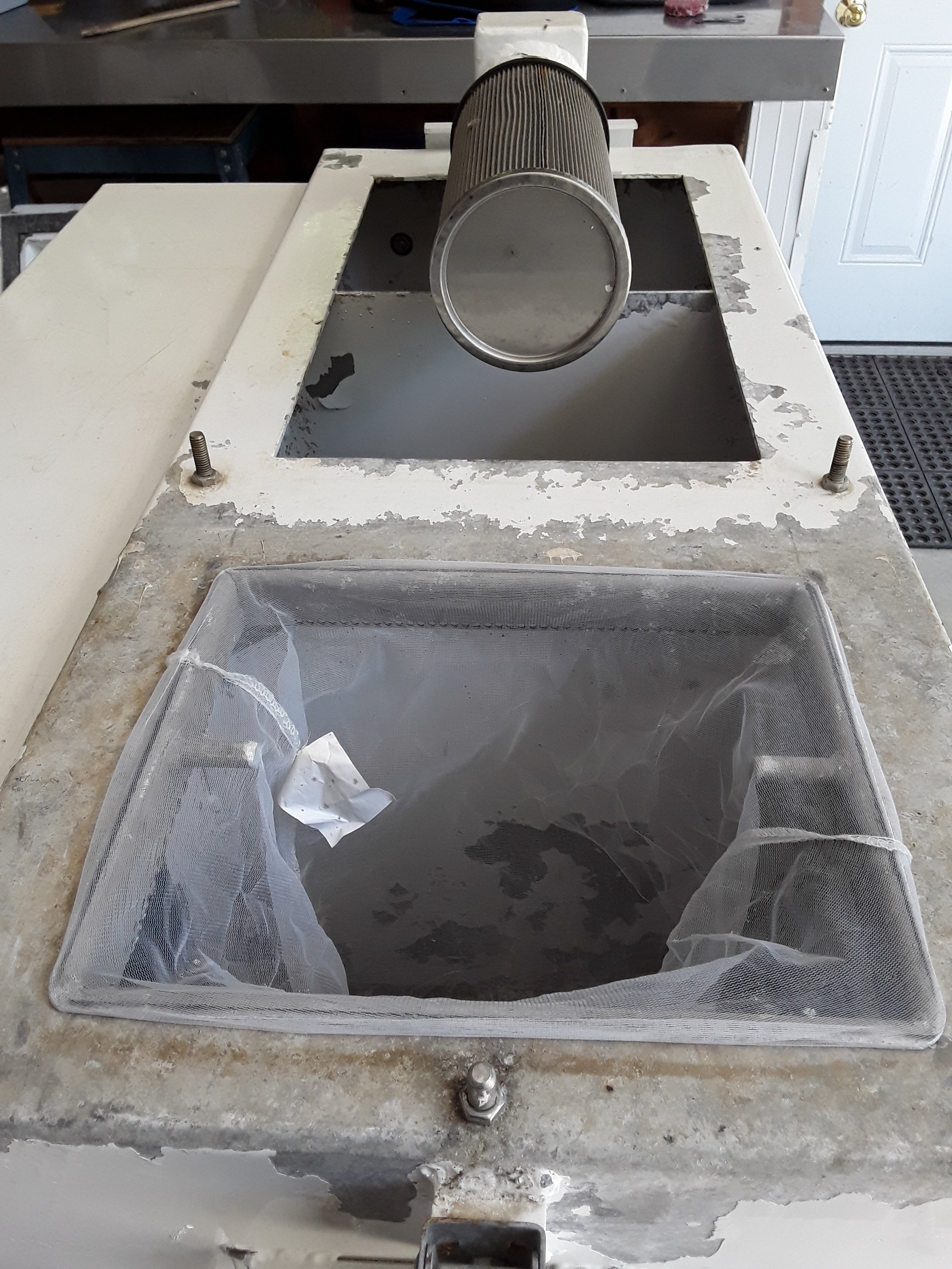

I had Tom''s all ss filter that I used for several seasons. Sold it included with my 2008 Butler.

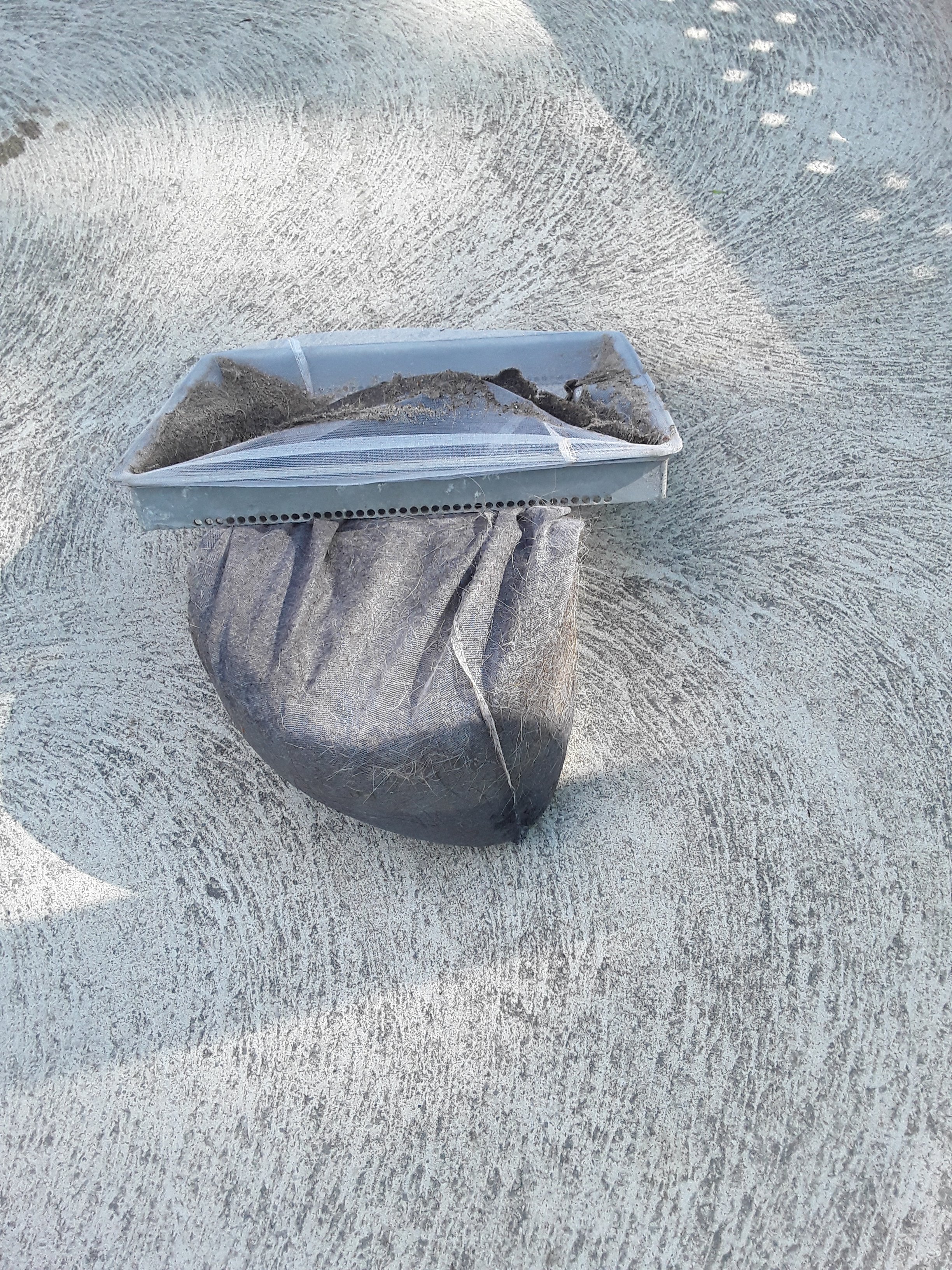

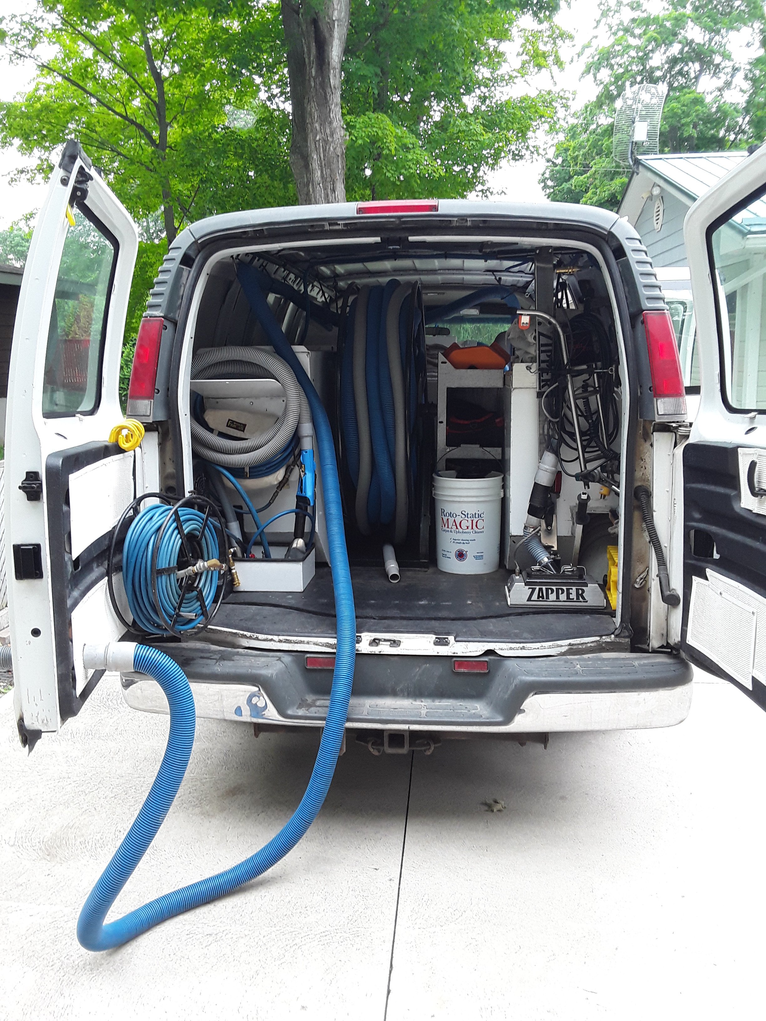

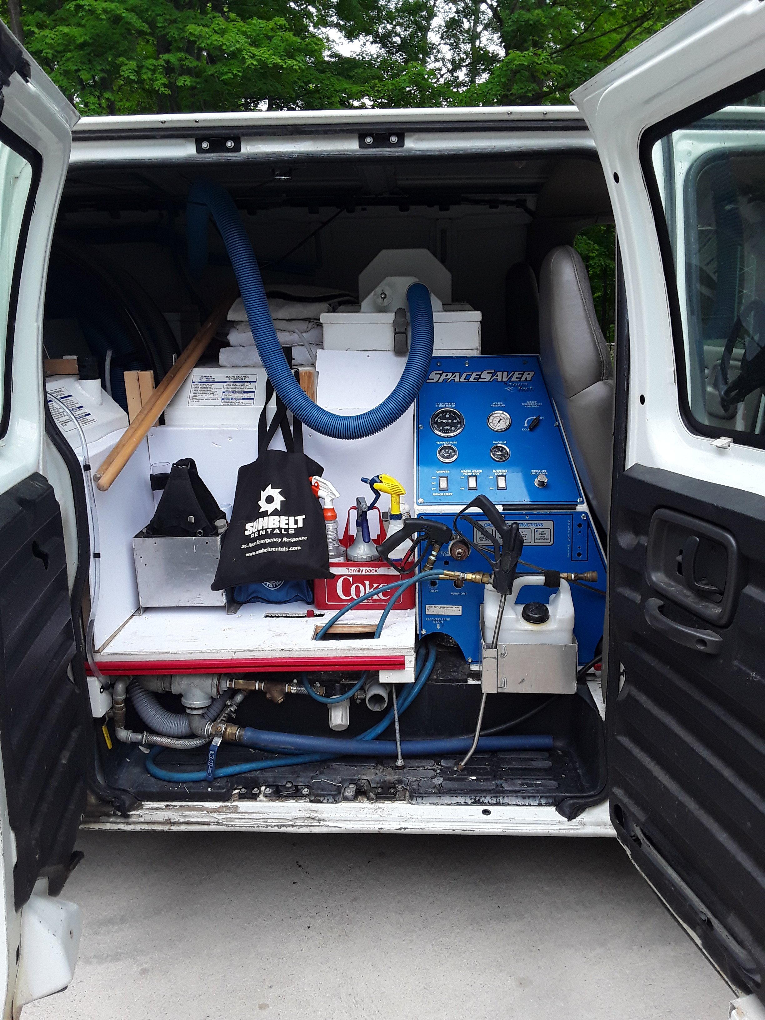

This is what I came up with for my AquaTech waste tanks. Tank sits right byour side doors, so it is super easy to swap out filters mid job. I also run an xl knee high over my in tank filter.
I've noticed a good increase in oomph on the suction with no side wall restrictions.

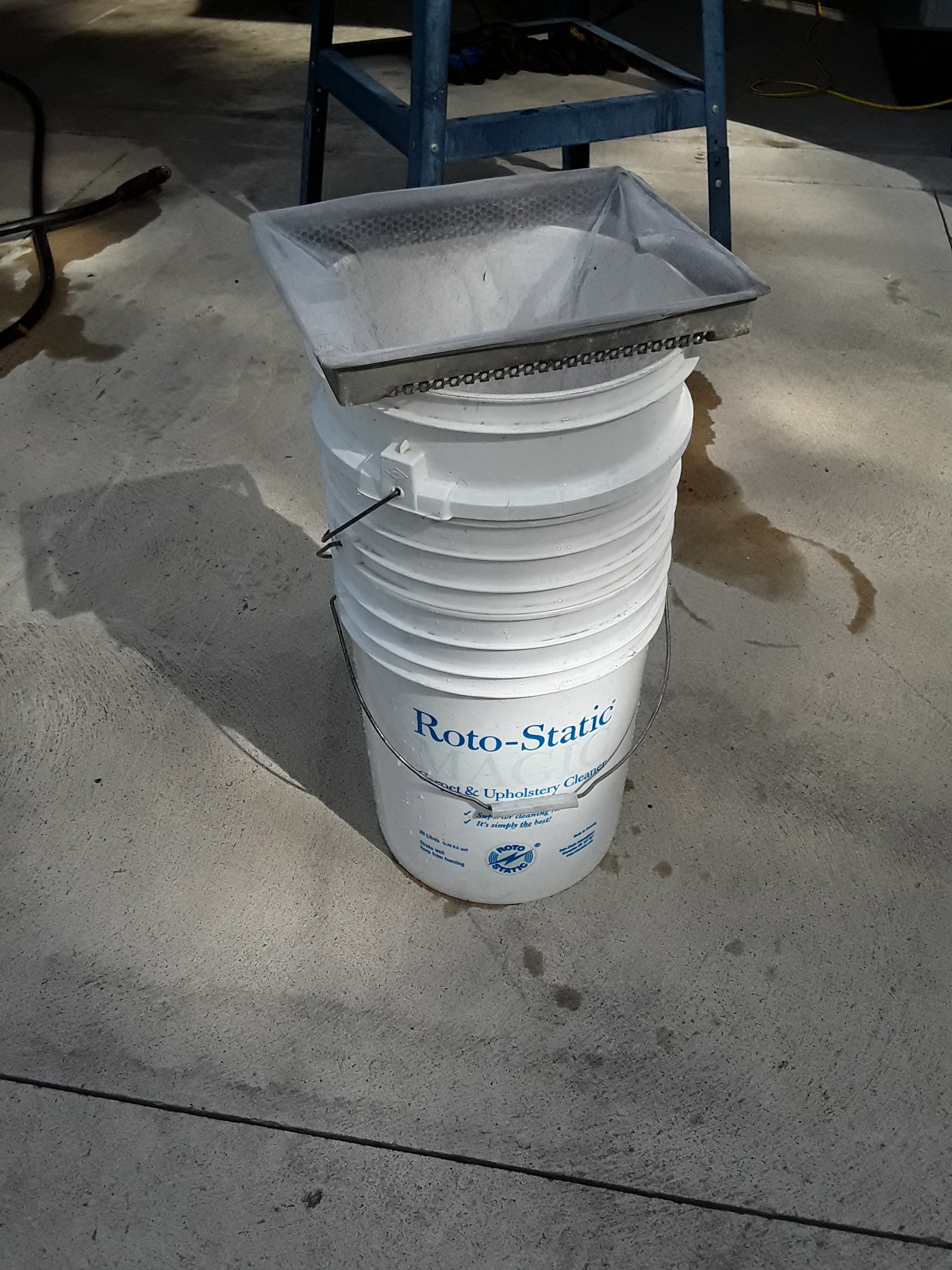

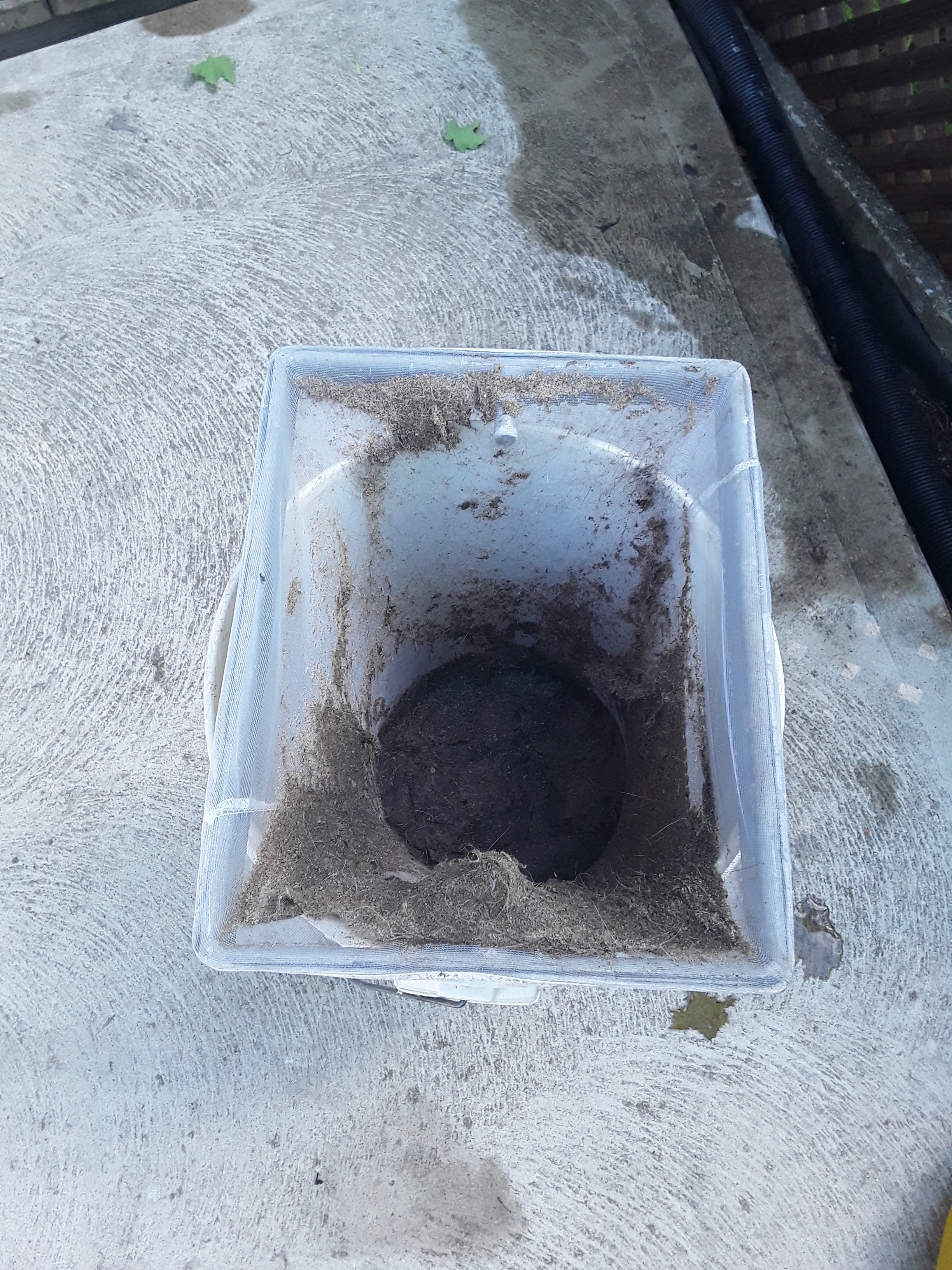

I wash the filters down in the basket and reuse them, sometimes for several or more jobs. All debris is captured and kept in a 5 gallon pail for disposal to landfill. Only a true carpet cleaning afficionado could appreciate what is in those filters!
20180608_160434.jpg 20180901_105009.jpg 20180713_095529.jpg 20180713_095612.jpg

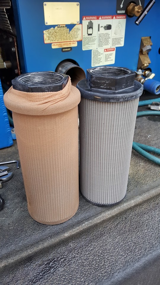

Put a knee-high over your blower filter.....much easier to clean...just pull it off and replace it...it also keeps them in new condition and they last much longer......

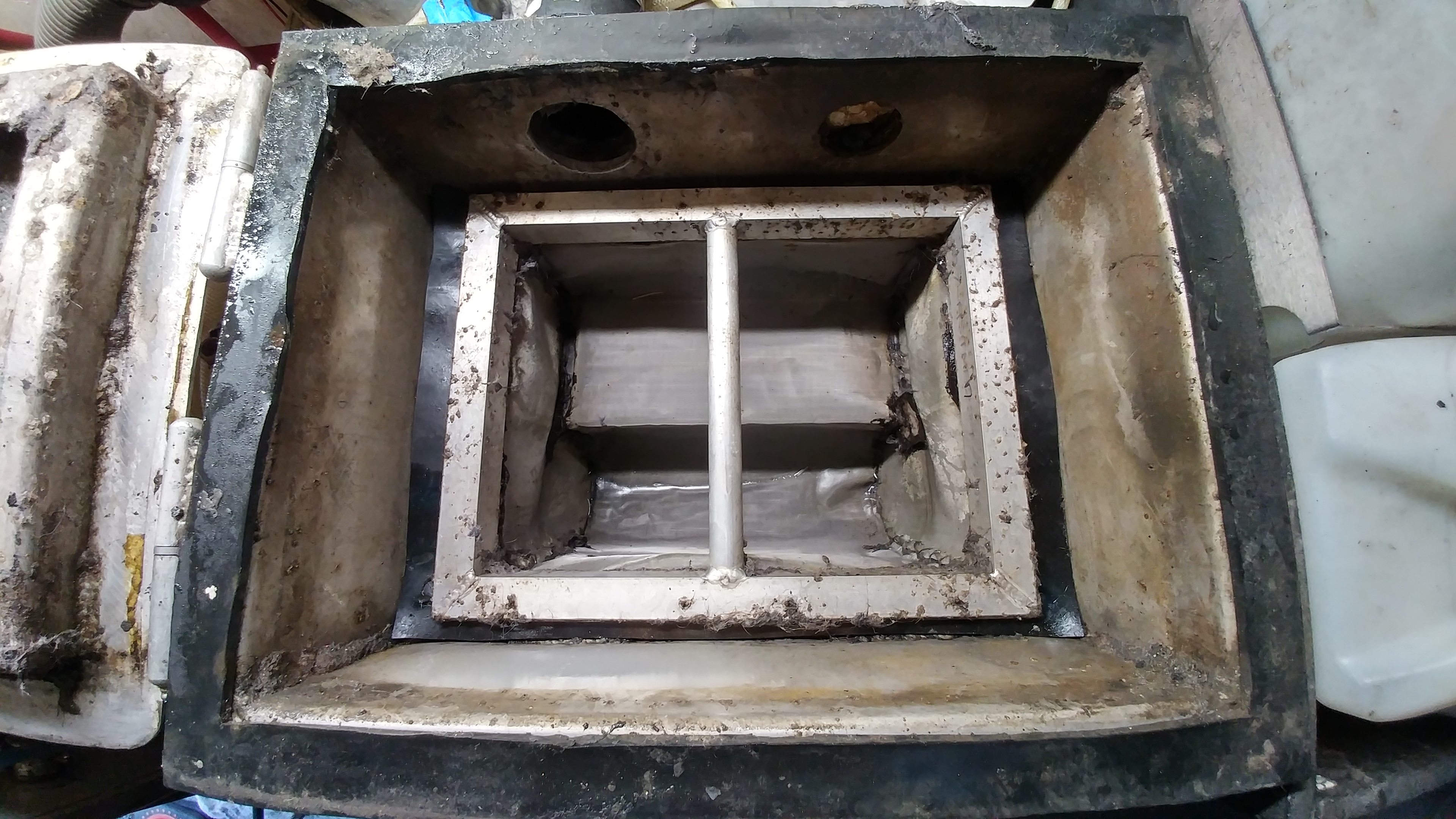

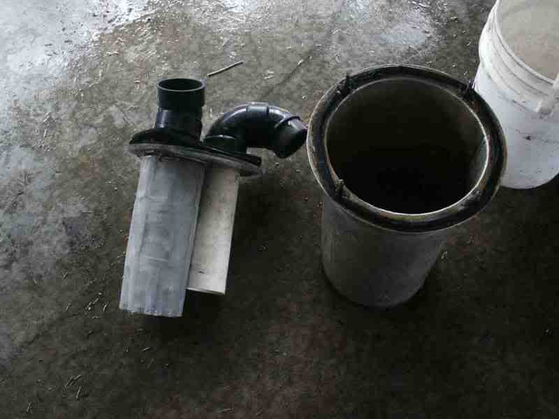

I can't remember what was available back in 08 when I had my tank built. Our regs here require filtering through 80mesh, really fine! before dumping, so either before the tank or after. Surface area is the key, so I had a filter built with more surface area. My truck is plumbed 3" from inlet to exhaust. No blower filter.
Years ago when the pool filters were the "fad", I had a circular filter built. I think the V's were out by then so I was inspired by their tanks. If I need a pre filter I think I'll dig out the tube filter and tweak it. I was surprised I got no pooling in it. I wanted it to pool to help trap soil. Btw, those are 3" ABS on that filter.
